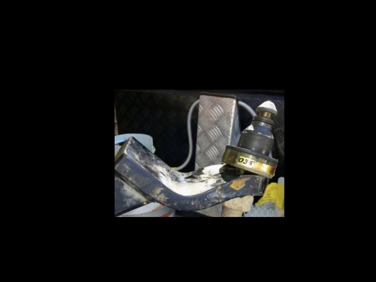

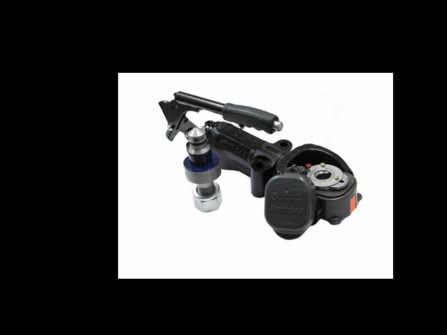

And most importantly, the physics of a DO35 have no effect on towball weight, whereas the McHitch will substantially increase TBW. Cheers.
P.S Sorry about siz e of pictures but poor internet service here.

And are you trying to tell us a trailer can not come unattached with a Do hitch.
If used correctly and the bolt is tight, no!
Once the slide lock is in place on DO35/45 it would not be possible for the hitch to come off mandrel - the mechanism will also retain its hold when car/van is rotated in rollover of either vehicle without torquing the other vehicle into a rollover, being prevented by the unique universal joint.

The DO35/45 Hitch doesn't in itself increase towball weight, unlike McHitch - but it cannot decrease the towball weight.

There are better hitches than the DO35/45. eg the Hitch-Ezy.
Perhaps we should make the Hitch-Ezy compulsory !
Mike, I'm sure that you understand that if a more suitable vehicle is used, there is absolutely no need for a WDH. Many people, and this is from many discussions on my travels, have NO idea what a WDH does, but have one simply because some smooth-talking salesman told them it was needed. Again I will say that in MOST cases a WDH is used only in an effort to make a car do things for which it was not designed. But you already know that, I'm sure? Cheers
From first observations I think the price of it is its major drawback if compared to to same rated D035.
It might have other advantages over the D035 ??
Perhaps Ken would be kind enough to point out the claimed advantages?
Whatever these claimed advantages may be, the fact remains that both units are superior to a McHitch for heavier vans. Cheers
