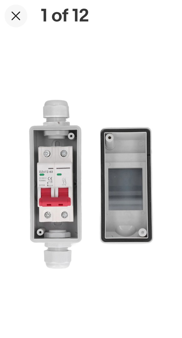

Whilst you are at replacing the batteries, fit a solar disconnect between the panels and the controller. So much easier when working on your system.

There should be a switch before the controller to turn off solar charging.

Yep, that's where the Solar Isolator switch should be. That is much better than throwing blankets over solar panels!

It is also the law. There should be an isolation switch for every connection..
