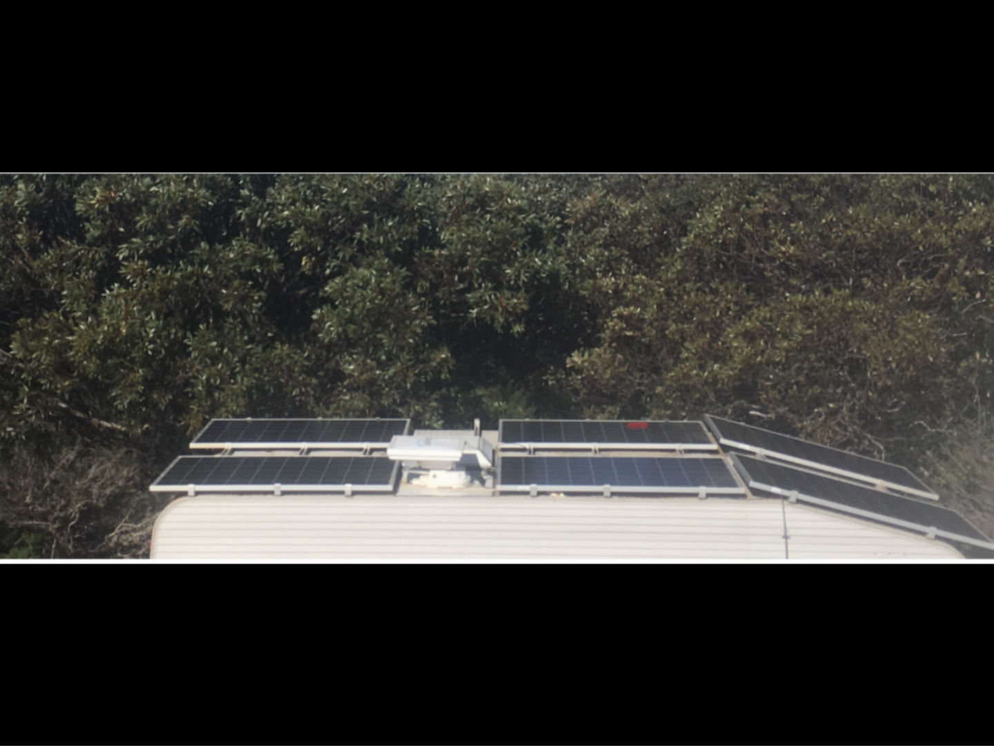

When I started a few years ago I didn't have a clue on anything solar. So I bought what I felt was the best. I just couldn't be bothered with a list of unknowns. I have better things to do than waste time on third rate products. Let's be honest a lot of them simply lie about their performance.
I also have built in redundancy so if something fails while remote the fridge will still work.

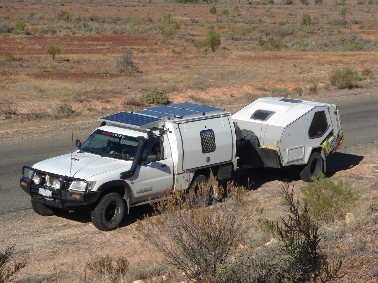

True ........... unless like us you tow & have the panels on the tow vehicle, which we connect to our camper via a 10 metre 6B&S 'umbilical cord' which enables us (most of the time) to camp in shade when desirable, whilst panels are out in the sun.
Although that said we had fixed panels on the roof of our bus, with a good air gap below them, plus heat reflecting paint on the roof & good cross ventilation airflow in the bus, & it was on average 3 degrees cooler inside the bus than outside - still hot in hot weather but quite manageable. Two roof hatches (one with a bi-directional fan) worked very well.

There is no doubt you van get more out of your panels & into your batteries if you are prepared to be around & willing to move them every hour or so throughout the day, in addition to the often heavy & cumbersome unpacking/setting up/packing away routine.
To my way of thinking this practice suits folk who rarely leave their camp, & who camp in places for at least a week or two at a time. Also folk who lack 'real estate' on their van or vehicle roof for permanent mounting.
Our first vehicle with solar had plenty of roof space so 'loose' panels were never a consideration.For a while on our current vehicle we had our roof full with a roof top tent so panels had to be 'loose'
I'd have to say that the practice of getting them out, packing away & moving them to catch the sun multiple times a day quickly wore pretty thin.
When we realised that actually we (I) hated rooftop tent living & took it off (& towed a camper instead) it was a relief to attach the solar panels to the roof. They are always there doing their job with no further thought required. & they can be left doing their job if you go for a walk or leave camp.without fear they will be stolen because they are bolted down.
The disadvantage is that panels laying flat (or close to flat) will not put out as much power as those angled always toward the sun. I use an old & well used formula (Courtesy of Collyn Rivers) to determine output & thus how much solar I need. For 12v panels divide the panel's rated wattage x 12 to get the max output in amps, & then multiply it by 70% to account for laying flat. Eg. 120w panel will theoretically put out around 10 amps (120 divided 12) but laid flat on a roof multiply 10 by 70% & you get 7amps. So you can see that if using fixed panels you will need more panels to do the same job (which is fine provided you have the roof space on top of vehicle/van.
If you have a caravan I cannot understand why you would even consider messing around with portable panels. As well as risking having said panels "borrowed" by some low life, there also is the hassle of regularly having to move them, as well as packing and storing them for travel. "No room on roof" is unlikely to stand scrutiny as evidenced by my design. As well as 1650 watts Solar (6x275 watts) I have a Sat TV and a 4 seasons hatch, and still there is plenty of spare room. Previously I had 9x190 watt panels but when a couple got smashed by rocks and replacements could not be sourced I gave the remaining 7 panels to an installer in return for fitting the new ones. Parking in the sun is not a problem as the panels are 4" off the roof so that they can breathe, and also prevent the sun shining directly onto the van's roof. On really hot days I simply leave the AC running. Cheers
