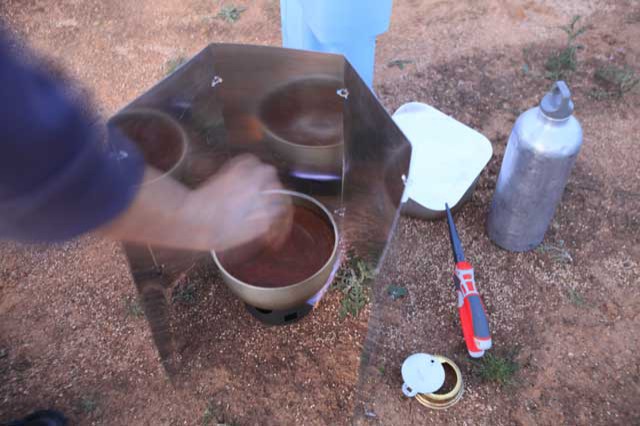

Metho stove & a few drops of water to prevent sooting, then in the Aeropress with stainless steel filter.

We only live out of a car. So no room for gas, we use a metho cooker. We also hand grind coffee beans for really nice coffee. Wouldn't touch preground coffee with a barge pole.
P.S. Just grinding your own beans in the outback is worth the envious looks alone.

how do u make yr coffee moka pot?
