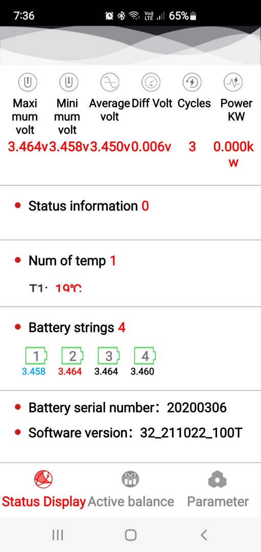

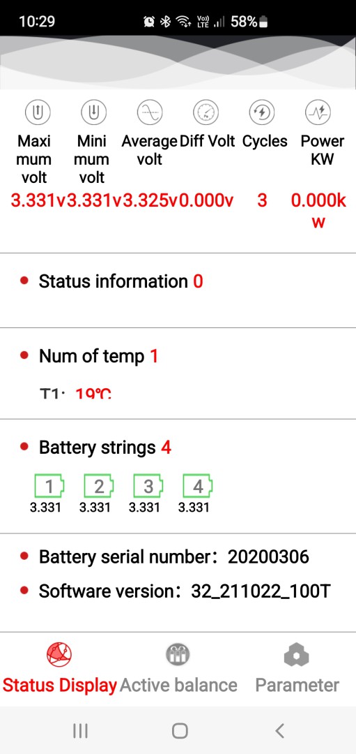

TimTim said
03:04 PM Sep 26, 2022
Hi John,
Well those voltages sound great and given the length of time that your battery was what we though was fully discharged then it should well and truely be dead by now. My thoughts are that the BMS was actually in sleep mode and protecting the battery so what you were seeing was a vastly lower voltage through the BMS. In other words the battery voltage was never as low as you thought it was.
Test the battery by placing a load on for a while.
The BMS will not have been damaged so all good there but the only other way that you can check anything is if the BMS has Bluetooth that connects to an App on your phone. Otherwise you are good to go.
Some images of my cell voltages after I have top balanced the cells.
