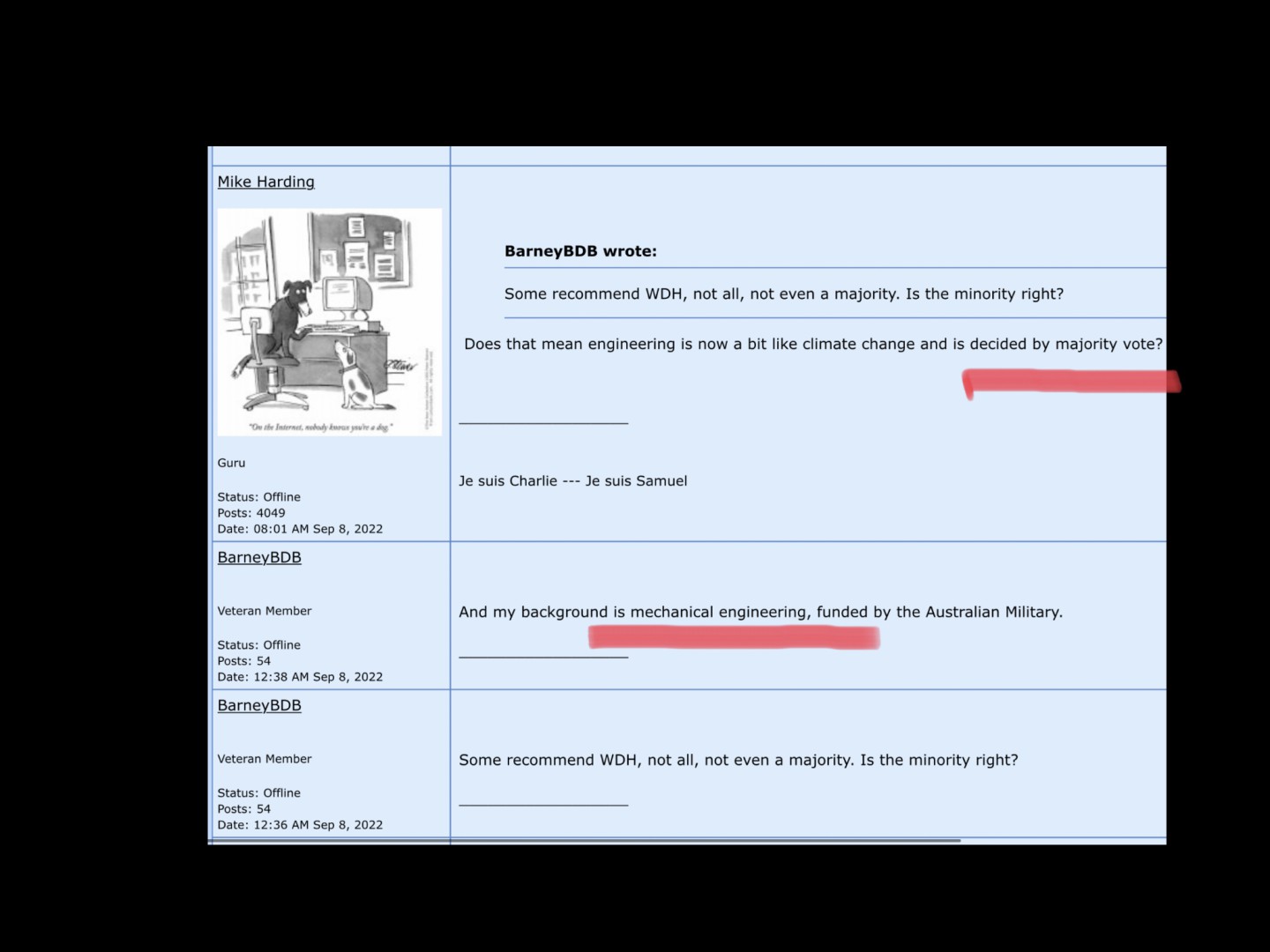

Some recommend WDH, not all, not even a majority. Is the minority right?
BarneyBDB said
12:38 AM Sep 8, 2022
And my background is mechanical engineering, funded by the Australian Military.
Mike Harding said
08:01 AM Sep 8, 2022
Does that mean engineering is now a bit like climate change and is decided by majority vote?

Thanks, Barney and Craig, for your support. Unfortunately, logic and common sense apparently are foreign to some. Ivan, could I ask you to read the post below, where I explained how using a WDH would be sensible and acceptable in this situation? BIG difference from trying to make some inferior vehicle do things fir which it never was designed. Cgeers
I found the van towed very well, no problems what so ever. The van has ESC and so does the MUX tug. We have since done Adelaide to Darwin and return via the East coast and now in Albany, WA, heading clockwise. Not sure whether I will sell the WDH for scrap value when I get home again or post it on here for it's perceived value.
What are you towing a 8' x 5' trailer, a WDH would benefit a lightweight MUX towing anything over 2 ton.
Cheers Bob
I also hold a truck licence and used to have a road train endorsement.
If some of you feel you need a security blanket, that is your choice. What some of us are asking is if your choices are based on reality, perception, or I read it somewhere on the internet?
During my time towing I have experienced things that I really did not want to so I am confident in my assessment of the current rig not needing any further help.
