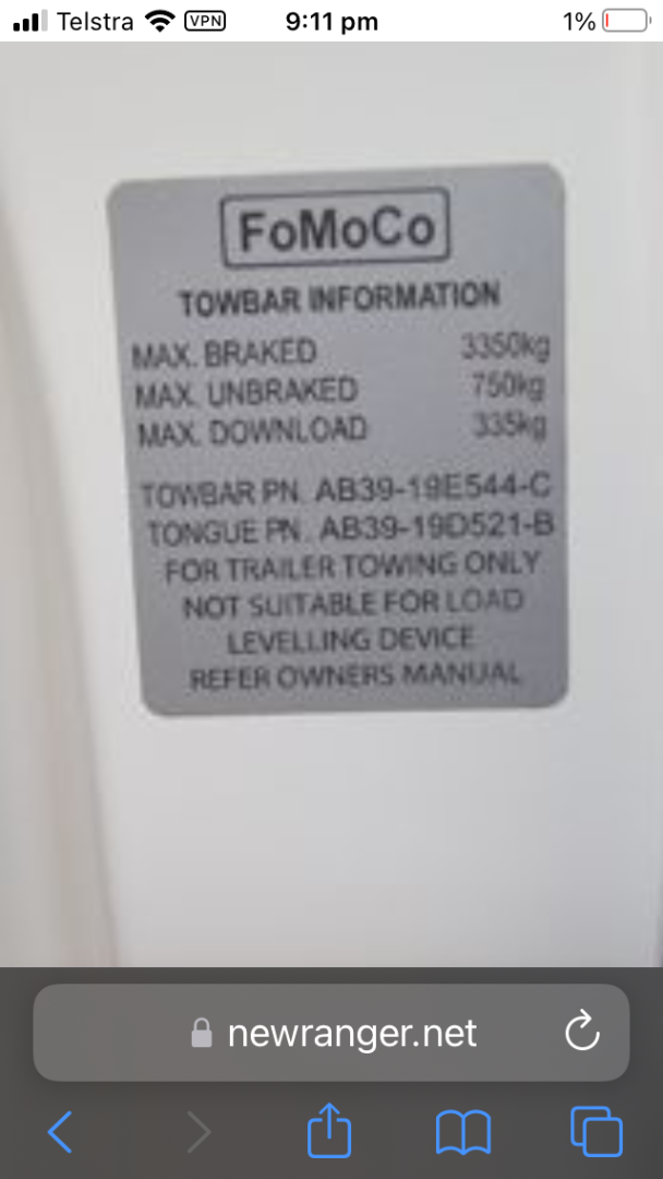

Bukhouse said
09:40 PM Aug 19, 2022
Hi when i had the Landcruiser it had a Hayman reese towbar rated 3500kg and I used the WDH on the van
The Ford Ranger has a Ford towbar rated to 3200kg and there's a sticker on the drivers side door pillar
that states not to be used with WDH device
So I think Ill get the Ford towbar changed out to the Reese bar and run with the WDH
the last time I had it weighed the van came in at 2.7 tonne loaded so I had to shed some off the wifes stuff lol

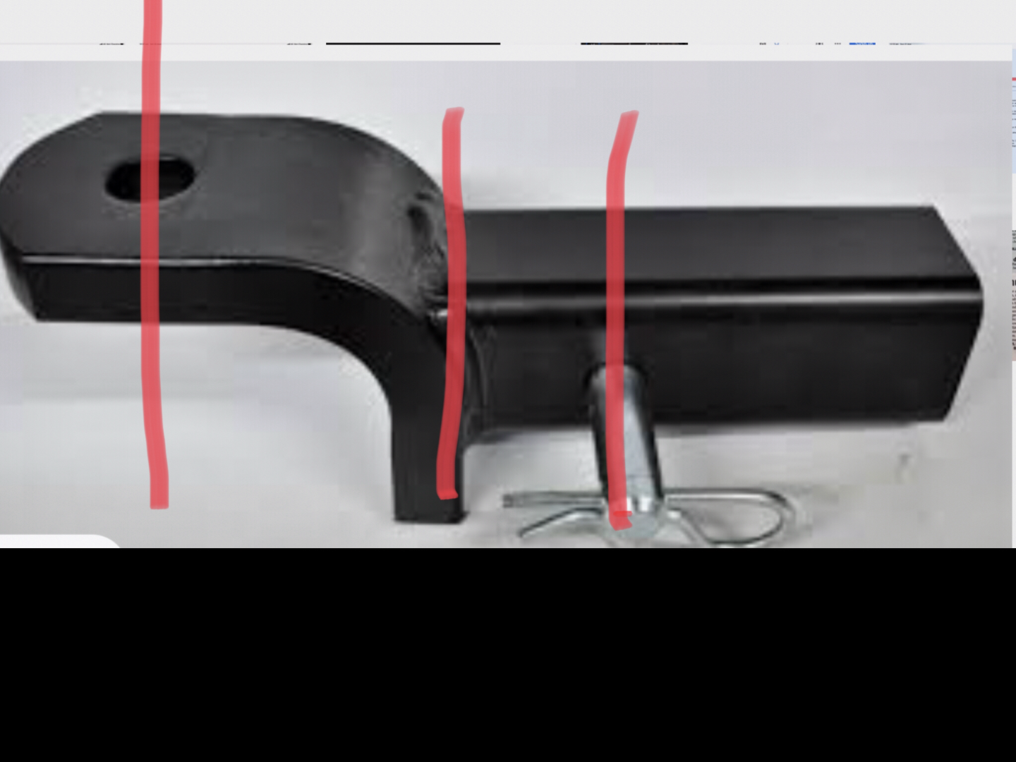

Are We Lost said
10:43 PM Aug 19, 2022
The PX2 towbar as factory installed has a very short receiver which abuts the main towbar crossmember. You may also have this same "feature". From memory, the HR receiver is open at both ends, so a much better solution. Worth checking when you are are getting the new one. Also, take along the WDH shank to make sure the hole position suits and maybe you can get some cut off if needed to reduce the towball overhang ... beneficial in reducing rear axle load and resistance to sway.

P.S For a start I'll post this photo of a shank. Anybody who believes that a WDH shank and the associated tow head adds only 50mm to the distance from the end of the receiver to the ball is delusional. Cheers

This is becoming interesting! It would take a lot of "creative" measuring to convince yourselves that a WDH increase TBO by only 50mm, but I have started compiling a response. Stephen's theory is flawed too, as weight on the rear axle tends to limit yaw, but today is beer-drinking day so I cannot apply the concentration needed to respond. Maybe by tomorrow we'll have further interesting comments, along with perhaps more sheep-like "+1s" from those who seem to have nothing of substance to add. Cheers
