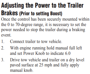

In this instance I was towing with a BF Falcon fitted with Tekonsha Primus brake controller
After several hours of towing I experienced a disturbing brake fade. There was no traffic around but I had recently experienced a circumstance where I'd braked hard.
Seeing the mechanic the next day he found the brake fluid was >4% hydroscopic which could explain the vapour in the brake lines causing the fade. He bled and replaced the brake fluid. Still I was concerned as to why the fluid had gotten so hot. This was a new van and our maiden voyage.
The new van is smaller than our old. It is an Avan Cruiseliner around 1100kg. But here's the thing. When I was attempting to calibrate the brake controller I was not able to make the van brakes lockup by setting the gain to max (unlike our old Jayco Expanda). Instead I could feel a steady reassuring pull coming from the van brakes when triggered manually (lever on the brake controller) that brought the entire rig to rest comfortable (and without using the tug brakes). I had assumed this was normal and satisfactory.
So my question is, does this suggest that the van brakes need adjusting such that should I be running through the Tekonsha procedure I am ABLE to lock up the wheels? Then back off the brake controller gain a notch or two? This would mean that I have maximum braking capacity through the van without it locking up. Also means the tug is doing less work and brakes / brake fluid won't get so hot.
It is all a bit hard to explain in this forum post but hopefully the post below with the controller and brake adjustment should help clarify what I am trying to put into words.

Really my main question is summarised in point 5. And I am leaning towards yes the brakes need to be adjusted to make up for some brake shoe wear. Thereby making them more sensitive and able to be locked up when the gain is set too high (and subsequently backed off to the point where they don't lockup). This is how the manual says it should be done and is how I previously calibrated the brake controller gain for my previous van.
So who has adjusted their own brakes as per this YouTube video?
https://www.youtube.com/watch?v=3cOyJ9ELoxg
-- Edited by Elecmuso on Wednesday 3rd of August 2022 12:07:00 AM
Elecmuso said
11:46 PM Aug 2, 2022
Just to be clear this video shows the model of brake controller that I have and how to set the gain.
https://www.youtube.com/watch?v=x-MkpQRUz1M
-- Edited by Elecmuso on Wednesday 3rd of August 2022 12:00:10 AM

That video is not of the Tekonsha P3 proportional brake controller that you stated you have 9 postings above!
Elecmuso said
03:44 PM Aug 3, 2022
I never said a Tekonsha P3. Gundog did (and somehow misquoted me). Have a look at MY posts - they all mention the Primus model (except the one where I quote Gundog).
Hence why I posted the YouTube link. To make it clear!

On mine . I adjust using tug brakes . Add % till I feel brakes working better ! Mine has an inertia setting also . So it works a little with deceleration

To answer your question, I always adjust my van brakes as per the video, can't say that I wind them in 8 notches , I adjust so there is no contact of drum and pad when spinning several times. Never had any issues with brake operation.
