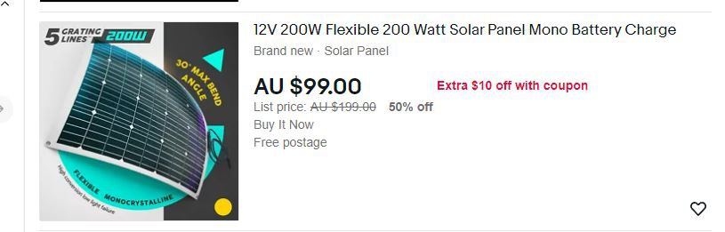

Are these panels any good? Efficient? Only 1.4kg I want something light weight to plug into my van Anderson plug. Anderson plug goes direct to the 120Ah AGM & the controller is just a cheapo.
I don't think they will produce 200W, the photocell area of my 200W five year old ex house panels is 1.2sqm, these have an area of 0.66sqm.
05:39 AM Jun 6, 2022
So that works out at 303 watts per square metre. Ridiculous!
150 watts per square metre if you are lucky out of flexible panels. So x 0.66m² = 99 watts would be a more realistic figure.
oldbloke said
08:54 AM Jun 6, 2022
Yeh, seemed a lot.
But 100 watt would perhaps be enough, size and weight is ok.
I'll give it some thought. The blanket type aren't cheap and from what I understand not very efficient.
TimTim said
09:26 AM Jun 6, 2022
oldbloke wrote:
Yeh, seemed a lot.
I would avoid those EBay lightweight panels.
I bought a couple of Kings 160W semiflexible panels a few years back for testing and they give a good output but of course not 100% and I expected that. I cant remember the figures but I bought one for testing and was impressed so I promptly went back and bought another. They have since been damaged with a car running over them but are still going. If I get some sun today I will run another test. Kings also do a 110w semiflexible which I will buy and test next week.
I just bought and tested a BCF XTM 200W solar blanket and angled to sun it produced 8.84A as opposed to the stated 11.02A. Laying flat with sun at 35 degree altitude it produced 5.74A. With the product having the largest area of a number of solar blankets i guess I expected more out of it.

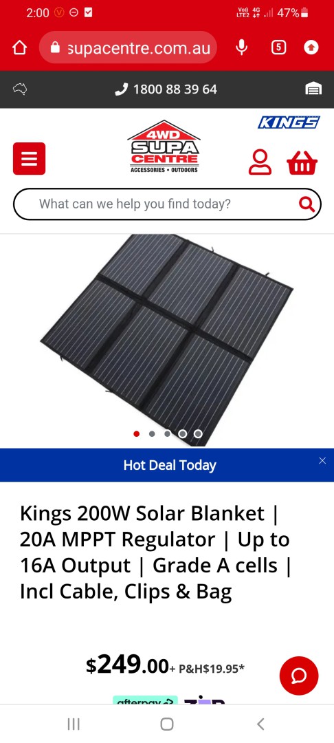

oldbloke said
02:03 PM Jun 15, 2022
These are available at the moment across the road from where we are staying.
$300 here but might do a deal?
We have 8 weeks of our trip left so should just about pay for its self.
BUT, how do people prop them up at an angle?
Any good?
-- Edited by oldbloke on Wednesday 15th of June 2022 02:05:07 PM
-- Edited by oldbloke on Wednesday 15th of June 2022 02:55:44 PM
If you notice they say up to 16A and that will be to cover themselves when it doesnt produce anywhere near that.
The test on the XTM blanket from BCF only produced 8.77A when angled to the sun and 5.74A when laid flat and that had a larger area than the Kings. The Kings does have a MPPT controller so that will increase the current a bit more than the cheap PWM controller I used.
Probably the best way to use it is to have one set of panels flat and prop the other up with water containers or similar items. Or even even using sticks to the canvas loops to prop it. The blanket is cheaper here.
I bought and tested one of the semi-flexible 110W panels and think they are in ways better than the solar blanket as two of them propped up will produce more, are lighter and are easy to prop up against something. See my previous post where it produced 5.63A.
Interesting. Anywhere from $229 to $300. The 200w kings blanket will sit on the back seat of the ute, so that helps. But proving it up at an angle seems problematic. Sounds like broom handles might be the go.
Might see if I can negotiate the price down a bit.
-- Edited by oldbloke on Wednesday 15th of June 2022 09:16:36 PM

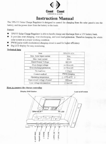

09:29 PM Jun 15, 2022
oldbloke wrote:
Can't be much of a MPPT controller, my Victron 100/20 cost about $250
https://www.ebay.com.au/itm/124058054594?hash=item1ce26fafc2:g:e9oAAOSwk8hhOs-r&frcectupt=true
Currently have 150w on the roof.
-- Edited by oldbloke on Sunday 5th of June 2022 10:35:38 PM
-- Edited by oldbloke on Sunday 5th of June 2022 11:23:54 PM

In this case I had the battery connected right next to the panel with just the PWM controller in between.
I have a 12AWG 10 metre cable and previously did a comparison on some panels some time ago against a 10 metre 8AWG cable. If I remember correctly there was only something like a 0.1V difference between the two cables but to be honest it was just a quick look to see what difference there was.
When I get all my equipment back I will take a closer look using a MPPT controller. 8AWG wouldn't fit in the terminals of the cheap PWM controller in any case and it looks like 10 AWG is the maximum.
Any good?
https://www.4wdsupacentre.com.au/adventure-kings-200w-solar-blanket-with-mppt.html
https://www.4wdsupacentre.com.au/kings-110w-semi-flexible-solar-panel-etfe-construction-monocrystalline-cells-ip67-rated.html
$229 to $300.
