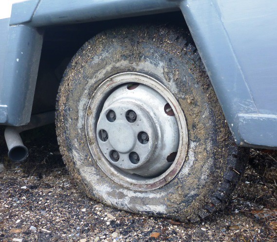

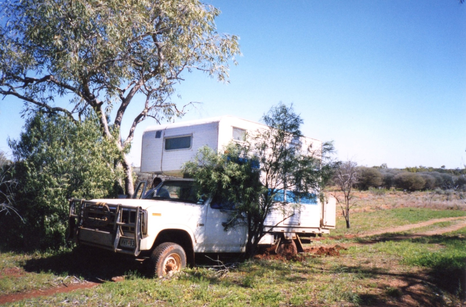

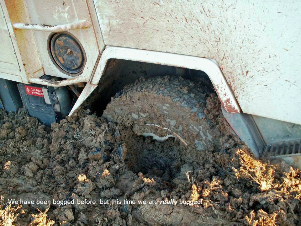

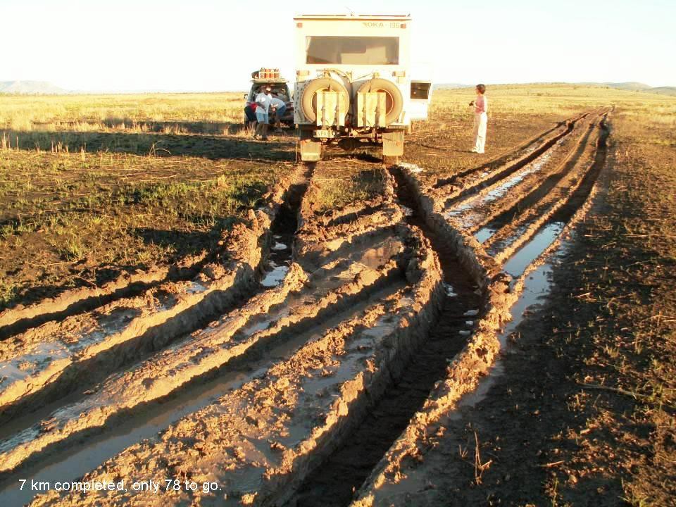

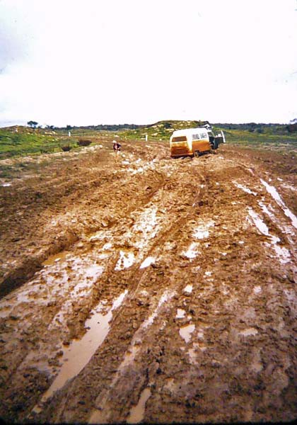

Peter_n_Margaret said
09:55 AM Apr 27, 2022
Letting LOTS of air out is almost always the best action. Cheers, Peter
..if the loads is spread out (distributed) over all of the axles more evenly because you are using a WDH. Wouldn't it be less likely that your axles would sink into the mud?
I dont have a WDH so have never before wondered about the effect in muddy conditions.
Using or winding the tension up, on a WDH, would cause the front axle to sink deeper into the mud and create additional resistance to be overcome by the driving axle which now struggles more with reduced traction. Thats in the case of a rear wheel drive vehicle. Front wheel drive might just get a tiny bit more traction on the drive axle wheels. Might just be smarter to drop tyre pressures, a lot, and engage 4WD before entering the muddy conditions. Once the drive wheels start spinning, you are likely looking at a recovery situation that fiddling with WDH settings will not affect.
There are muddy conditions and there are muddy conditions. Black soil plus a couple of mm of rain and you will go nowhere. I recall an incident at the river camp at Longreach when a few numpties ignored the signs and parked off the designated parking area before a couple of light showers. They had to be dragged out by a Council supplied road grader.

Remember the old VW beach buggies...they'd go almost anywhere with just rear wheel drive as the weight was over the drive, and the front end was quite light therefore didn't bog in as much...
Good point Dean, perhaps understood by few. Unless a "4WD" vehicle is fitted with diff locks, it will only actually be 2wd, driving only one wheel on each axle at any one time. Similarly, a 2wd vehicle will be only 1wd, driving one wheel on the drive axle. Some year ago I worked in cotton-country around Gurley, NSW, and when I arrived in my F100 351V8 with its limited slip diff all the local cowboys, driving their Patrols and Cruisers, laughed at me, asking me where I thought I was going in my F100. However, after lots of rain, my car was the only vehicle able to deliver us to the local pub, with the Patrols and Cruisers dropping both wheels on one side into one of the many ruts, leaving the other two wheels on the high,unweighted, side spinning hopelessly. Much fun was had rescuing these cars! Few understand how a 4wd works, evidenced some years ago when I was visiting my father who lived on the beach front in NSW. We were enjoying an ale when there was a knock on the door, a couple of chaps asking for help as they were stuck on the beach. These chaps had each recently bought a 4wd and had decided to try them on the beach. As soon as we saw the cars, we knew what was wrong .. they hadn't engaged the front hubs, and the cars were sitting down at the rear. "Derr, we put it in 4wd" they both said, showing us the range selection gear lever. Cheers
