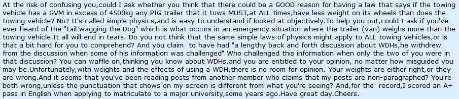

At the risk of confusing you,could I ask whether you think that there could be a GOOD reason for having a law that says if the towing vehicle has a GVM in excess of 4500kg any PIG trailer that it tows MUST,at ALL times,have less weight on its wheels than does the towing vehicle? No? It's called simple physics,and is easy to understand if looked at objectively.To help you out,could I ask if you've ever heard of the "tail wagging the Dog" which is what occurs in an emergency situation where the trailer (van) weighs more than the towing vehicle.It all will end in tears. Do you not think that the same simple laws of physics might apply to ALL towing vehicles,or is that a bit hard for you to comprehend? And you claim to have had "a lengthy back and forth discussion about WDHs,he withdrew from the discussion when some of his information was challenged" Who challenged this information when only the two of you were in that discussion? You can waffle on,thinking you know about WDHs,and you are entitled to your opinion, no matter how misguided you may be.Unfortunately,with weights and the effects of using a WDH,there is no room for opinion. Your weights are either right,or they are wrong.And it seems that you've been reading posts from another member who claims that my posts are non-paragraphed? You're both wrong,unless the punctuation that shows on my screen is different from what you're seeing? And,for the record,I scored an A+ pass in English when applying to matriculate to a major university,some years ago.Have great day.Cheers.

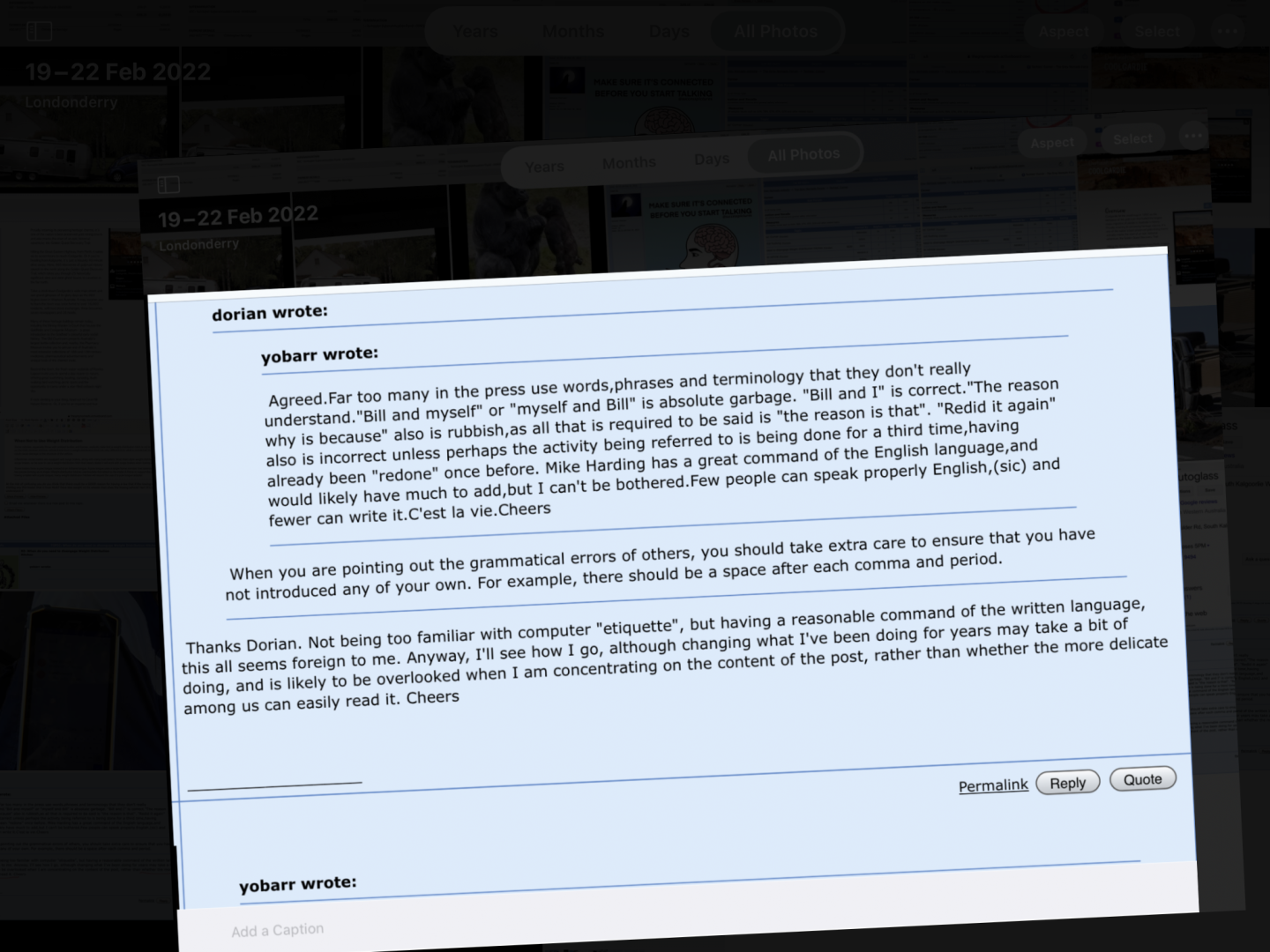

And it seems that you've been reading posts from another member who claims that my posts are non-paragraphed? You're both wrong,unless the punctuation that shows on my screen is different from what you're seeing? .......
This is what I see (I pasted an image) .... not very easy to read. Perhaps you should look at double spacing between paragraphs. You can probably configure your device to put a space after commas and full stops as well. All help readability.

Yobars text is no different to everyone else's on my device (mobile phone) ,perhaps you need to check the settings in your device.
As you would know from previous posts I am a strong proponent of WDHs in most cases when towing heavy vans. Suspension modifications that do nothing to redestribute weight back to the front wheels mean less tyre grip at the front, and more tyre grip at the back ... an unhealthy handling situation.
Yobarr is very aware of how his text is lacking spaces and paragraphs. He has seen many lmages such as above and asked to include paragraphs and spaces many times. IMO it's intentional.
A quick check in HTML format, I see no paragraph marks but do in Gundog's post. The same when I paste into Word. Rather than digress this thread further I will raise it as a separate subject in the next couple of days.
Thats because it's intentional. So don't bother. Yobarr will continue to post with no spaces or paragraphs. It must be intentional. Which I find interesting because he claims to be an "A" English student. I can only assume it is to annoy, or agitate members. There is no other explanation.
