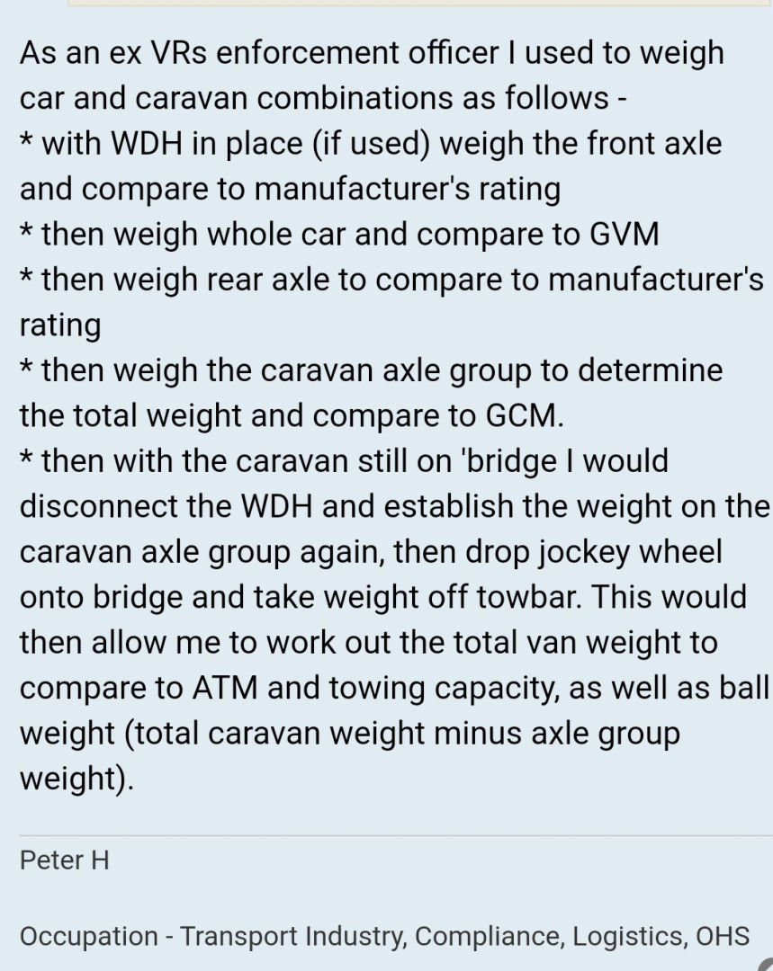

What they should have focused on is measuring the actual weights before and after WDH setup. In real life the correct way to go about it would be to fully load both van and tow vehicle as if for travel and take it to a weighbridge. Then it will be clear how much weight is on each axle. The greater the difference front to back, the more the road grip differs.
Measuring the actual weights is the only sensible way to find what effect the WDH has had,but even that can present problems because of the weighbridge increments.

I think most would agree that you should weigh once you are loaded and set up to confirm all is well. They are talking about the initial "set up" after all.

Perhaps if you can, print out the form I uploaded to note the weights at the weigh bridge with pen and paper. It may help.
Attached from another forum. How to weigh the rig.
