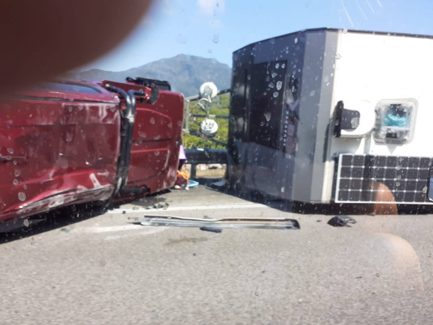

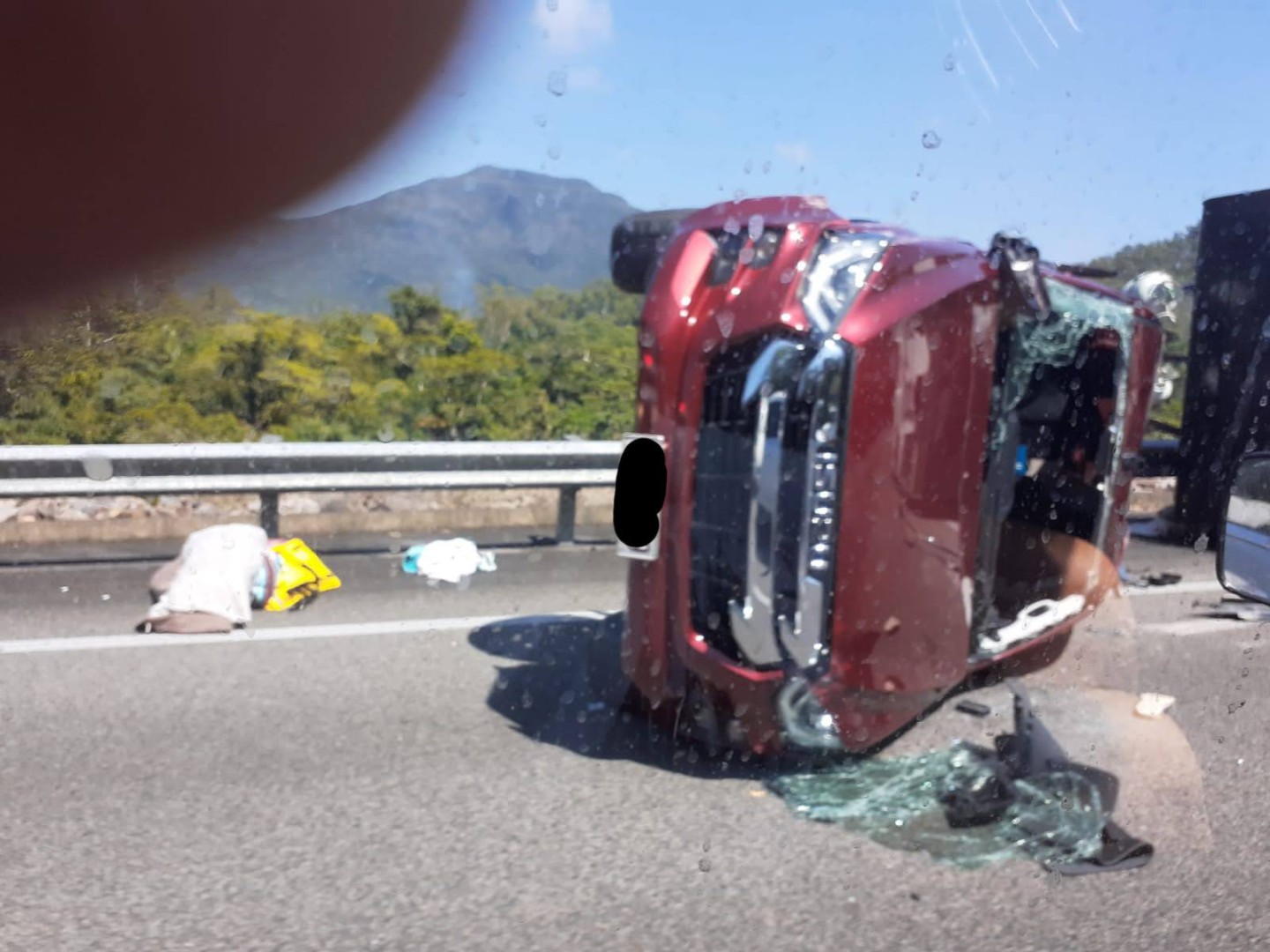

Hi in October I posted pictures of a Isuzu towing a caravan, that had rolled over going down the Cardwell range. It was not a pretty sight. I can't post a link to the photos now from my phone. Someone else might be able to. Cheers Stewart
Probably not what you're referring to,but this happened on the Kuranda Range and perhaps shows why you shouldn't tow heavy vans with little cars.If safety is of any concern,always the weight on the car's wheels should be at least 10% greater than the weight on the van's wheels.Cheers

Stewart said
04:16 PM Jan 9, 2022
Hi
Here is the Puictures qwe took on the Cardwell Range in October

Hmmm.Don't know how Jayco can suggest a MAXIMUM ball weight that is only around 7% of ATM when the generally accepted figure for safe towing is 10%.The towball weight at tare is established by simply deducting the GTM from the ATM and means nothing,but having an axle capacity of 3333kg,and loading to that figure,leaves towball weight of only 42kg? Montie,our resident RV dealer who knows all about weights after many years in the industry may be able to offer advice.Good luck.Cheers
Hi
Blocked the highway for several hours
Cheers stewart
