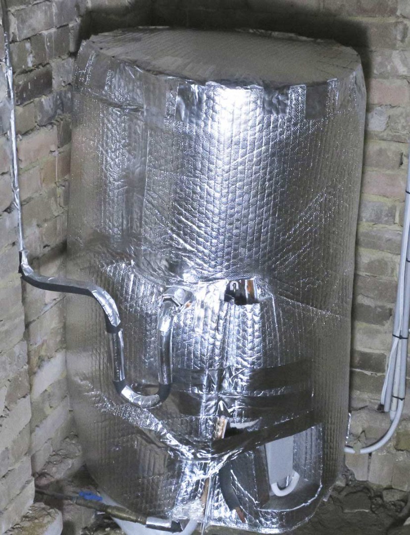

02:11 PM May 2, 2021
Our 80L hot water has a heat loss of 1.67kWh/24h Australia standard 1.7kWh/24h.
With a layer of Aircell + R4 polybatts (2 layers on top) + an outer layer of Aircell. The tank's heat loss is 0.95kWh/24h.

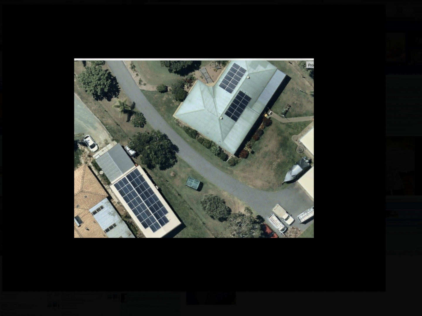

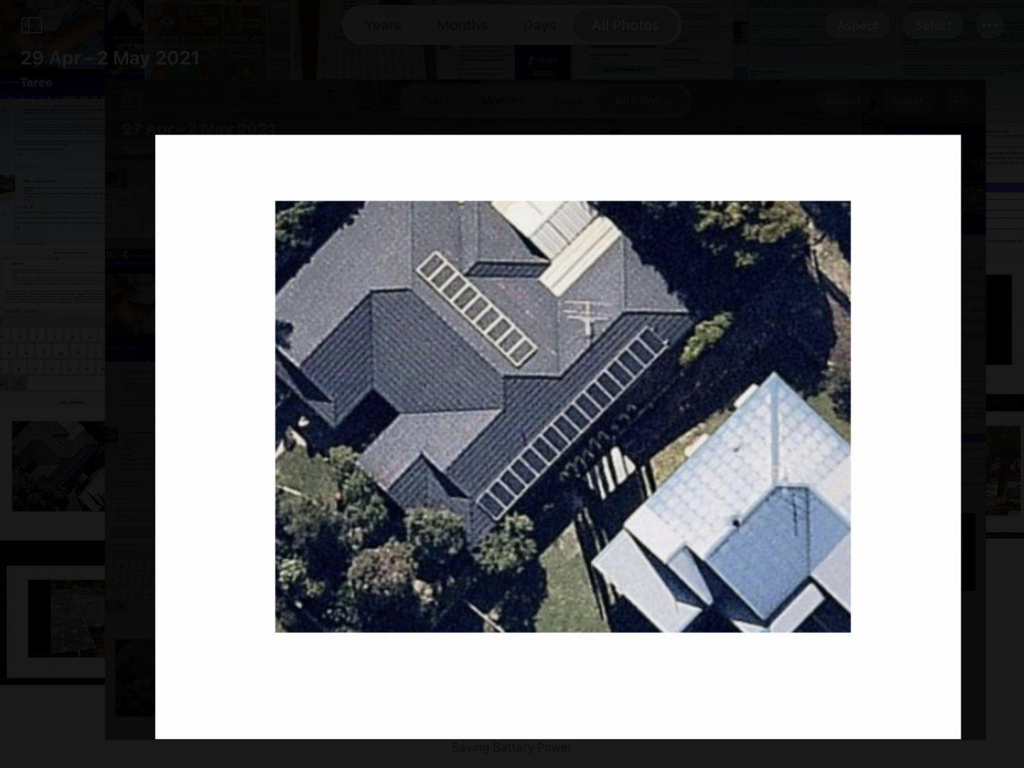

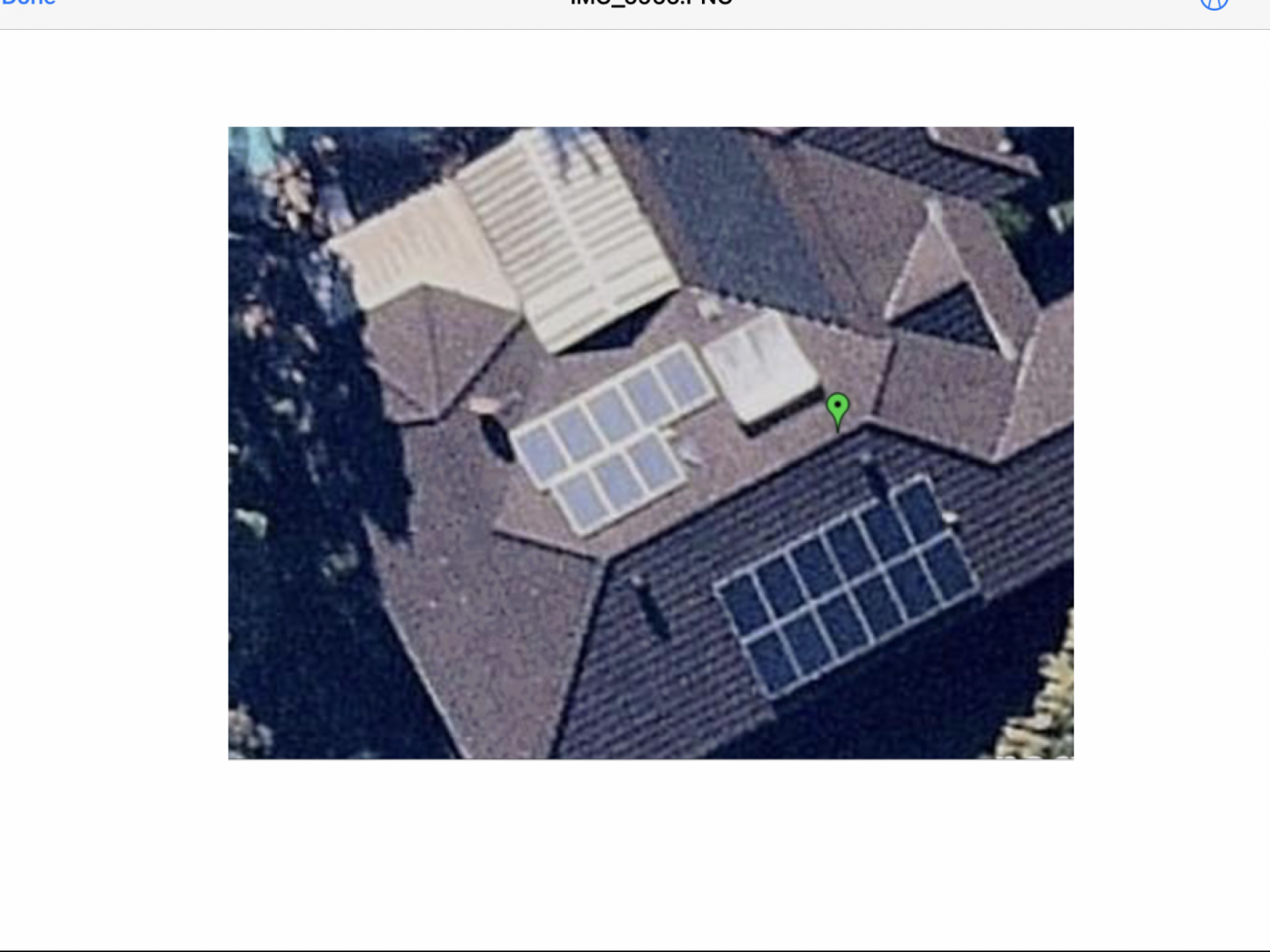

iana said
04:16 PM May 2, 2021
Yobarr for your comment.
As with the posted pictures, what is wrong with the 1st installation?, the third is clearly hail damage.
-- Edited by iana on Sunday 2nd of May 2021 04:19:30 PM
Whenarewethere, your hot water cylinder looks warm and cosy. But yes its all about restricting energy loss.

yobarr said
08:25 AM May 3, 2021
Massive losses from panels facing South East when there is a mile of room North West.The reason for this was simply laziness,and cost cutting.Tge meterbox on this house is in the South West corner,so the installers have saved much cabling,and time,by putting the panels South West.These are the things that give Solar a bad name.The second was a fire caused by cheap isolators,and the hail damage is a result of cheap panels being used. Solar is a complicated business,but unfortunately many in the industry have little idea.The stories I could tell about dodgey Solar installers,and their installations would,take me hours to tell.The biggest problem is 'price chasers' as well as those who say 'I've done my research.I know stuff'.In actual fact,they wouldn't know spit from clay about Solar,but to save face,they go ahead and buy El Cheapo.Graeme's comment about only 5kw per phase is not quite right,but few understand that either.There are many 10kw systems on single phaseyou just need to know how to do it,and many installers have no clue.Please can I stress that this is not a criticism of Graeme's comment,as he is obviously a highly experienced Electrician.Just for the sake of it,I have included more photos of 'Dodgey Bros' installations.Unconscionable conduct comes to mind.Cheers
The biggest savings from solar installations on domestic residences comes from the reduction of use of power from the grid. This becomes more relevant as feed in tariffs reduce.
Solar panels are now so cheap that it is a small imposition to install extra panels (without necessarily installing a larger inverter/controller).
North facing panels will collect most energy on a given day, but do not necessarily collect it efficiently when much of that energy is being used ie... first thing in the morning and last thing in the afternoon so it can make financial sense to face a significant number of panels towards the east and a significant number towards the west to accommodate those needs better.
It is not the total power collection over the day that becomes important, but when it is collected and when it is used.
If you have some sort of power storage, the optimum arrangement may well be different, but existing battery technology will never be a mainstay energy storage system in my view. They are too expensive and need replacement too often to make them viable unless you can be completely off grid, which will not be permitted in the areas currently serviced by the grid.

Great results Hans,as you have installed a decent sized system.The two big mistakes that people make with Solar are that they buy on price,which is guaranteed to end in tears,and they install a system that is waaay too small because they don't want to spend money.False economy,as a 6kw system becomes cash-flow positive from day one,if a loan is taken out,and you also are protected from price rises.It must be noted,too,that the rebate (STCs) is only available once for each property,so that when people finally realise they've been conned,and want to install a good system,they must pay full price. Many times I have seen a good quality 6kw system making 3 times as much yes,3 times as much as a poor quality 6kw system on a neighbour's house.Same day,same aspect,same conditions.Return on investment is upward of 25% in the first year,and gets better as prices of power rise.Solar is a no-brainer.Cheers.
-- Edited by yobarr on Sunday 2nd of May 2021 07:58:50 PM
Hot water power usage is minimal,and if the HW is put on the back of the T11 meter,with an HW timer,all hot water is 'free'.Cheers

Living in a block of units one has limited space. The hot water system is in common space & shouldn't be there. If the other owners got nasty I can put it back up in the Unit. Unfortunately there is not enough room for a larger off-peak tank.
