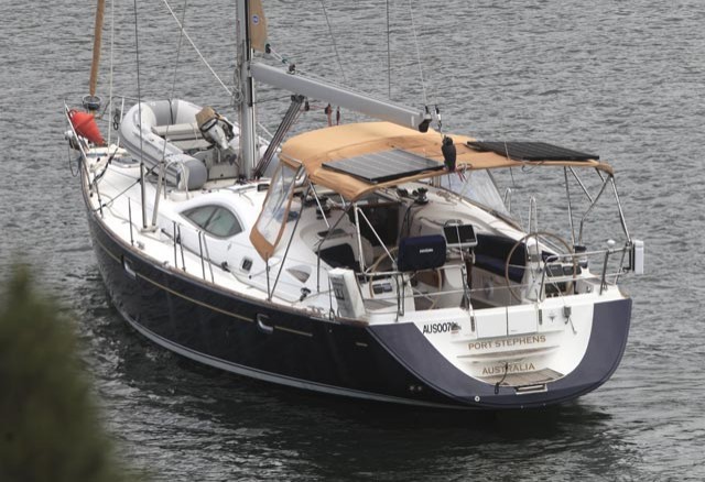

It is interesting that caravanner's seem to have some many problems with flexibles but yachties don't. Probably due to most yacth panels being secured with adhesive to the fibre glass. I have read of some who have had issues blaming the panels but then admitting they didn't fit them as advised as they new better. I was also following a caravan the other day and you could see the aluminum skin on the back of it moving, again gluing panels to a aluminum roof that has give in it would not be a good idea.

01:51 PM Jan 7, 2021
There are not many yachts doing thousands of km at 100kph, let alone with a headwind.
Looking out our window, of the few hundred yachts they appear to all be using solid panels.
You don't see many cars surfing down 30 foot waves either, boats have to contend with rough weather rough seas and and it does get windy in storms unless they are only fair weather sailors:)
The yacht pictured is a typical example, I wouldn't install flexibles where they have the panels either as you would need to make up frames etc to mount them and you would still get flexing due to the awning tubing, easier to use glass panels in that instance.
I know of those with flexibles on a crossover units that have done 1000's of Km on tracks that are called roads that most on this forum wouldn't even dream of taking a supposed off road caravan, they have no issues with them. I have just installed two on my cross over unit and don't expect any problems either as considerable thought and effort has gone in to the way they have been mounted.
