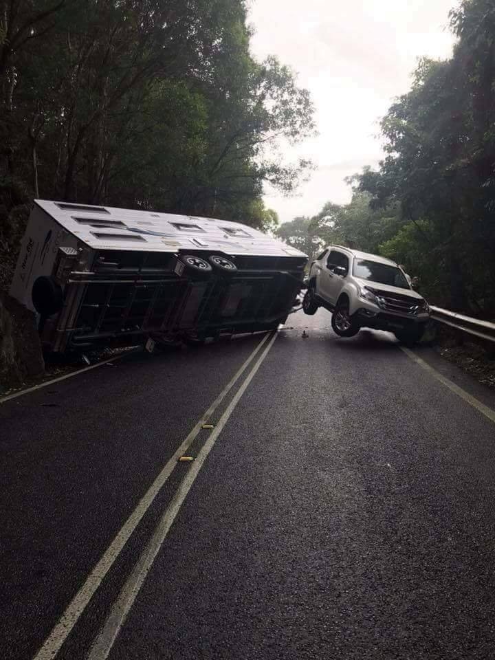

Hi Brett....I am pretty sure that this incident occurred on the Kuranda Range,near Cairns,about a year ago.As you suggest,the van looks to be too big for that car,although the water tanks are well positioned.Weight on the rear bar probably did little to help? Hope everybody escaped injury.Cheers.
-- Edited by yobarr on Wednesday 18th of September 2019 07:31:30 PM
Greg 1 said
06:58 PM Sep 18, 2019
They are towing with an MUX with a claimed 3 tonne tow capacity.
It can be very deceptive just looking at a van and guessing weights. It could quite probably be within the vehicles limits.
If its the road I am thinking it is, it can be quite slippery when wet which can be often, and extreme caution needs to be exercised when descending that hill.
Unfortunately people don't and often the end result is the picture above.
The fairly short wheelbase of the MUX wouldn't have helped either once it started to go.

I wont speculate if overloaded or not. For 5 weeks we've toured regional Victoria and so many people chat about our rig. Each time I ask them a question- what do you think the tare of the caravan is? 16x7ft
Most guesses are between 1300-1500kg.
It's 730kg.
So if I roll it....and it makes it onto the forum imagine the speculation.
Tony
-- Edited by Eaglemax on Wednesday 18th of September 2019 07:43:29 PM
yup no assumptions here, could have well been under the specs for the tug, but for me, I'd not be taking that chance.
Im seeing 3 windows at the back there which suggests 3 bunks plus probably a double in there too, which I figure means a van on the heavier end of the scale.
In the end, other than the contact with the guard rail , looks like it could be up righted without too much damage.
Probably can't say that for the content of the fridge or their pants.

I think the Isuzu was capable of the tow. Reports suggest that road is notorious for fog and slippery conditions.

Wet, slippery road surface and possibly incorrect application of brakes, entry to corner too fast and braked while turning?
Incident occurred July 2nd,2018,on way down hill,and started at the end of a passing lane.Toy car,big van,weight on rear bumper,slippery road,yaw sets in,goodbye. The car has been identified as an Mux? That being the case,GVM is 2750kg and wheelbase is a only 2845mm.As suggested,the van looks to be a 3 bunk model,and seems to be 20-22 long.Someone suggested New Age tare 2400kg,ATM 3000kg? No matter how much we sympathise,and say nice things,and try to justify decisions made,the simple fact is that there is no way that an Mux can safely tow 3000kg as a PIG trailer.No way. Period. Safe and happy travels to all,particularly those wise enough to ensure always that weight on cars wheels is at least 10% greater than weight on vans axle group.(GTM) Cheers

I totally agree Yobarr. The Mux has a low GCM. The 19ft bunk caravan used as my first example the driver would get away with but the van in question does look longer that that.
Even the 19ft one is on its limits.
Tony
Knight said
12:16 PM Sep 19, 2019
End of a passing lane, corner ahead, see pictures.
Wet, slippery road and possible incorrect application of brakes, entry to corner too fast and braked while turning, or too late.
I agree that it is wise to tow less than maximum allowable, so 2,500 kg for 3,000 kg MU-X, however;
Kerb weight: 2060kg
Towing capacity: 300kg/3000kg
Gross Combined Mass: 5750kg
-- Edited by Knight on Thursday 19th of September 2019 12:30:32 PM

Hi Brett...I have been told that only fatal accidents are investigated? I did spend much time trying to source a report on this incident,with little success.BUT,I did get to read coroners reports on several fatal accidents on the Kuranda Range.Cheers
yobarr said
12:49 PM Sep 19, 2019
Knight wrote:
End of a passing lane, corner ahead, see pictures. Wet, slippery road and possible incorrect application of brakes, entry to corner too fast and braked while turning, or too late.I agree that it is wise to tow less than maximum allowable, so 2,500 kg for 3,000 kg MU-X, however;
Kerb weight: 2060kg
Hi Dennis....whilst your quoted weights are indeed correct,the chances of an Mux safely towing 3000kg as a PIG trailer are about as remote as the chances of a Ram 1500 or an LC200 towing more than 3000kg as a PIG trailer........Zip,zero,zilch,nil,nada.And whilst people who use lightweights to tow heavy vans may well have been mislead by their well-meaning friends who advise that they have towed a "million kilometres with no trouble",or lied to by a van salesman,there is absolutely NO excuse for those people not to have done their own research into towing.But,as is so often the case these days,it will be almost certainly someone elses fault! Cest la vie.Cheers.
-- Edited by yobarr on Thursday 19th of September 2019 01:04:52 PM

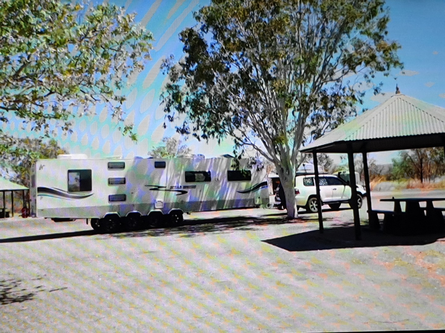

Olive Oil said
04:14 PM Sep 19, 2019
We saw this one about a week ago, four axles, very long & a tinny on top.
Olive Oil - probably not that much weight on the towball because of all the axles lets them do it (in their own mind) .
Regarding the Kuranda accident I seem to remember reading somewhere that another vehicle was involved. I was up that way a fortnight ago and speaking to a local he was of the opinion that many who use the Kuranda Range (ie workers commuting) tend to use it as a racetrack. Has more corners than Mt Panorama. Great for wannabe's.
Olive Oil said
08:31 PM Sep 19, 2019
Nevd wrote:
Olive Oil - probably not that much weight on the towball because of all the axles.
What about the total all up weight, would it be within legal requirements?
08:36 PM Sep 19, 2019
A couple of extra axles & 4 wheels would add a couple of hundred kg.
JayDee said
11:31 AM Sep 20, 2019
The tow vehicle looks to be a Land Cruiser.
Would be interesting to know the loaded weight of the van plus the length..
But, what a great rig for a family of say 2 adults and 3 to 5 kids to have to tour our great land.
Certainly appears to be a home on wheels.
Yes we are having more van accidents these days, but the van traffic has had a huge increase.
Drive safely and arrive on time. NOT DEAD ON TIME.
Jay&Dee

Some eagle eyes on facebook suggest it is a NEW AGE van.
This is a New Age van 19ft tare 2330kg atm 2630kg
https://www.caravancampingsales.com.au/items/details/New-Age-Manta-Ray/SSE-AD-6282333?pageSource=details&id=SSE-AD-6282333
A 22ft New Age tare 2400 atm 3000kg bunk caravan.
https://www.gumtree.com.au/s-ad/youngtown/caravans/new-age-manta-ray-22ft-bunk-ensuite-series-2/1214021435
Tony
When fully laden it weighs more than a fully laden tug.

Absolutely Montie! We can only hope that eventually others join you,I and Graeme in understanding that! Cheers
I've got lots of mates, who are the 'she'll be right mate' kinda fellas and they do stuff that I'd never be game to. then I think, that maybe they know something that I don't, when it turns out well
I do all the research I can and then double check it just in case.
I've often wondered what I'm missing out on because of my weakness/wisdom in this area .
I guess this guy, just found out. nothing like real world testing.

Another had a SWB Land Cruiser (must have been modified) used as a prime mover with a similarly long van behind on a 5th wheel setup, parked at Longreach.
we look at some of these set ups and call ' now way ' and I'd be willing to think often enough that would be on the money.
