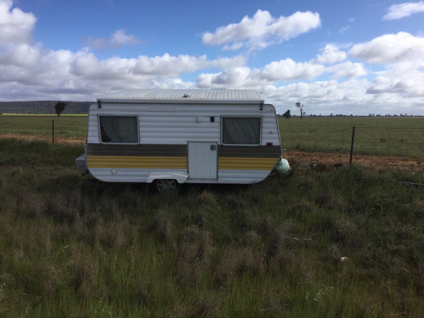

The van somehow parted company with the Commodore and slid up an embankment into a wire fence.
The hitch had been in the locked position on the towball. It was checked before leaving the campsite at Narrandera and again 5 mins later at the service station, so no idea how it came loose.
I still cant believe she didnt roll over.
The draw bar was buried in the dirt and the only damage found thus far is to the metal framework where the gas bottle sits, the chain broke at the drawbar and the wiring pulled out of the 7 pin at the car end.

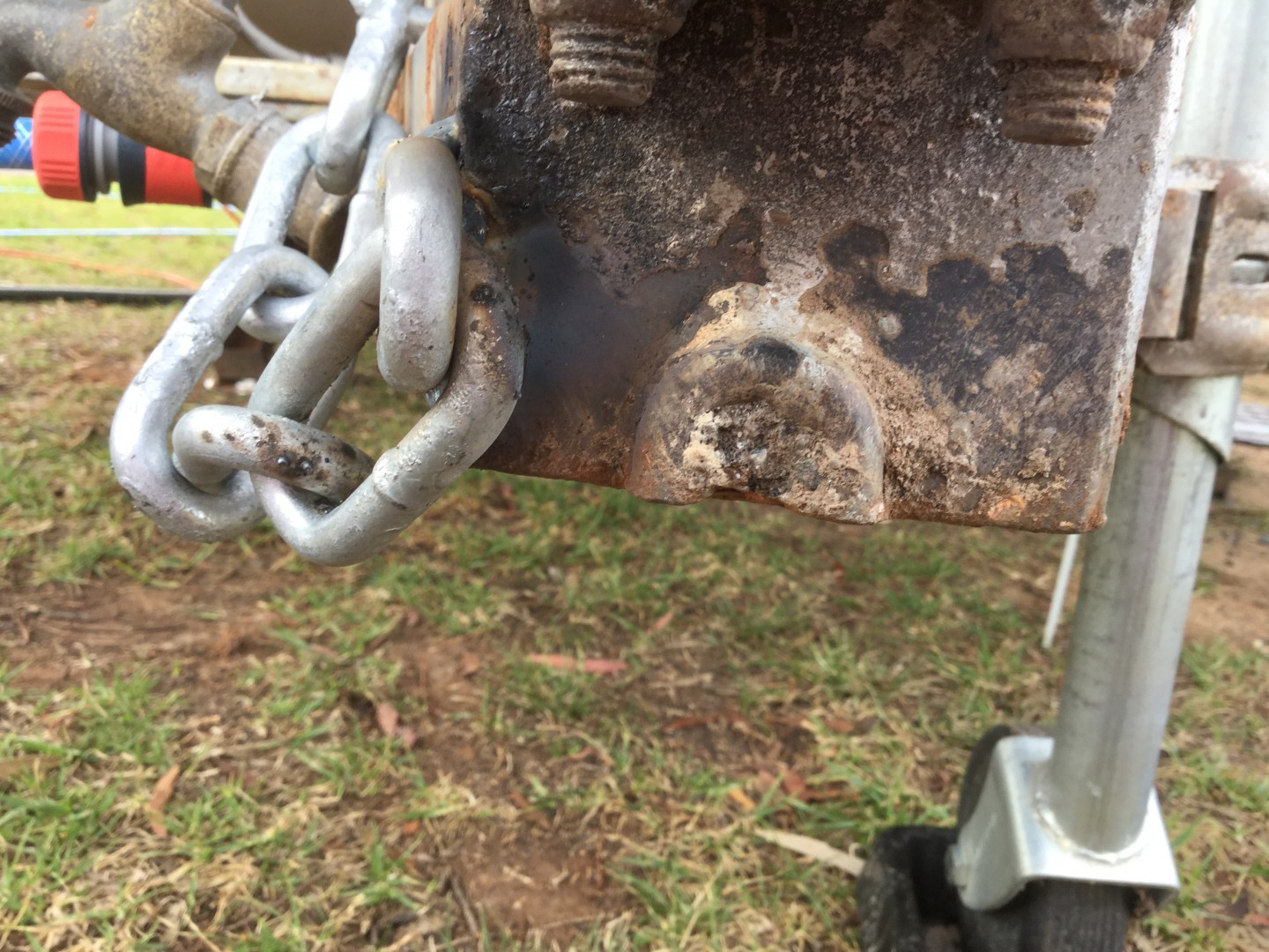

The problem was that the chain, which I think was somewhat original, was under the drawbar. So when its hit the ground the link that was welded to the bar has snapped. 1/2 the link was still welded flat to the bar, if that makes sense. The new one has been welded to the side of the bar.

The chap who welded the new chain on took two links of it, but said it most likely wouldnt make much difference and anymore removed would have been too short.
The photos show where the chain was and where it is now. There isnt a hole for a padlock on the hitch.

Legally the chain/s are suppose to be short enough to prevent the drawbar from hitting the ground but it can be difficult if your rig is a low one as yours is. The chain has to be long enough to allow for u-turning.
When I built my van I also welded my end chain link to the side of the drawbar.
Once hitched up I use a small padlock to secure it in the hole of the hitch. I watched a youtube video whete a guy had a trailer with mechanical brakes. He'd hit a bump and the brake flap would flip over stopping the brakes from working. I thought a poor worn hitch could do the same.

The rest of the caravan ended up in a roadside ditch.
He was doing 100kph at the time.
Could have been a whole lot worse Jamjar.
I,m glad you got away with so little damage.

That would have been a shock. I too was doing 100kph and Im thinking the wind played a role it the event. Im heading home, tomorrow and the forecast is windy, so will be taking it easy.
Thank you, Sandsmere. Yes, luck was going my way. As I saw her heading into the grass I saw the angle increase and thought she was going to roll. My thoughts were that this was going to end up on Grey Nomads, as one of the many rollovers.

I didnt hit any bumps and feel that it was the wind that lifted her.
What I dont understand is given that the drawbar should have hit the road, how did it end up travelling to the left and up an embankment? Why didnt it just stop on the road? To travel the distance it did, wouldnt the drawbar have remained in the air?

Spare no expense on a new coupling and ball and fit TWO chains of the correct length and load rating and ensure your break away system is working and maintained correctly.
If not for yourself you owe it the rest of us who may be sharing the road with you.

Rob, the van has a tare of 620kg and GVM of 750kg and doesnt have brakes or breakaway system.

It wasnt scary really, as I just thought I had a flat tire. The commodore handled it extremely well. The trip was unplanned, as I got a call to say that my mother was dying, in Victoria. I looked at the insurance and it was right for August when I left. Didnt even register that I would be returning in September. However, I wasnt aware that you could call and add the month if need, so will be on top of it, should it happen again.
Yes, she is light, so not much weight on the ball I expect.
The van could, once again, come off while travelling one kilometre let alone the distance from Narrandera to home or the extra 40 kms to get it registered.
While remedial work to a chain may help if it happens again, it could still happen and you could kill someone.

Yes, the links are stamped. The chain was purchased from a caravan parts dealer.

Just my opinion though, I would never use a padlock instead of a D shackle as I have seen padlocks unlock if you put pressure between the brass housing and the looped pin. They pop the lock.

Kevin, no one suggested using a padlock instead of a D shackle, which are required by law to be used.
What was said was that you could put a padlock on the hitch, if there was a hole for one, not a padlock onto the chain. I had a trailer once that had the hole on the hitch. It was there so you could padlock it on to deter thieves.
