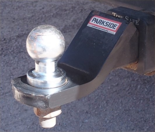

Done about 20,000 km. It is greased, just starting to wear the chrome off to the copper coating. Just can't get my head around having steel to steel bearing surface without lubrication.
A very small amount of moly grease, cleaned off and replaced every few weeks when travelling..
ball replaced every year regardless of distance travelled

no grease for me, maybe the odd spray with a silicon spray. my balls don't squeak

My Coromal dealer, told me that if I want the best results I have to replace my balls every year.
At the cost of approx $15 it is a low cost insurance against any issues.
Last year when replacing the ball, I decided to also screw the old ball nut on top of the new nut for extra security.
I do not use any grease etc.

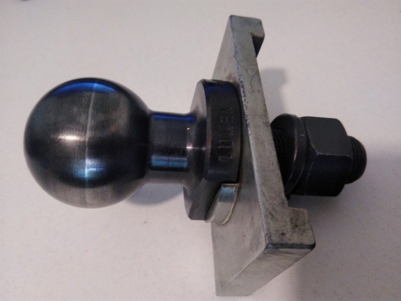

I towed a van with a friction hitch for a friend recently & had to get a ball with a squared base & the corresponding base plate to stop it unwinding the ball. Also had to be certain that the ball was completely dry & free of any sort of lubrication. BTW, it was a pommy van, about 20ft long but light & had over ride breaks that worked extremely well.

Cupie & Knight, yes I've got one of those Alko anti-sway hitches, and they need a special ball that isn't chromed, and a plate on the hitch tongue to stop it rotating and loosening itself. They also have to be kept totally grease free. Unfortunately, even the dealers don't seem to know this, and when I took it in for a check they moved it around with their usual tractor which has a towball dripping in grease, so I had to scrub the towball and the anti-friction pads in the hitch with brake cleaner afterwards!!
