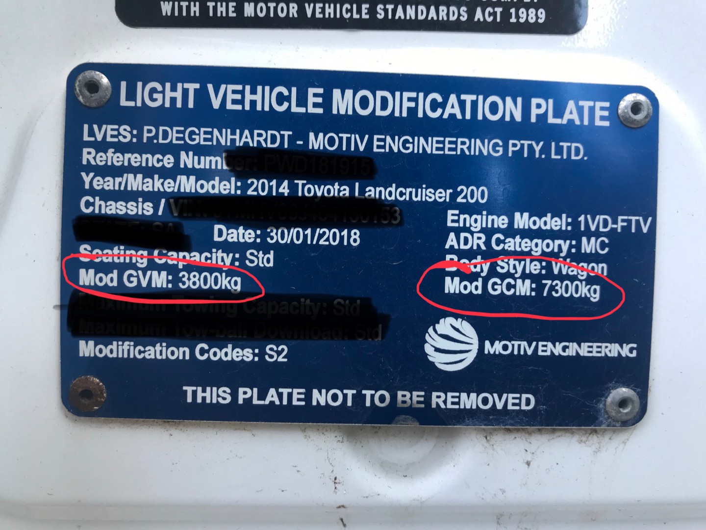

I will get a pic of the actual compliance plate from my sons 200 series and post it to indicate genuine compliance.

Iva Biggen said
09:40 PM Jul 29, 2019
Here is the compliance plate and this comes from Lovells with all the approved necessary paperwork to have your rego papers and files updated.
