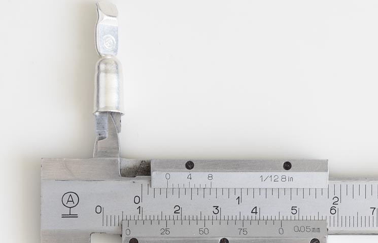

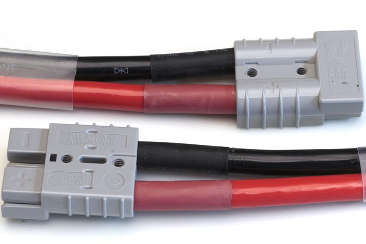

How did you get the 4AWG cable into the 50 amp Anderson plug terminals? It's a battle to get 5AWG @ 16.8mm sq into the lugs, no idea how you would get 4AWG @ 21mm sq into that hole?

The learned virtuosity of bush carpentry cunningness! Stuffed as many wires in as possible & the few remaining wrapped around the cable.
The new cable does not get warm & the compressors take 5.0 seconds instead of 5.5 seconds for the pressure switch to stop.
I would have gone with a larger Anderson plug but that introduces new list of issues. The other idea was to try & expand the lug with a ball punch but I didn't have one at hand. But I might give it a go as I have spare lugs to experiment with. Just have to knock up a jig to hold the lug.
Use the largest cable you can to squeeze as much out of whatever you are building.
We ground a long drift punch tapered on the end to open up the same size crimp lugs to make it easier to get the 6 B&S cable in before crimping it with the hydraulic crimper. The Anderson plug lugs are much thinner material though, so a little at a time to avoid splitting it might work. At least the genuine Anderson plug 50 amp lugs have a flared bit at the start of where the cables go in so they are at least easier to get the fine strands in.
Good luck with the lug flaring and maybe a photo if possible? I'd love to be able to run 4 B&S cable into the 50 amp plugs rather than 6 B&S cable when doing the cable run from the start battery to the towbar, that would improve the voltage drop heaps when trying to pull 60 amps through it to the DC to DC charger.
T1 Terry
11:37 AM Jun 28, 2019
I drilled a block of wood to the right depth to support the end of the lug & the bottom of the cup. With a bit of grease I first used a Dynabolt which was 6mm at the end & hammered that in. That worked really well & I could wiggle it back out. The next stage was more difficult as I couldn't wiggle the punches out.
Using progressively larger (old) drill bits, I filed a small taper on the back, only needs to be larger by the diameter of the previous size, so 0.2mm at most, & hammered in. It is better progressively work down the cup with larger sizes. Not try to go all the way down with one size then all the way down with the next larger size as that is more difficult to get that punch (drill bit) out because you don't have wiggle room so to speak.
I did have to drill a hole in the piece of metal (make the hole a bit loose) to make a tee handle & put that over the drill bit & then drill bit backwards in a drill to clamp the drill bit, to be able pull the lug off the back end to the drill bit a few times.
Cleaned off the grease & the lugs looked in pretty good shape. Wouldn't want to do this all the time but for the odd 4AWG cable is wasn't too difficult & didn't have to buy any extra tools. Buy a Dynabolt (back end 6mm) if you don't have one, as it would be the worth getting for the first enlargement as the was easy.
I cant believe you guys are going to all this trouble. If you are doing it for voltage drop reasons, just cut the cores out until it fits in the lug. This will not affect the VD. (have you checked the reduced csa of the lug vs resistance?)
If your doing it for current carrying capacity as in T1's post you are going the wrong way about it. trying to use a cable to carry 60 amps thru a 50amp lug is not advisable. Try a 120amp Anderson that is manufactured for that size cable and the current rating.
Chris.

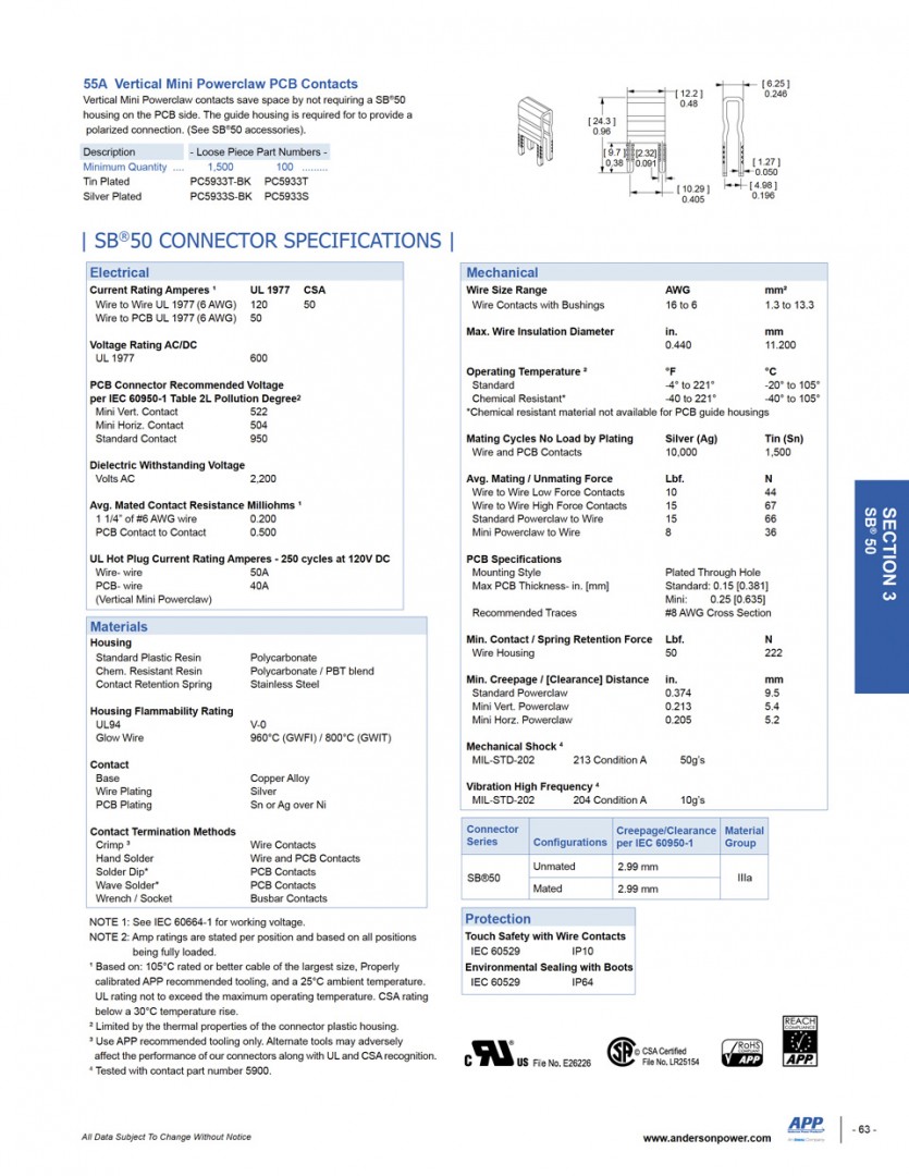

03:36 PM Jun 28, 2019
The 50amp plug can take 120amps using 6AWG cable when not hot plugging.
The Travelling Dillberries said
04:48 PM Jun 28, 2019
Where did you get that current rating from Jon, this is the spec from Anderson:

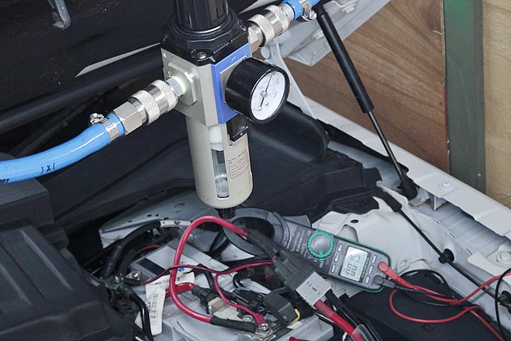

I've had up to 11.3 amps output from 120 watts. I had a 10amp MPPT & it didn't put any more than 10amps out. Bought a 20amp MPPT & got 11.3amps. We learn by our mistakes. So get a controller with enough capacity.
My setup: https://thegreynomads.activeboard.com/t65231112/custom-6x20-watts-solar-setup-with-mppt/
120 / 11.3 = 10.62v. That would require a 100% conversion factor, something not even the most ardent MPPT supporter will try to propose is possible. I'm guessing your battery was not down to 10.6v when you saw this 11.3 amps so that makes the calculation even more beyond possible reality, so something doesn't add up does it. The catch cry that lithium batteries are not magic must be the same for MPPT controllers, so either the solar is not 120w as the labels claims (6 x 20), or the unit being used to measure the current isn't accurate, or a combination of the two, or magic is a foot.

It cost me another $260 for the replacement 20amp controller, at least I have a spare 10amp I can pack as it is small enough, & $50 for heatsinks to squeeze a bit more out of the controller in hot weather. In the meantime I have upgraded the 6AWG lead to 4AWG. This is actually for my air compressors as the 6AWG was too light, but it will double up for the solar panels. Another 0.11% increase in efficiency for the panels!
We like to have our 240volts at home working properly so why not have the 12volt system working as best as it can.
T1 Terry
T1 Terry
Chris.
The max limit of 10.5v is the point the DC to DC charger reduces its output current to limit the peak input current to 60 amps, so that is a hard limit, but going up to 120 amp Anderson plugs for such a short term possible overload is a bit of overkill.
T1 Terry
UL1977 standard
So Jon, are you using Anderson "Powerclaw" not the standard Anderson "powerpole"?
Just trying to get a handle on what you are suggesting as I would not like to think anyone would try and use a 50Amp to run a load of 120amps, only thing to come from that would not be good.
Thanks Terry, no mention it was short duration....all good.
