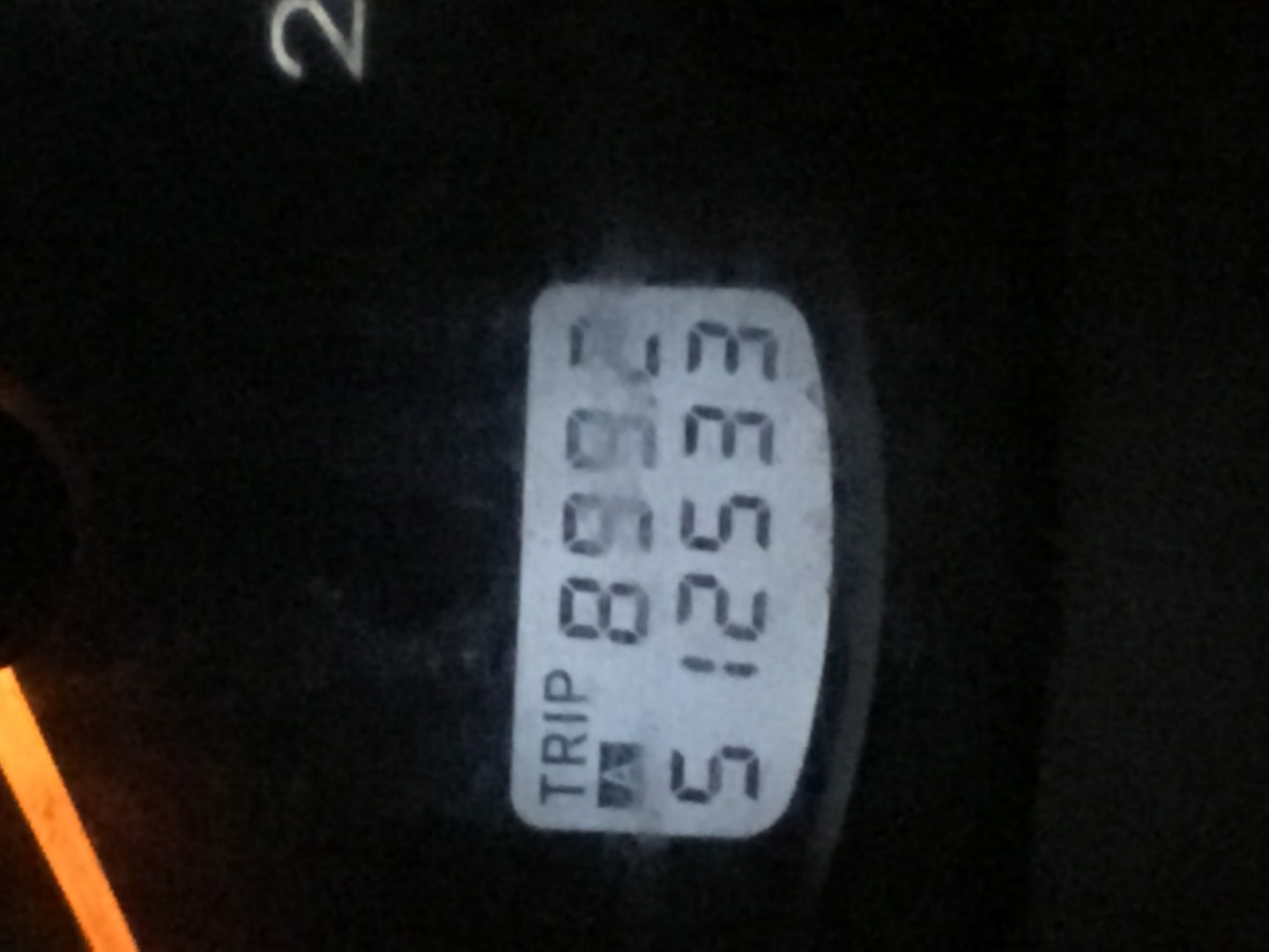

Hi John
i dont post very often but your request caught my eye.
i have a 2009 3.2lt common rail Triton with no Catchcan and its done 512,000 plus Klms. everything on the motor is still original. The Oil is changed every 10000klm without fail and it only uses about half a litre (at this date) between oil changes. The Ute has been worked hard, towing between 3 and 4hundred Klms per day.
ive attached photo of speedo.
Hope I haven't just jinxed it.
-- Edited by landy on Monday 21st of January 2019 10:07:51 PM
