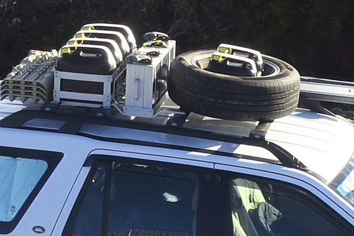

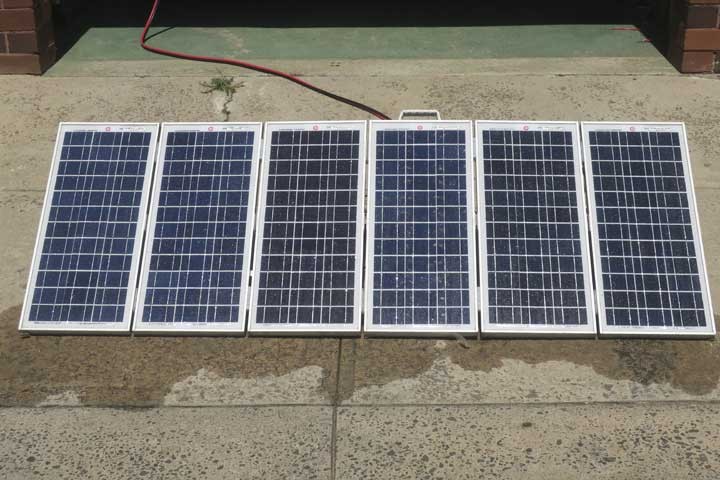

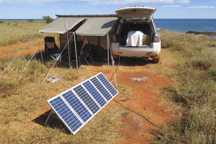

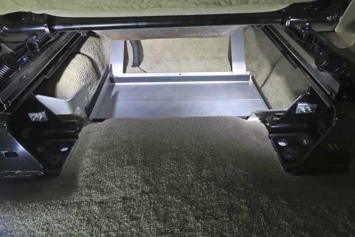

I didn't have the room for a solar panel to take over the car so custom built a 120 watt panel. 6 x 20 watt Projecta panels, Victron SmartSolar 75/10 controller, 3 x 26 AH gel batteries squeezed under the seat & on the transmission tunnel. All I am running is a 28 litre fridge & charging the phone & some USB torches if I can't charge these while driving. If needed the 3 x 26 AH Gel batteries can run my 3 compressors which draw up to 100 amps. Also if needed the 3 batteries have a combined 280 amp current for 5 minutes to jump start my car which requires 238 amps.
I have wired up the panels trying both in parallel & 2 panels in series x 3 sets. Wiring in series is a very tiny bit more efficient, probably the best time is in low level light. The controller is as close as I can get it to the batteries & have 6AWG cable to the batteries. The controller would be better near the batteries for adjusting voltage for temperature but it's the best I can do.

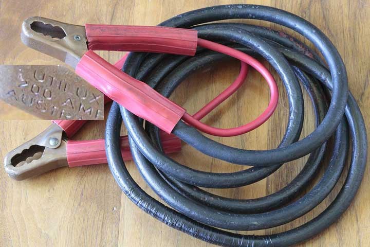

Having the panels in series keeps resistance to a minimum if I need to use all the extension cables to the solar panels (4m 6AWG, 4m 8AWG & 2m 12AWG). The short sections of wire on the back of the panels is 12AWG. I need another extension to reach sun in some situations so will make up another 6AWG cable.

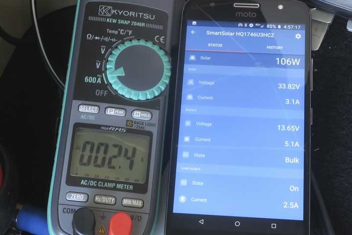

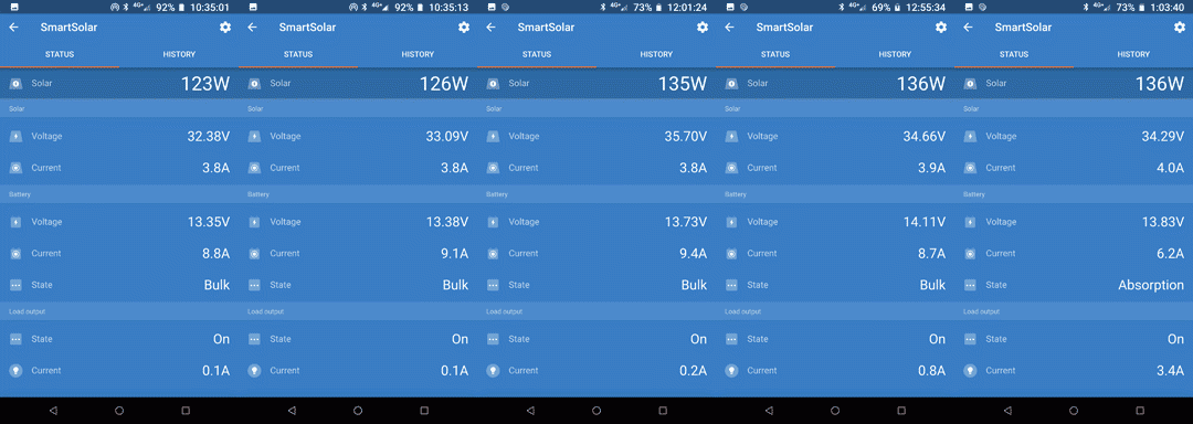

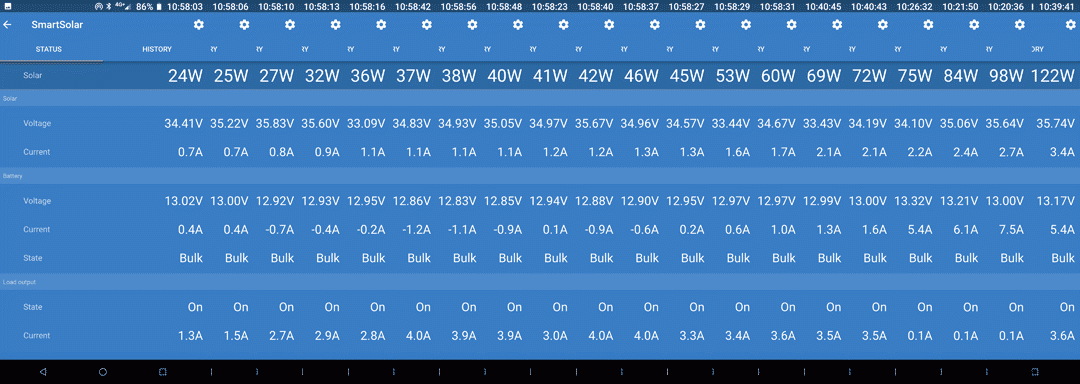

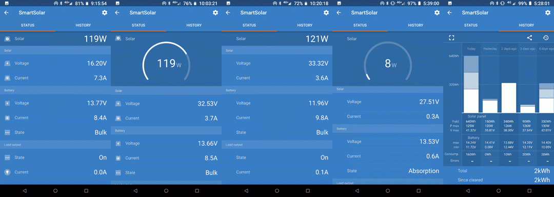

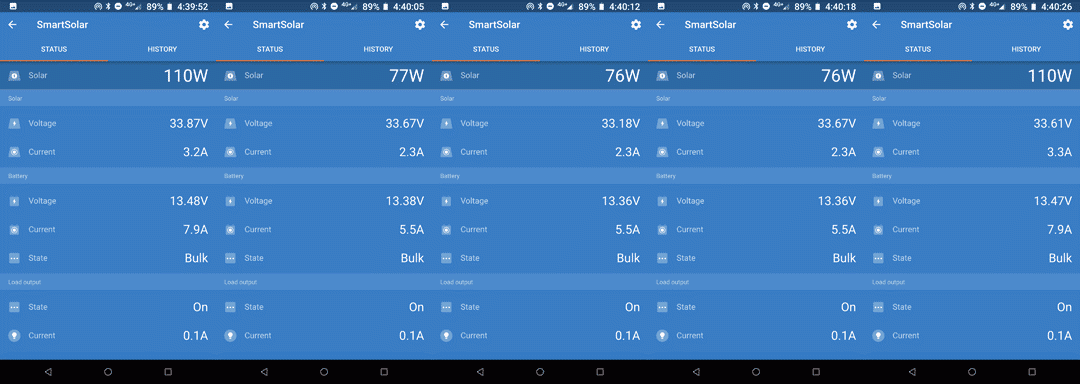

Some screenshots of the phone app:
Screenshot 1: Parallel with the 16.20 volts input. Screenshot 2: In series 32.53 volts & upper view of screen with graph. Screenshot 3: Battery 11.96 volts so up to 9.8 amps (did get 123 watts & 10 amps) Screenshot 4: 8 watts & 0.6 amps charging. Screenshot 5: Graph of each day's harvesting.
Solar panels can be stored on roof (I put them in the car on corrugated roads to reduce weight by 15kg) behind second spare wheel, & avoid 99.9% of bugs!
Thanks for the look at your ingenious solar setup. You have done well and designed a very workable rig for your compact camping. Good for you. Looks good too !
The outputs are useful to look at. You do get the full output from your panels with the MPPT reg. It shows the theory is correct also. It takes the higher voltage and converts that to extra current with minimal losses even at 8 watts. Screenshot 3 shows how the lower battery voltage enables the MPPT to deliver maximum amps and thus power.
It is a lesson for people who say I do not have anywhere to put panels. Bravo !!

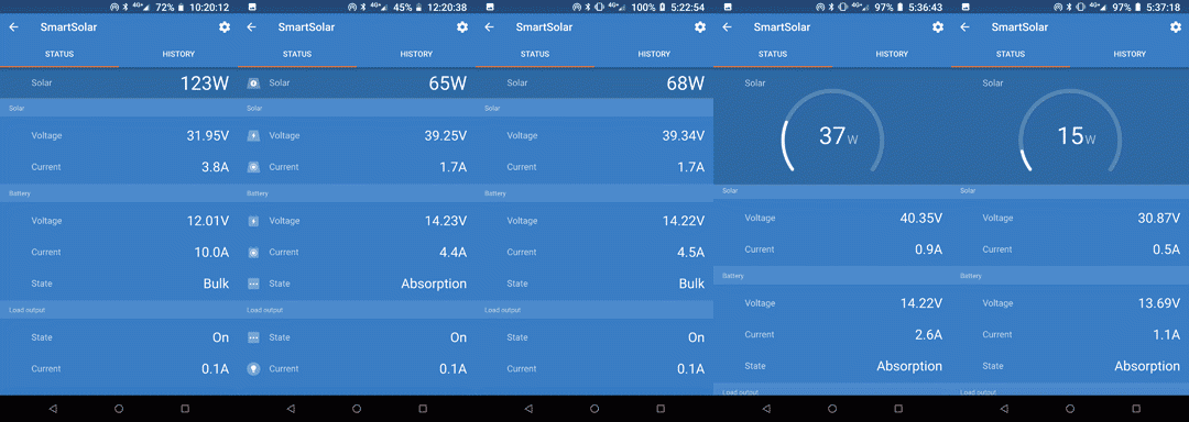

A few more screenshots. I think it is a bit like good wine that has been cellared properly. Battery & controller together in the right location or at least the best one can do trying to keep compromises to a minimum. Calculate proper size wire for total run there & back + & -. Quality solar panels avoid using builtin controllers which are in the wrong location. A good controller adjusts for battery temperature so it needs to be in the same environment as the battery. Build the best you can do, most things are easy even if you need to make a few changes & you will be able to squeeze a bit more power out here & there.
Screenshot 1: I had drained the battery a bit, 10 amps input. Screenshot 2: Dropped to 65 watts due to cloud. Screenshot 3: Dropped to 68 watts due to cloud. Screenshot 4: 37 watts late in the day & slight soft shadowing. Screenshot 5: 15 watts late in the day & slight soft shadowing.
Thanks for some more instructive screen shots. WOW even a couple of extra watts there, when the battery voltage is down low.

Ummm...... they look like quite large area panels for 20w, can you tell us the dimensions of each panel? I see in the 3rd photo in the opening post there is a clamp meter showing 7.9 amps, is that from all the panels together in parallel or a single panel or what????
T1 Terry
07:37 PM Jan 17, 2019

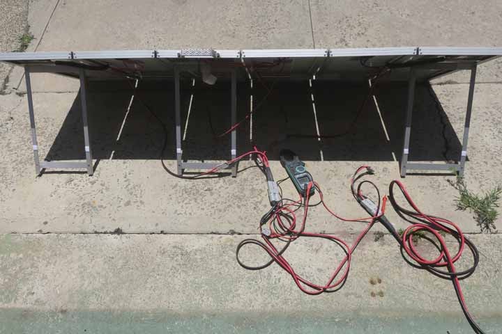

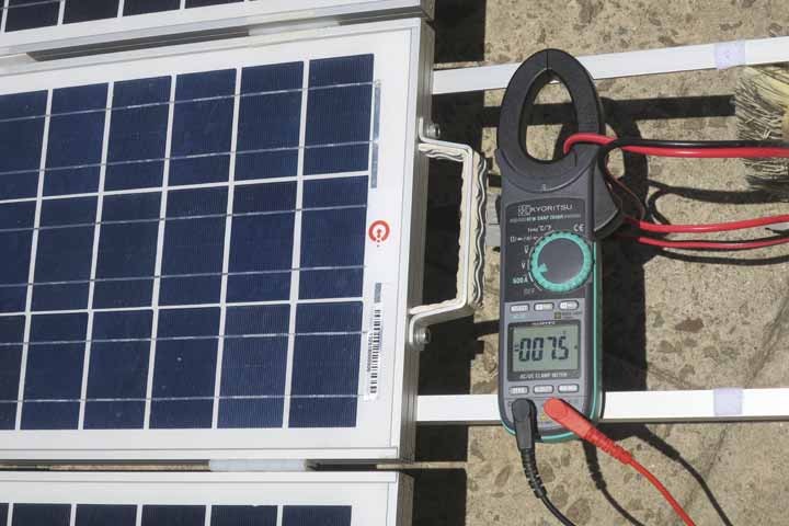

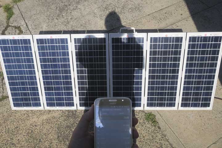

The Kyoritsu 2046R cat IV class clamp meter photo was shot when the panels were connected all in parallel & when the panels were a bit below 120 watts, & with 10 metres of extension cables including a 2 metre 12AWG cable which was never intended to be used in this location which was mostly for a Noctua fan in the car while sleeping. If the sun is too far away any cable is better than shadow!
The Projecta solar panels overall size are 638 x 278mm, overall foot print of actual cells is 582 x 237mm, so 78% of the panel area, not brilliant. The solar cells could be stacked tighter & the frame could be reduced in size. But nevertheless when these panels are stacked behind the second spare wheel no bugs hit the forward facing panel. These panels are only 25 mm thick instead of the typical 35mm & don't twist. So total thickness of the 6 panels is only 150mm instead of 210mm, 15.3kgs including added legs & wiring. The 6 panel volume not including handle & hinges is 26.6 litres. Can't complain about that!

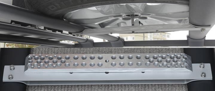

I am completely out of room on the roof front to back, including room for sand flag & opening of full tank holders (same space), over by about 32mm, cross bar clamps are not totally clamped on the extruded rails.
I did have a roof platform (still got it) but they are in general poorly designed & simply dead weight. I replaced the platform with a second set of cross bars & reduced weight by 16.4kg. Currently if I have everything on the roof including roof rack rails, cross bars, brackets & 50 litres of fuel & tanks, wheel (not the tyre I normally have, all I could get in Halls Creek), sand tracks, awning..... 142kg! but I can reduce this considerably for off road. Even the bracket for the second spare wheel I have machined out of 5083 alloy to reduce as much weight as possible.
Today I tried 3 panels in series in 2 sets. Due to the haze humidity in the air & around 4 pm I could only get up to 116 watts. The problem with this setup is if you get a small shadow on one series set, half your harvesting is gone!
Back to 2 panels in series in 3 sets. Could not get more than 110 watts due to haze humidity & a bit later in the day. 110 watts & than shadow over each series set, & you still get 2/3 of the power.

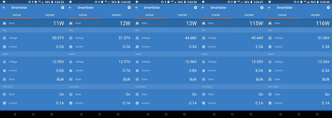

Screenshot 1: 110 watts no shadow. Screenshot 2: shadow over first set. Screenshot 3: shadow over second set. Screenshot 4: shadow over third set. Screenshot 5: 110 watts no shadow.
I have no diodes in any of the setups. To double check for any issues I have alternately plugged each series set in, or 2 sets in & 1 set out. So doesn't seem to be any issues.

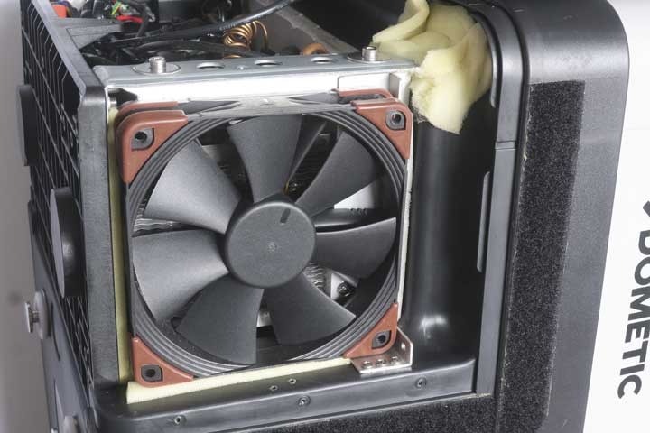

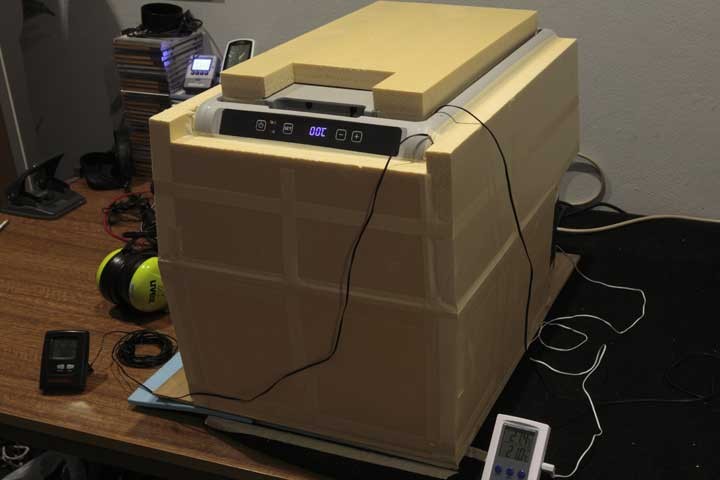

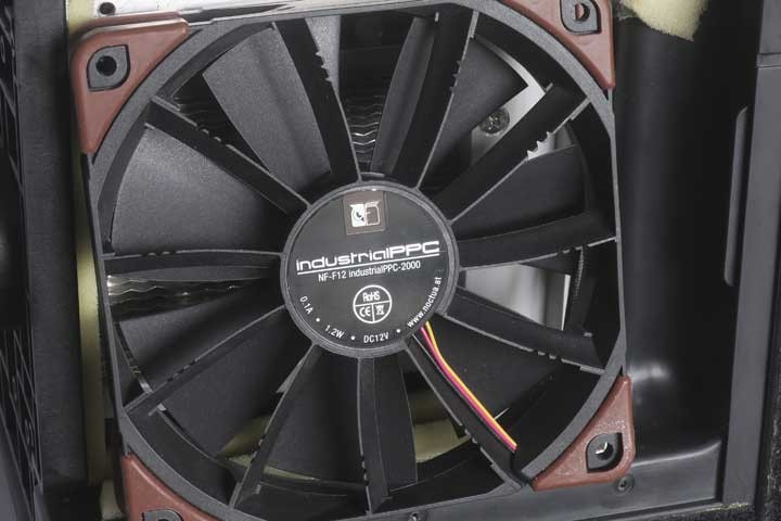

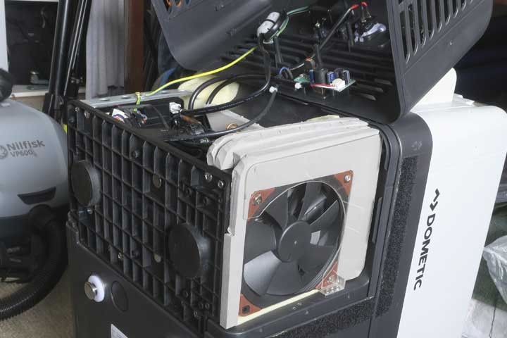

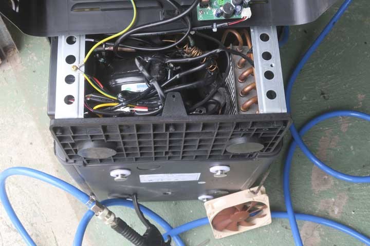

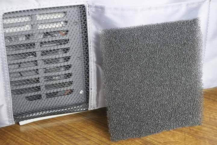

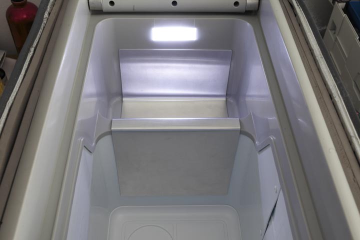

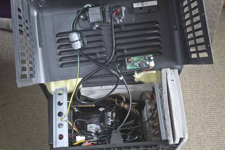

The fridge I have replaced the fan with a more efficient one, shortened the power lead & inside replaced 55 cm (110 cm +& of very thin 16AWG 12 volt lead to the circuit board with 12AWG as part of making the fridge more efficient (extra insulation in another thread)

The reason I asked about the clamp meter reading was that it didn't add up, nor do the panel sizes.

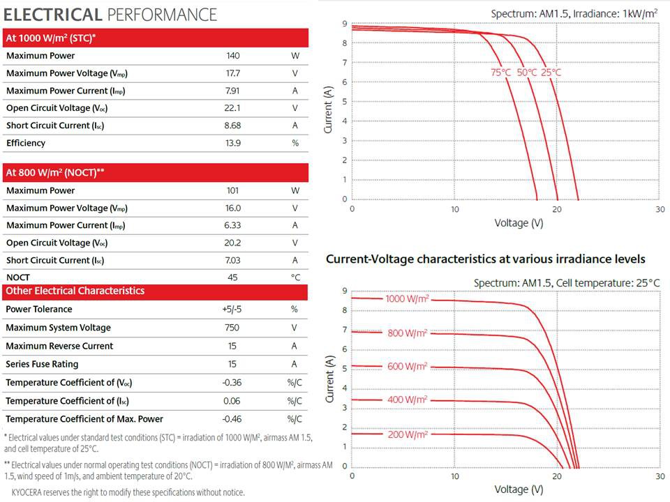

I have a number of Chinese Sista 60w 540mm x 630mm outside frame dimensions, the Projecta 20w solar panels overall size are 638 x 278mm, the Sista 60w panel actual solar module dimensions are 505mm x 570mm, the Projecta 20w panel actual solar module dimensions are 582 x 237mm. Clearly the panel may be labelled as 20w but the actual area compared to the 60w Chinese panel is a lot more than 1/3rd the sq area. The other issue is the output, a cheapie 8 yr old ebay 120w panel optimistically claims the Imp is 6.57amps, yet the parallel string of panels rated at 120w shows 7.5 amps in less than optimal conditions. The 60w Sista panels have an optimistic Vmp of 3.43 amps, so 2 panel in parallel would make a 120w and 2 x 3.43 = 6.86 amps, not 7.5 amps. the Chinese panels are renowned to be a tad optimistic when it comes the stuff they write on their labels so the 6.57 amps from technology 8 yrs ago and the 6.86 amps from more recent technology should be read as the maximum with the sun and planets all correctly aligned, not what one would normally see from them even if aligned optimally angled to the sun and connected to a battery. If you get more than 5 amps consider it a bonus.
So, what is the true capacity of these panels rather than the information printed on the label? Anyone have a lightbox to flash test these panels as per STC standards?

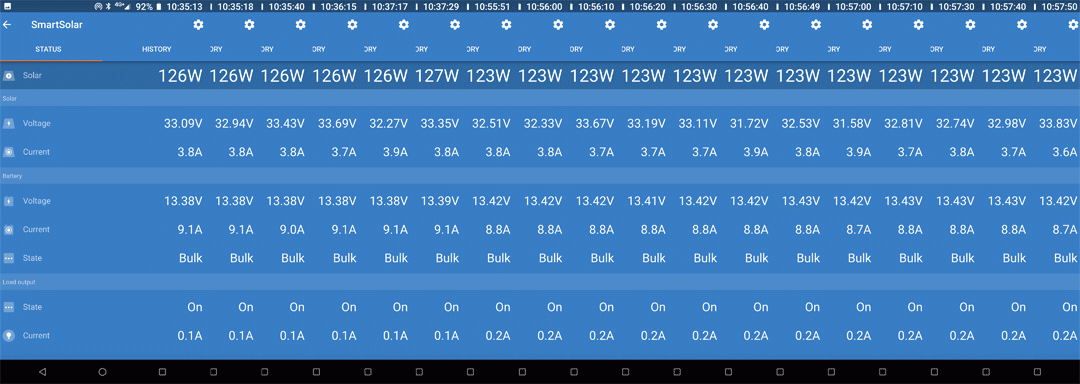

I haven't tried 3 in parallel as 2 sets as I am not using diodes. The 120 watts is simply one large mass of 36, 72 or 108 cells.

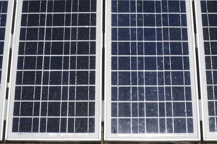

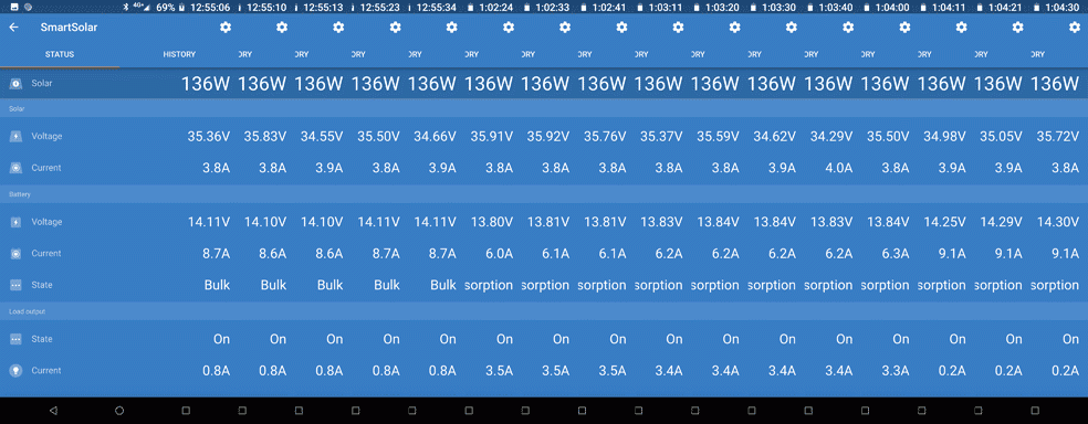

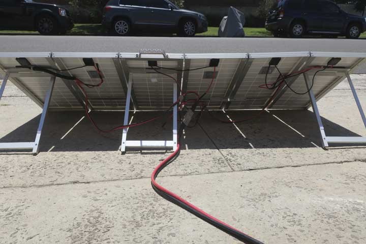

Today I was getting about 123 to 124 watts with minimum light cloud (see photo) & up to 126 watts with a clear sky (still a bit of haze with the humidity). So I can't complain about the panel output, probably better than the "no name" panels. The panels were fairly hot, as I do not have a suitable thermometer, so by the technical process of touch probably somewhere about 50C.
I thought I would apply some seriously high technology to the panels to reduce their temperature, reducing the panels temperature to roughly 35C to the touch. I sprayed water on the panels at roughly 4 litres per hour with a hand pressure pump. So if one has access to water it might be worth setting up a sprinkler system to push a 120 watt system to 135-136 watts, even briefly reaching 137 watts.

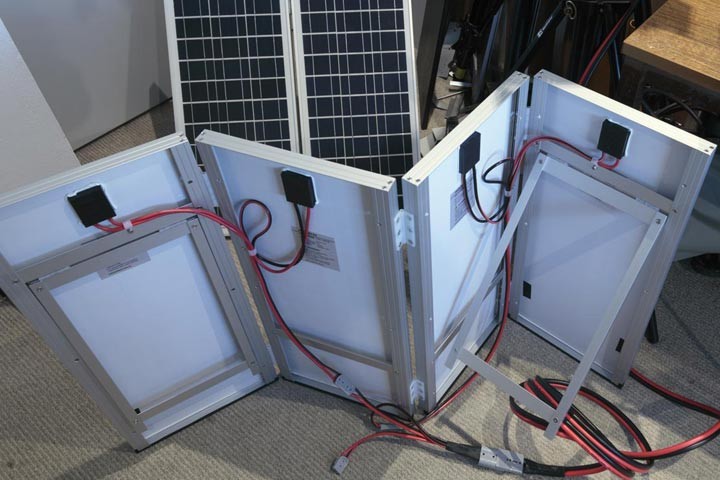

The photo of the back of the panels is a bit of a mess due to the various temporary rewiring.
Screenshot 1: 123 watts typical. Screenshot 2: 126 watts maximum about 30% of the time. Screenshot 3: 135 watts water cooled. Screenshot 4: 136 watts water cooled 8.7 + 0.8(mobile charging) total 9.5 amps. Screenshot 5: 136 watts water cooled 6.2 + 3.4(fridge starting up) total 9.6 amps.

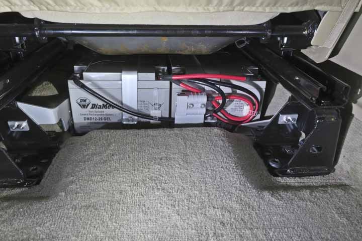

I am also using 3 x 26 AH gel batteries as that is all I can fit in the car. The driver's side has 2 compressors. There is no room in the engine bay for an auxiliary battery & I don't want the battery in the rear footwell as that is where 60 litres of water sits.
9 times out of 10 we sleep in the car as we couldn't be bothered putting up the tent, so everything has to go in the front & solar panels on the roof.

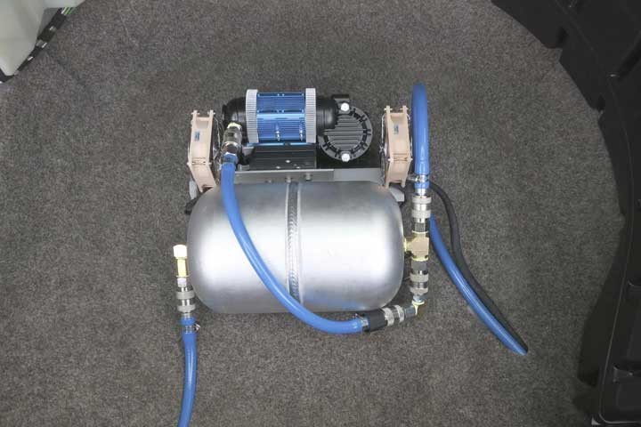

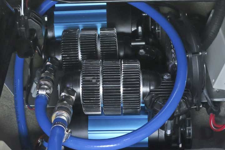

The compressor photo is 2 of 3 compessors with added external & internal heatsinks which make a huge difference in pre-cooling the air to reduce moisture together with air tank & moisture trap, also fan cooled. Very handy for blasting dust from the car!

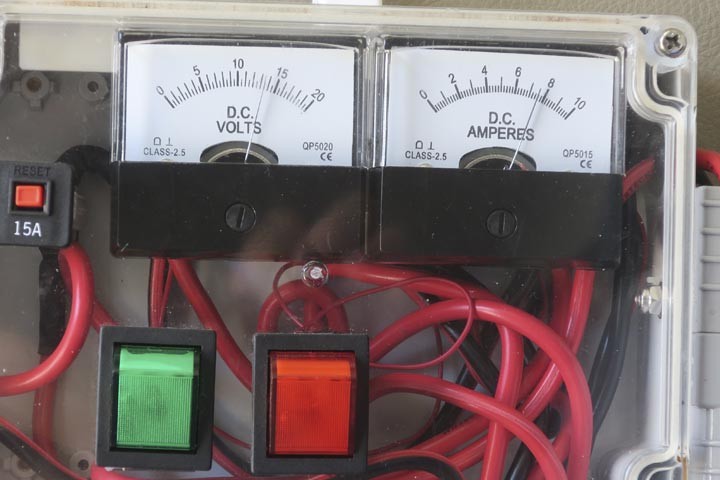

Clamp meter, Victron MPPT & voltage & amp meters all give readings within more than reasonable tolerances of each other.
A bucket of water over the solar panels provides far more improvement than fiddling around with electrics!

Hmmm...... so you have found a way around the temperature coefficient that plagued Kyocera and every other solar panel manufacturer, that dreaded 0.46% per degree Celsius above 25*C . Even the system owner reported that cooling the cells increased the output to 136w and without cooling 123w and all through your much loved MPPT type controller.

Maybe I am getting up to 126 watts without water on a not perfect day because I have not skimped on wiring, it is pretty much all 6AWG on a tiny setup!
The Projecta panels come with a 20 page instruction manual covering mounting, mounting hole spacings, charging, connecting multiple panels in series, parallel & series & parallel for people like me, with diodes & cable size for various distances, but I am well on top of that particular issue!
Projecta SPP20 specs: Polycrystalline Rated power 20 watts Open circuit 21 volts Short circuit 1.25 amps Peak power 17.5 volts Peak power current 1.14 amps Test conditions 1000W/m2 25C Tempered low iron glass
Panels were $42 each in 2018, the cheapest part of this whole project so to speak!

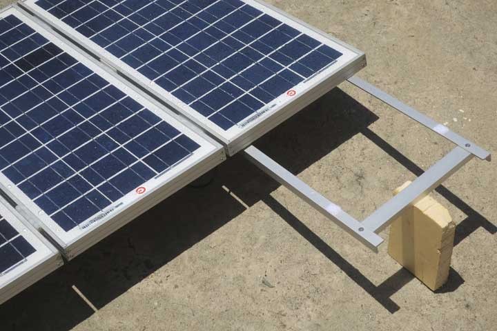

I did spray water on the rear as well as an after thought, maybe it was keeping the panels well into the upper end of 136 watts & brief moments into 137 watt territory & this was not even a stunningly clear Sydney day. But water on the front reached 136 watts without problems.
On a hot sunny day I will put blocks on the bottom edge to lift the entire panel off the ground for increasing free air flow. If I can design some folding legs I might give that a go.

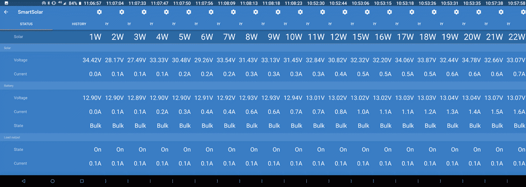

A few more screenshot figures. The battery current & load current you will need to add together for total current. Some battery figure are negative as the load was higher.
The highest wattage to date without water cooling is 126 to very occasionally into 127 watts & this was not with a perfect Sydney sky.
The other half of this entire project, almost entirely for the fridge, is reducing electricity consumption in the first place! It's about my fridge (another little project is in the wings in this department!). Reducing consumption from 0.0140 kWh to 0.0116 kWh under a 35C ambient temperature over a 3 day test (I did get it down to 0.0082 kWh but an extra 60mm of XPS insulation on the fridge was a bit thick) has more benefits than fiddling at the other end. It's easier to save than earn!
Photos: Screenshots: No water. Screenshots: Water cooling. Screenshots: 1 to 22 watts (today was a miserable day & really no break in the cloud but nevertheless the panels hit 122 watts briefly) Screenshots: 24 to 122 watts. Fridge (Waeco replacement) 6mm high mounting bracket so we can sleep in the car & not feel it. Stainless front guide for fridge. Stainless rear guide for fridge.
As I said it is about the fridge so here are a few more photos. The first photo shows the first Noctua fan (hanging) I put in the fridge, now replaced with another Noctua fan. I blew out the Outback dust from the fridge with my car's compressors. Frightening how quickly dust builds up inside the fridges compressor & makes the fridge work harder. While at it I replaced 55cm (110 cm +&- ) of under sized 12volt cable to the fridge's circuit board with 12AWG cable & installed a circuit breaker.

I have had a temporary piece of aluminium folded over the divide in the fridge to get the butter department cooler when running the fridge as a fridge. I have replaced it with a neater job! Works well, there is some sail cloth repair tape on the back of the aluminium so the evaporator coils don't get damaged. I used a 1.5mm thick baking tray as the aluminium is a bit softer (but not too solf) to bend than 5005 alloy off the shelf sheet. It will put out for cleaning both sides.
If you notice there are 2 thicknesses of 10 foam sleeping mat stuffed down inside the fridge cover for additional insulation, there are 3 on the opening end, the compressor does not need it.
Hi
Screenshot 1: 11 watts.
Screenshot 2: 12 watts.
Screenshot 3: 13 watts.
Screenshot 4: 115 watts.
Screenshot 5: 116 watts.

I'm not sure if the water spray was on the front or the back of the panels, it would be interesting to see if there were different results between using the two different cooling methods.
Photos:

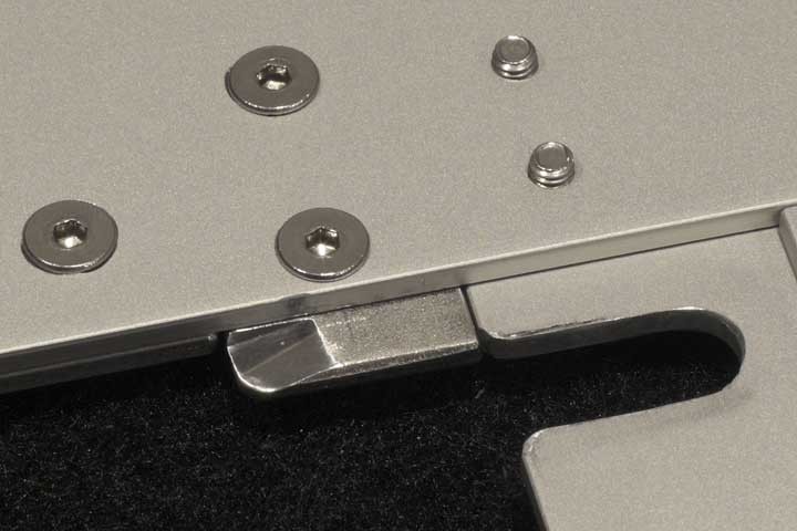

I do not wish to argue with anyone. I accept the panels are putting out a good wattage. All i wist to show, using the figures given here the difference gained by the MPPT reg. The figures are just calculated by my calculator from the actual figures shown and from the adjusted current for the second one. No discussion entered into except if there is a mistake.
If the reg was PWM and putting in the direct panel current 7.3A into the battery at 13.77V it would be 100.5Watts, as MPPT it was putting in 115.6 W (13.77 x 8.4) EG +15%
If the reg was PWM and putting in the direct panel current 7.3A into the battery at 11.96V it would be 87.3 Watts, as MPPT it was putting in 117.2 W (11.96 x 9.8) EG +34%

That second stage,PWM ,the battery charging stage, is independent of the first stage[MPPT]
But just as with all PWM controllers ,that section may interact with other,s once the battery comes out of bulk charge mode
But beware of cheap so called MPPT controllers ! . A true Mppt is not/ cannot be cheap
That will be my final post on this thread!!
So which one of you actually does know how one of these things works, Peter has often claimed the low battery voltage was what gave the MPPT controller its advantage, but now it appears he has abandoned that theory and moved on to another theory. So who is right?
T1 Terry
-- Edited by oldtrack123 on Sunday 20th of January 2019 06:16:52 PM
I think you will find you have already answered that earlier. The higher voltage gained by connecting the panels in series reduced the losses through the cable running from the solar array to the controller. A test would be to connect a single panel through the wiring used for all 6 panels direct to the battery and then measure the amps flowing. Multiply that figure by 6 to cover all the panels output with reduced resistance and that would tell you the true array output.
Another way of looking at it, the current at the panels x voltage at the panels gives the watts output, is this more or less than the output from the MPPT controller to the battery?
T1 Terry
Cant anyone post here Terry without your comments.you have knowledge so do others I personally would like to here something without your rant on the end..
-- Edited by Ron-D on Monday 21st of January 2019 04:13:03 PM
Yes, that puzzles me, too. AFAICT, an MPPT controller does not have separate hardware for MPPT and PWM modes. Instead it uses the same hardware for both modes, but switches to a different routine in the firmware. In MPPT mode the duty cycle regulates the panel's power output, whereas in "PWM mode" the duty cycle regulates the battery voltage.
