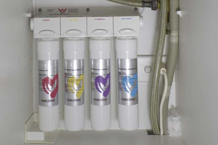

02:33 PM Nov 9, 2018
I installed a Stiebel Eltron filter at home. It is pretty easy to install, the most difficult thing is to remember to MEASURE three time which is quite challenging for us oldies! Each of the filters clips in so less mess from spilled water. Probably the most compact 4 stage filter you can get. They also do a 3 stage, without the carbon filter if you are really tight on space. The 4 replacement filters I last bought from Energy Hub in 2017 were $132 a set. I bought 3 set so I have plenty! Have been using this filter for about a decade now. The filters swing forward for easier clipping in and out for easier replacement!
Not to forget with chlorine once it has gone it's gone. You need to keep adding small regular amounts to keep everything under control.
Chlorine is NOT a once in and forget!
Peter_n_Margaret said
06:10 PM Nov 9, 2018
The carbon is the most important one of all. The sediment filter usually put in front of the carbon is simply to give more life to the carbon filter by removing some of the bigger crud before it gets to the carbon and blocks it up.

Yes, I think a water filtration system is worth it.
I fitted a single cartridge "Stefani" undersink 10" filtration system (from Bunnings) to the Dens kitchen sink. Comes complete and easy to fit. Need to drill hole in corner of sink to fit the supplied tap. Connects to existing cold water line under sink between "John Guest" and flexible mixer tap connector. Stefani supply a 5 micron carbon filter which I replaced with a 0.5 micron filter cartridge bought on Ebay (seller was "watercircle").
I use an in line hose carbon filter (sediment filter) when filling tanks or connected to mains, like most in the Playground do.
During the Dens annual hibernation time I fill the tanks and add 2 tablespoons of diluted granular pool chlorine to each tank, let it settle for a couple of days, open the drains and flush the tanks. Use this water on the garden so no wastage.
Result, clear and odourless sweet tasting water when travelling.
