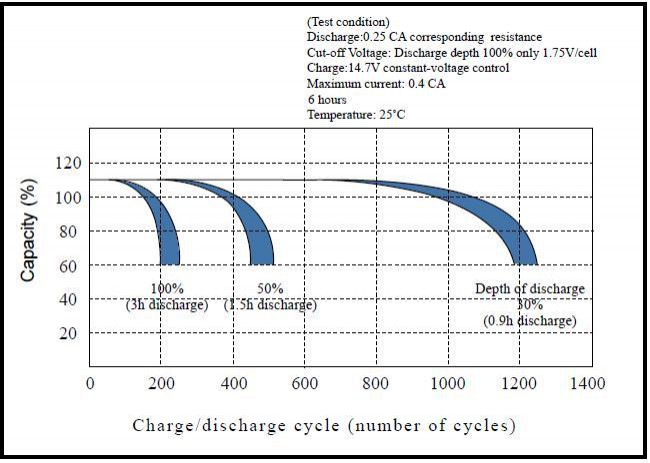

It is not an urban myth.
Look at the curve for "Cycle Life in Relation to Depth of Discharge"

They are not linear functions Peter. Neither in area under the curve for discharged energy nor in the ratio of depth of discharge to number of cycles.

The Ritar chart that you linked to clearly shows that at constant 100% discharge that the life is 300+ cycles (equals about 300 x 100Ah = 30,000Ah for a 100Ah battery).
It also shows that at 50% discharge that the life cycle is 600+ cycles (equals about 600 x 50Ah = 30,000Ah for a 100Ah battery).
The life of this 100Ah battery is about 30,000Ah total power delivered.
Yes, there is a small reduction for constant deep discharging, but it is marginal and suggesting that just the cycle count on its own represents the battery life is simply misleading in the extreme. The difference in life between 100% DOD and 50% DOD is likely 10 or 15%, not the half that the cycle count alone suggests.
The conclusion is that the considerations for how deeply to discharge on a regular basis are influenced by --- weight of batteries, $ invested each time they are replaced, how often they are replaced and the reserve storage required, NOT total power delivered life.
Other manufactures show data that is consistent with this.
Sure, but what does it mean? What is the total life in Wh (or Ah if that is easier) between 50% and 100% DOD?
I suggest that it supports my previous statement..... The difference in life between 100% DOD and 50% DOD is likely 10 or 15%, not the half that the cycle count alone suggests.

So we are comparing apples with apples I'll use a Full River chart that shows the cycle life for a battery charged and discharged at the optimal manufacturers rate .... they wouldn't publish something that was the optimum would they
Using this chart and a 100Ah battery as a base figure to make the calculations easier, let's look at the 30% depth of discharge (DOD) graph first. The test conditions show the test load was 0.4CA, so 100Ah divided 0.4 = 25amps per hr. The 30% DOD shows the discharge was for 0.9hr x 25 amps = 22.5Ah x 1200 cycles = 27,000Ah
Now let's use the same formula for the 100% DOD graph. 25 amps x 3hrs = 75Ah (not 100Ah because Peukert has a serious effect on higher discharge rates) 75Ah x 200 cycles = 15,000Ah. 15,000/27,000 = 55%, a long way from the 10% to 15% you are suggesting Peter.
If you have factory backed graphs and logical maths that show a different result I'd love to see it Peter.

I didn't do the chart Peter, Full River batteries made that chart so it must reflect the best outcome possible, surely, why would a manufacturer publish something that made their batteries look bad?

Sorry, I didn't read Full Rivers info correctly, the charge rate was 0.4CA max. constant current then constant voltage at 14.7v and took 6 hrs to recharge after? Who knows whether it was the 30% DOD or 100% DOD, they seem to have omitted that bit of info.
The discharge rate was 0.25CA but that still equates to a 25 amp per 100Ah discharge rate. The 0.4CA actually equates to 40% or 40 amps per 100Ah capacity.
It's gets confusing when at one point the specify discharge rates as C20 or C10 which is the number of hrs taken to fully discharge the battery, then in the next graph they switch to CA which is the capacity divided by the number before the CA
http://www.ritarpower.com/upimg/201712415147457.pdf
http://www.ritarpower.com/battery/Energy%20Storage%20Battery/DC%20Series/
I suggest that you are miss-reading the graph.
A discharge to 80% (for instance) provides DOUBLE the power per cycle that a discharge to 40% provides, so you only need to have half of the discharges, so you could have 1 battery instead of 2. The choice is an economic Vs weight one. For example, buy 0ne battery every 3 rears or 2 batteries every 6 years. Same cost. Your choice.
The life of a battery is better expressed in total power in and out, rather than in cycles.

Look at the shape of the curve Peter.
We carry a 60L Trailblazer in the car sometimes. To save the battery at night, we crank up the thermostat (so it's colder) while we have power (car running) later in the afternoon + a couple of hours without & find that frozen food is still frozen in the bottom of the fridge next morning. We separate the frozen food from the unfrozen with a piece of marine carpet as recommended by the manufacturer.
I'm not certain how the two fridges compare.
T1 Terry
