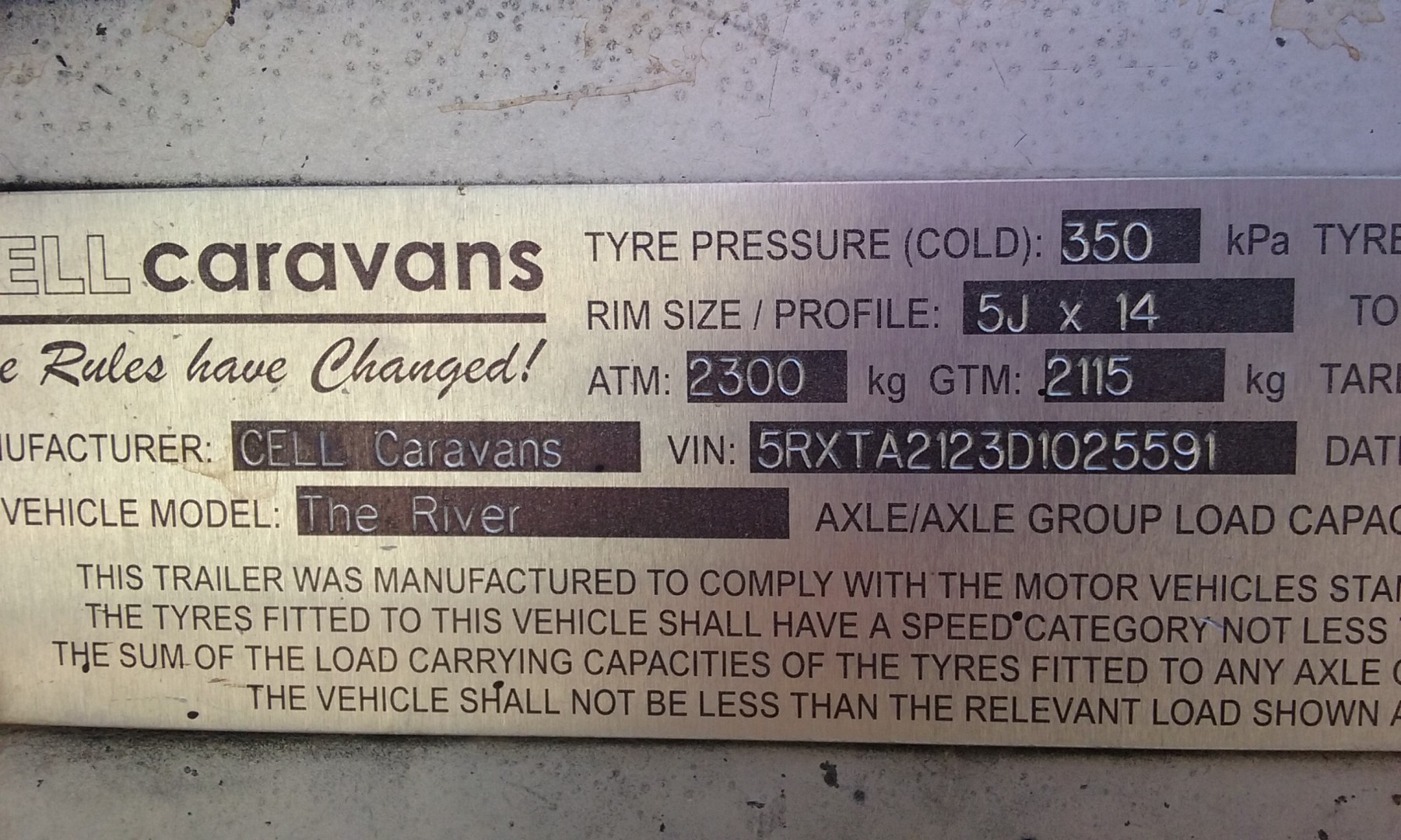

Vicki can you post a picture of the compliance plate showing all the weights.
The 180 kg ball weight you mention, is that the ball weight shown on the compliance plate.
If so it is quite likely that 180 kgs is the ball weight at tare weight (ie. the caravan is empty - no contents, water, gas)

vickiparker said
03:05 PM Aug 18, 2018
this is from the draw bar of the caravan

vickiparker said
03:33 PM Aug 18, 2018
I did post a picture of the plate did it not go through?? unless I am not doing it right, I will try again

outlaw40 said
04:25 PM Aug 18, 2018
so what was the actual ball weight. that vin plate has no max ball weight on it so you can theoretically got the max ball weight of your tow vehicle ( i guess 350kg ) though 10% of atm is a good rule of thumb to work with.
Hi Vicki.....I have not read the whole thread,so excuse me if I have taken the wrong tack,but I cant see any towball weight? I am guessing that you have simply deducted the GTM (2115kg weight on vans wheels) from the ATM (2300kg) to arrive at a figure of 185kg? This being the case,you can increase your towball weight to,say,250kg and all is good,provided your GTM stays at no more than 2050kg.If you elected to have TBM of 300kg,(assuming your car is rated to that?) your GTM simply has to be reduced to 2000kg.Problem solved? Cheers
