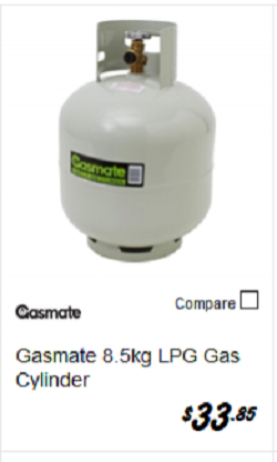

Hello Hot Water
As John (Rockylizard, and The Heaths, have already pointed out, the gas in a Recreation Vehicle, is called a different name by different people
In my home base town, in the south west of Western Australia, our local Bunnings shop, call it LPG
thanks Tony and others, much appreciate your help.
yes, i also did some searching and it seems it is exactly the same as BBQ gas (100% Propane) same as bunnings or any major petrol station refills if needed.
but i was surprised to find that it is not guaranteed to be the same composition as Automotive LPG.
Auto LPG is allowed to be blended with Butane it seems. so Auto LPG is sometimes a blend of Propane plus Butane, whereas BBQ Gas is pure 100% Propane only. so not 100% interchangeable.

Hello Hot Water
