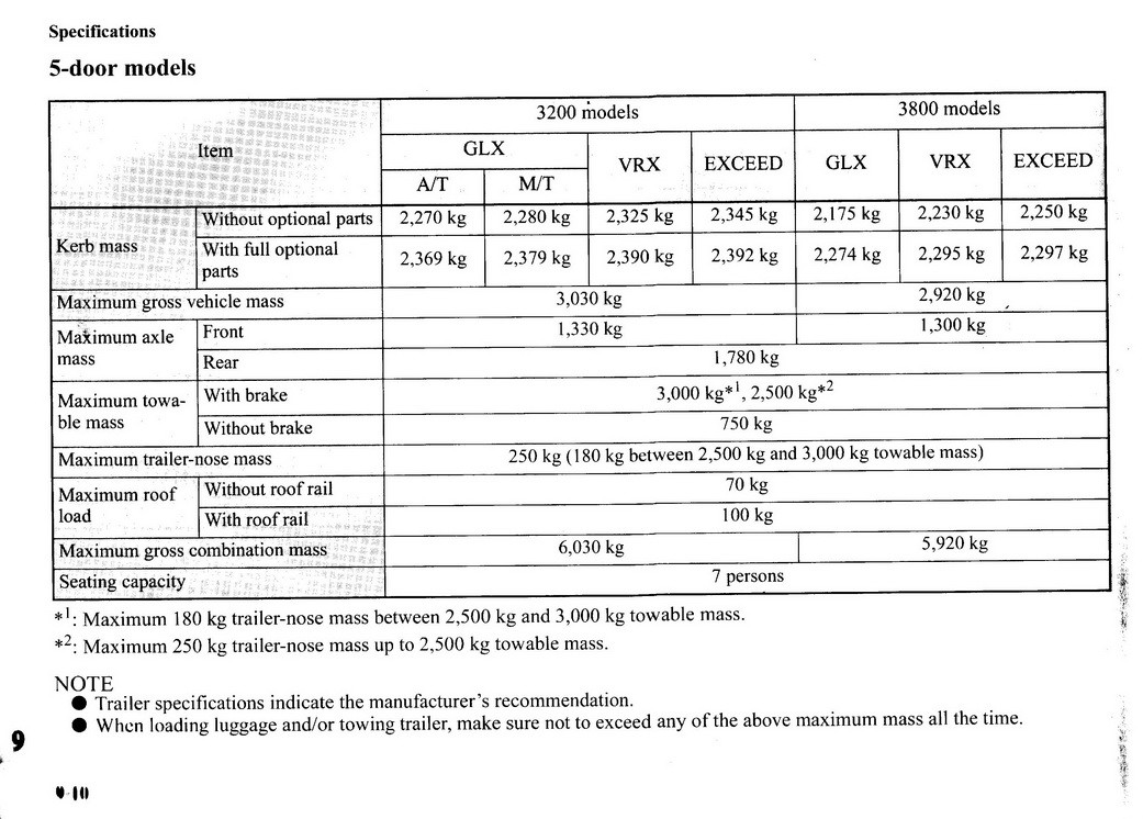

Unfortunately Mitsubishi Pajero have a very unrealistic ball rating at 250kg up to 2500kg towing and only 180kg above that.
I have not seen the actual ATM rating of your Jayco posted but in your notes your axle group rating was stated at 2900kg so I guess it's at or below that figure.
Ideally your measured ball weight should be around 10% of ATM which in your case would be around 290kg (or less depending on ATM rating).
Paul, I think the bottom line is Mitsubishi do not want you to tow more than 2500kg with the Pajero..
Probably not what you want to hear, but maybe you should look at a more suitable tow vehicle.

Could it be that the 180kg is a typo and should read 280kg on the ball?
180kg makes no sense at all.
sandgrooper1 said
01:59 PM Jan 30, 2018
Goodday OldBloke,
The information supplied by Montie in his post re the 180kg ball load limit over a 2500kg towing is correct.
Cheers AL
yobarr said
02:12 PM Jan 30, 2018
sandgrooper1 wrote:
Goodday OldBloke,
Cheers AL
Second that......and there are so many people who have not done any research,are overloaded
to the point of stupidity,and believe that it somehow is the fault of somebody else.
Towing with a Pajero is like sending a boy to do a mans job!
oldbloke said
02:23 PM Jan 30, 2018
No expert here but that is counter to all logic.
Are we all just assuming the manual is correct? Or has it been checked elsewhere?
02:38 PM Jan 30, 2018
Here ya go oldbloke ... from the horse's mouth.....
Hi Paul....Unfortunately for you,there it is in black and white. 250kg max ball weight up to 2500 ATM,
but only 180kg from 2500kg to 3000kg towable mass.
Cheers.

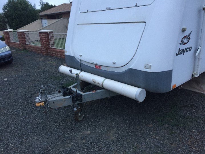

Thanks everyone. We certainly have some problems. I had no idea about this sort of stuff when we bought the van.
We were lucky that we got a floor plan that suited our needs. Not sure why we bought the Pajero, they seemed to have a reasonable record from friends, relatives etc. The first time I "roughly" weighed it there appeared not to be a major problem. Mistake!!!
When I added the 200 watt solar panel I mounted it as far back as possible, and took the anti flap gear from under the bed and put on rear bumper.
After reading the weight problems on the forum, since that time, I decided I had better get serious about weighing.
So, there begins the saga.

Thanks Chris, I use WDH BUT I have found the towing stability reducing since I have been getting heavier on the ball weight.
Last trip I had the rear water tank full and the front one empty. Certainly better. People have said the Pajero rear end is too soft, so rather than spending dollars and still struggling with weights maybe go to twin cab with canopy to house heavier stuff like gensets etc.
https://www.mitsubishi-motors.com.au/vehicles/pajero/specifications
This is taken from my Pajero manual.
-- Edited by aussie_paul on Tuesday 30th of January 2018 09:39:32 PM
