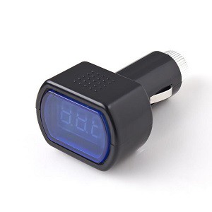

I just use a ciggy plug type el cheapo volt meter I use ciggy plugs to charge up the phone, laptop, etc, from the house batteries, so I may well as use it to get the SOG
The secret is to have no load going in, or out, of the battery for a few hours, to get an accurate reading
When I wish to know the SOC (State of Charge), I will disconnect the solar from the battery, when the sun goes down In the morning before I use any power, or reconnect the roof solar panel, I will look at the volt meter
Not all volt metres are accurate, but most are within 0.1 volt I look at the volt meter, while checking the battery volts, with a multimeter I then write the difference such as -1 or +1 on the ciggy type voltmeter This seems to work for me
I find that when the solar panels are charging the battery, I am actually looking at the voltage going in, such as 13.8 volts If I disconnect the solar panel, this will come down to the SOC of about 12.8 volts, but will take some time to do so With the solar panel disconnected, and using power from the battery, it will drop to perhaps 12.6 volts, but jump back up with the power off, but once again it takes time to do so
I am led to believe, so could be wrong, that the expensive SOG metres, calculate the volts/amps/watts used, and the volts/amps/watts going in, to give the SOG
Hope that this info is useful to someone And also hope that if I am wrong, then someone will come along, and put me right

Below is a picture of the el cheapo volt meters I use

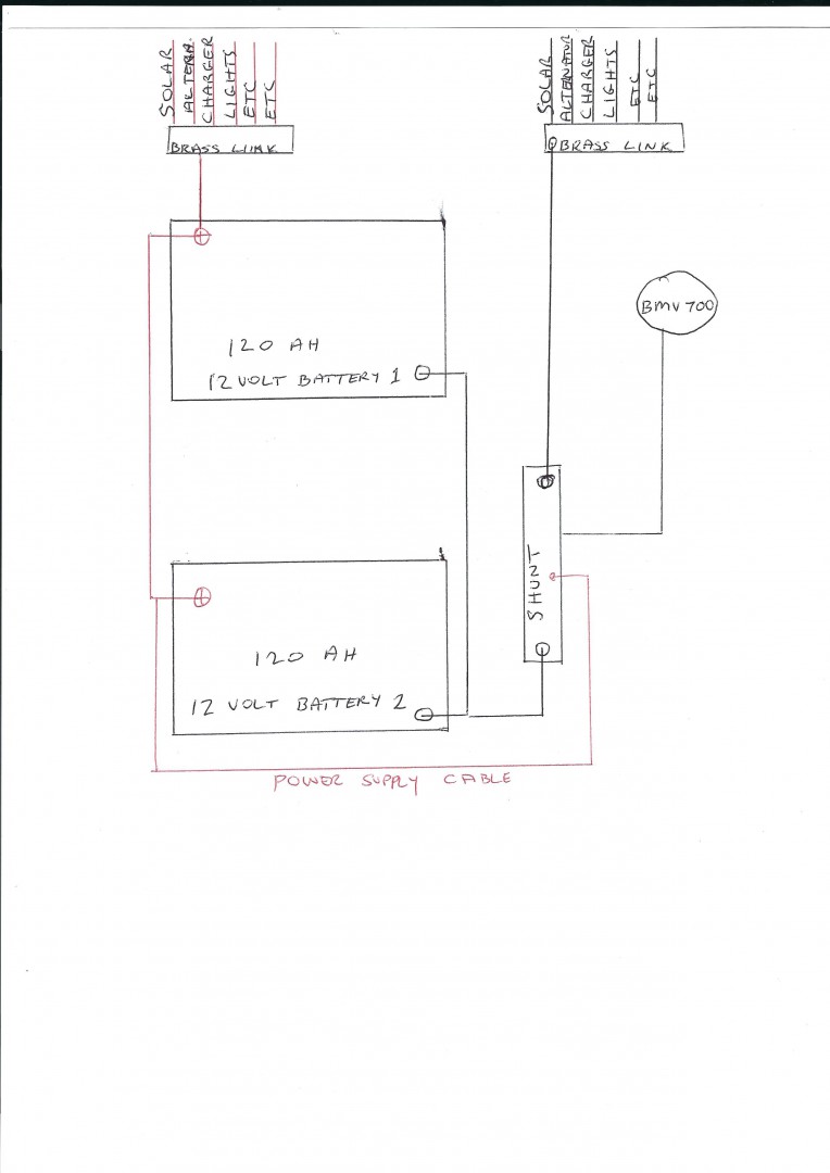

meetoo said
09:49 PM Oct 11, 2017
Righto, I have put it all together now. The attached pic that I drew up is my understanding how it should be. Please can I have some confirmation that I finally have got it right or not. Thanks.
Excellent !! If the wires between the batteries and also to the brass links and shunt are heavy enough it is perfect. Well done. You will know at last what is going on.

Below is my layman way of explaining why I use an el-cheapo volt meter
For my (and I assume for many others) situation
I do not have the expertise/equipment to place wires through a wall, and set up a battery monitor
My motorhome came with a cigar lighter type 12 volt socket
The el-cheapo volt meter, at least gives me a rubbery ball park number to crunch
I find that if the number is 12.8 or higher then I have something in the batteries
If the number is 12.2 or less, then I would have to stop using the batteries, to protect them

to answer your question re- shunts.
ALL connections to the negative terminals should go through the shunt, including the solar coming in and any alternator charging you want to do. Will involve re-wiring your batteries in this case. Also have a look at how your batteries are hooked up in parallel, as one or the other will probably be healthier as you have them now, re-wiring like this:
and I too can recommend the victron meter
In the diagram here, it shows the shunt with 2 connections. Is the top connection with the black line going upwards, (marked, battery negative system ground) where all the negative wires join to the system?
Cheers, John.
Cheers, John.
Here tis.
Cheers, John.

Thank you very much to all responders. It is a relief to have it all worked out. I am sure there will be times when it will have been worth spending a couple hundred dollars on this. The no going back hold your breath moment will be cutting off the ring terminals off all the wires to the batteries
so they will fit in the brass links. I guess there is no way around this? Thanks all.
Cheers, John.
Hi John
Depending on the size of the wires and the crimped connector you can cut the ring off and remove the plastic cover and then use the crimped end piece direct in the hole and the clamp screw will press on that. May not suit the big wires. But whatever will give a good secure connection. You can get crimp on connections which have a straight parallel 'finger' or a round reduced size 'finger' to use ínto screw connections. They make it a bit tidier and easier to undo and redo connections but are not strictly necessary.
Cheers Jaahn
Thanks Jaahn. Would never have thought of that. Was wondering how to put a small wire into a larger hole securely. Re placement of the Victron BMV700 display unit, does anybody know if you can turn off the display or does it continuously shine away all night?
Cheers, John.
