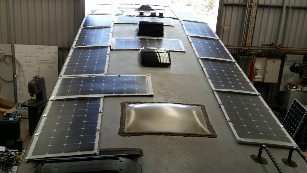

T1 Terry said
06:34 PM Jun 9, 2017
These new 200w panels are a strange one and I'm yet to test one to figure out just how they are getting the output as they use the same cells as the 100w panels but they have 32 cells yet the open circuit voltage and max output voltage are the same, but the amps are double that of the 100w panel. The length is the same as the 100w panels but the actual cell width is 500mm on the 100w panel so you would expect a 200w version to be at least 1 mtr wide.....There were some 200w panels with a Vmp of around 22v that made them useless for 24v and poor output for 12v because the Vmp was too high. It is possible these are the panels in the photo and this is where the panel size comes from, it will be interesting to see just what comes out of the box.0
As far as mounting the panels, either Lexan thermoclear or the mesh stuff they use on the pretend security flyscreen doors, don't glue the panel to any of it but mount feet with 4mm studs long enough to go through the Lexan thermoclear and the solar panel eyelets and retainers big enough to stop the panel lifting off as the eyelet holes are quite large. The aim is to not restrict the free moment of the flexible panel or the Lexan as they each expand at a different rate.
As far as keeping the panel cool.... it is more a case of stopping the heat transferring through the roof by allowing the natural air currents that will be generated to move the heat away. These panels seem to react differently to heat, the Vmp drops the same as rigid panels, but the amps go up as they heat up.
These panels can climb to over 70*C on the underside so protection between them and where they mount/lay is needed so forget about throwing them up on the awning or on the fibreglass roof, the result would not be good.

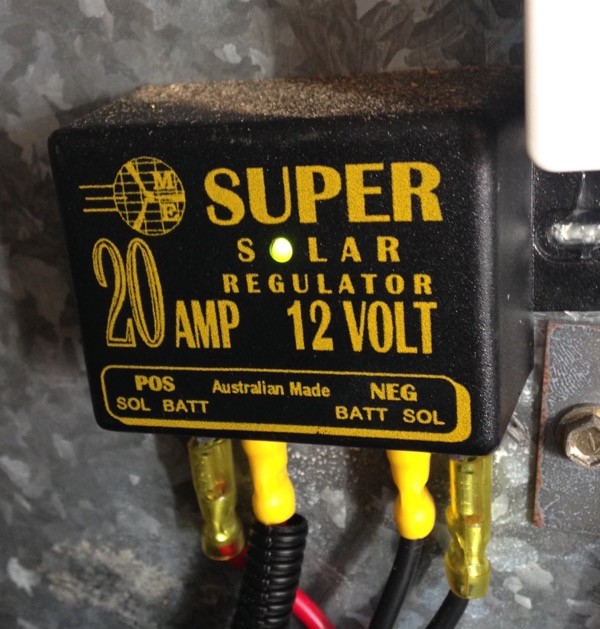

CC Bear said
02:19 PM Jul 25, 2017
I will carry on with this thread instead of starting another as it will keep the information together. I am looking for help on the flexable panel I have for the van. I intend to mount it in a similiar fashon to what Terry has suggested using aluminium rectangular section across the van and bolt through theses the thermo sheet and the panels.
So what I would like to knowis this panel ok to use As the van has a 12 v system.
This is the controller mounted near the 110 amp calcium battery and feed by a anderson plug on the A frame which will go to the solar panel on the roof.
Not with that regulator, the panel voltage is too high. You would have to use a true MPPT regulator
Jaahn said
06:39 PM Jul 25, 2017
Hi CC Bear
You know I never think tacking onto another thread is a good idea. Just start another one and there is usually much less confusion
That panel is a bit unusual as it has a higher voltage but not high enough for a 24V panel. It must have an odd number of cells ?? However it will work, but you will not get the full output ? The maximum possible will be about 120 Watts with that simple regulator. You might also like to check that that regulator will handle the 28.5 volt input too in its specs.
As Bagmaker has alluded, you will get a better result with a true MPPT regulator. This will get the best output from the panel possible. However as said in another thread there are plenty of cheap fakes . Read this other thread for more information as it has been discussed ; http://thegreynomads.activeboard.com/t63725690/can-i-use-this-panel-on-my-motorhome/

T1 Terry said
07:29 PM Jul 25, 2017
Be very careful not to link the panels in series if you do go for an MPPT controller, those panels can not handle the series voltage without blocking diodes on each panel to prevent back current frying the circuits under the cell modules themselves. Those diodes under the terminal strip are designed to allow half the panel to charge if the other half is shaded, they are not by pass diodes as such so not designed for series panel connection and certainly not blocking diodes.
These semi flexible panels are built some what differently to the rigid panels so care must be taken not to subject the panels to back current or failures can occur.
After all that, those panels may not give you great current output using a PWM controller, but they will not suffer enough voltage drop in the summer sun to cause the well known "batteries don't reach the end of boost voltage in the middle of summer" problem. This is more an issue with flooded cell batteries that need to reach 14.8v for the end of boost and 16.5v for an equalising charge, hot 12v panels with Vmp of 17v @ 25*C are struggling to get over 14.6v in the harsh summer sun.
T1 Terry
CC Bear said
08:15 PM Jul 25, 2017
Hi Terry will only be the one panel, would I need a 20 or 30 amp mppt controler
Stratman77 said
10:47 PM Jul 25, 2017
Hi, Robert! I would strongly suggest you take Terry's advice as he is really qualified in this field. Regards Chris
Jaahn said
09:26 AM Jul 26, 2017
Hi Bear
You are asking the only person on here who does not believe in MPPT controllers and actively denies they work ?? Your choice. !
I would say the 20 A one would be OK but I suggested you read the other thread I referenced for more information or you will end up with a fake unit which does not work as MPPT.
Terry I have never had a LA battery which needed "16.5v for an equalising charge". Saying such dis-information does you no good IMHO.
Jaahn
T1 Terry

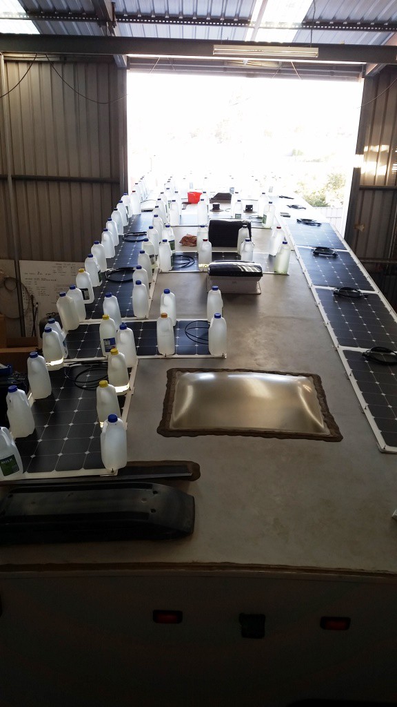

Supplying the mounts and Lexan sheet is easy enough, if you really want them drop me a PM. It does make installation easier, punch the connector pins out of the MC4 connectors, fit their mating pins to a length of 6mm auto cable twin core so you can reach the junction block on the roof, slide heat shrink over the panel cables before plugging the pins into each other and then solder a bit of the two connector pins at the join, now slip the heat shrink over to seal off the joint. This way the connection remains solid yet easy enough to disconnect later if needed and the cable fits easily inside conduit to protect it from bird attack. Use the panel to position the feet, mark the spot with a pencil, rough it up a bit so the glue has some where to bits and wash it off with plenty of metho on a rag, let it dry, apply glue to the mounting pad and place it on the roof, put the piece of Lexan in place, slip the panel over the studs and fix the retainers on top, a used plastic milk bottle full of water as a weight to hold the feet down while the glue dries and the panel is mounted. Run the cable under the next panel in line, even through the Lexan flutes as long as the joiners stay accessible and start the process again. I even over lapped the panels with the top over or under the bottom of the next panel depending on the direction of the slope and airflow to avoid making a funnel, here is a photo of one I prepared earlier

My van man extraordinaire is installing the panel right now. He was very impressed with the preliminary tests he always does before installation. We will be going on a 4 night freecamp at Bestbrook next week, so I'll let you know.

Just to let you know that the panel works very well. I was camped in partial shade with only about 2 hrs of direct sun, but it still managed to bring the aux battery back up each day. I'm pretty impressed.
Any advise would be appreciated, cheers
Jaahn
