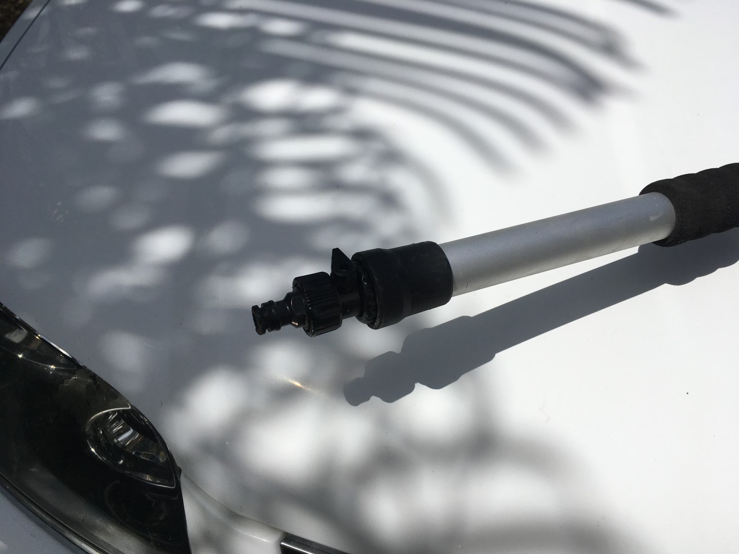

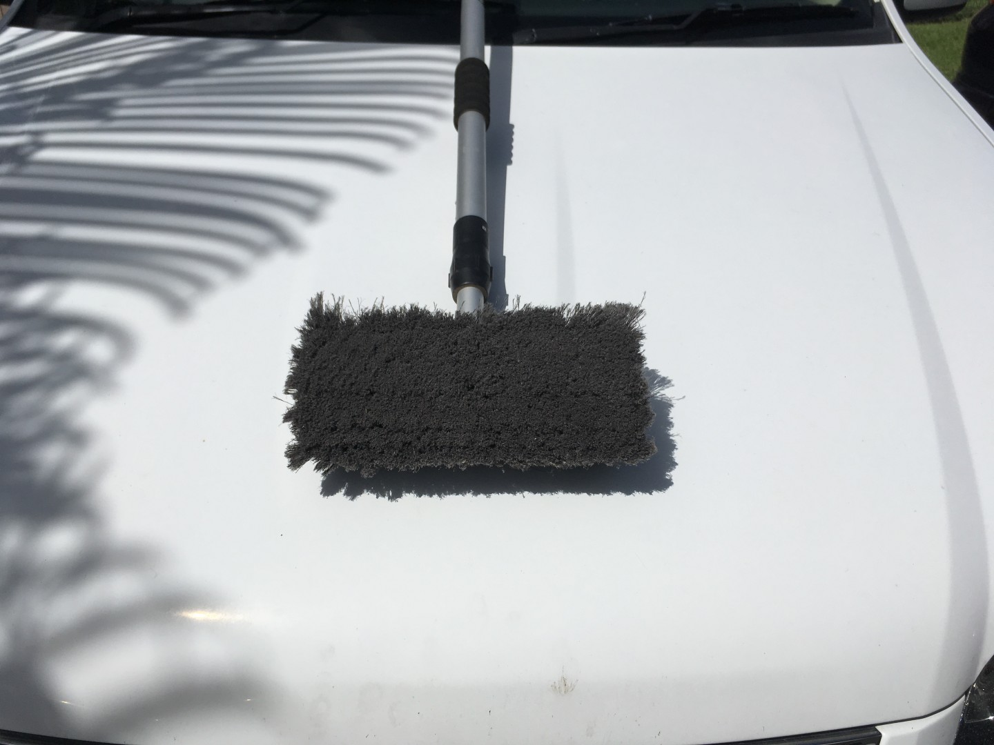

Just took a photo of the brush that is ideal for cleaning your solar panels...
Best features are a telescopic shaft, soft flock brush and a tap on the end to allow easy on/off of the water supply....
Brand is Sabco
Model - Bulldozer...
There are probably a few variations out there similar and they will all do the same job, this is my preference for the job...

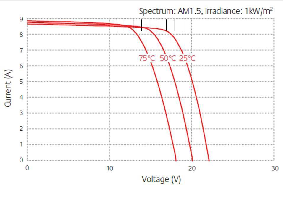

This graph from Kyocera shows the effect temp has on output
From the chart you can see that at 25*C the current output starts to drop off at roughly 17v, but at 50*C the current starts to drop off at just below 15v. If the target voltage is 14.8v before the end of bulk charging is achieved there is only a margin of 0.2v between the point were the panel simply reduces its output. At the 17v mark with the panel's internal temp at 50*C the output has dropped by 25%, so as you can see it doesn't take much resistance in the solar wiring to seriously effect the total harvest available. It is not unusual where poor cable sizing has been use to see 16v plus at the panels, the output of the panel has already started to drop off at this point, does this make the panel get even hotter? Perhaps Peter can enlighten us, he has expressed an opinion on this subject on another forum so his response will be interesting
Brand is Sabco
