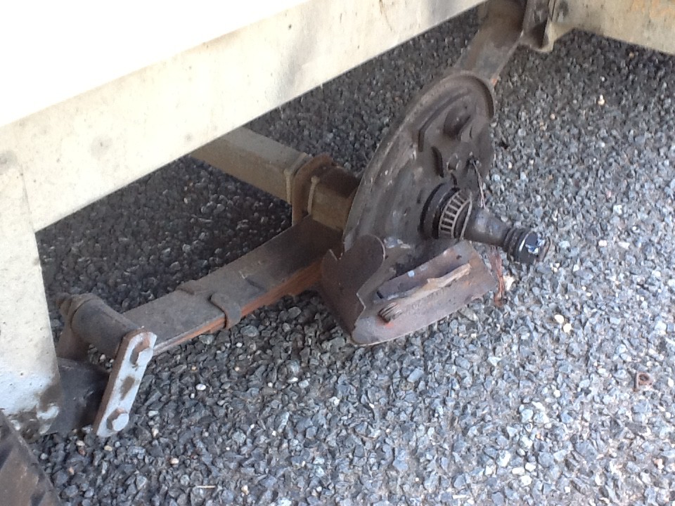

My brother lost his wheel from Jayco Sterling yesterday..**WARNING ON CHINESE WHEEL BEARINGS****
Goldfinger said
10:42 AM Jan 28, 2017
Wheel Bearings!....when they let you down, your wheel can sheer off....happened to my brother on the Junee Railway Bridge Junee' railway bridge yesterday, Friday 11.30 A.M....

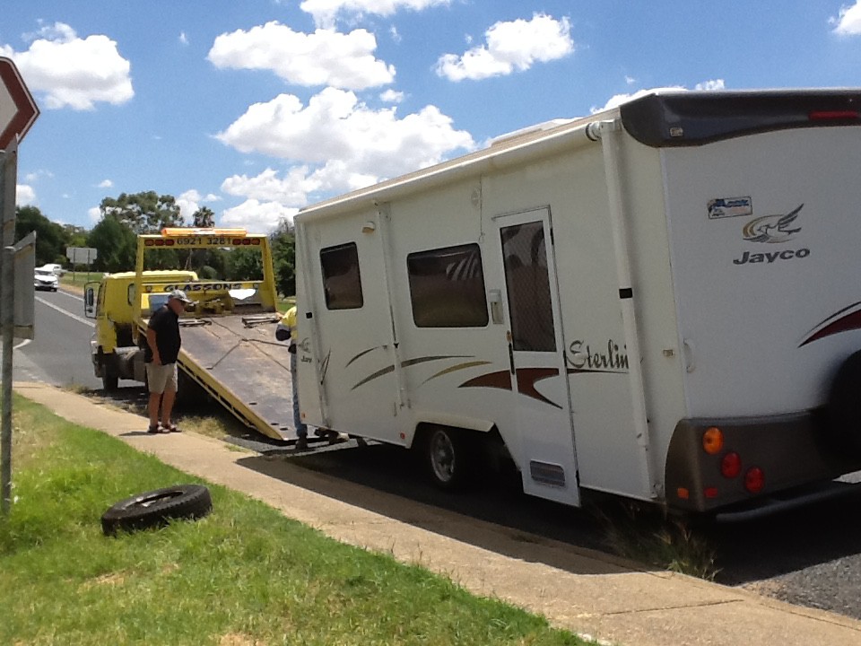

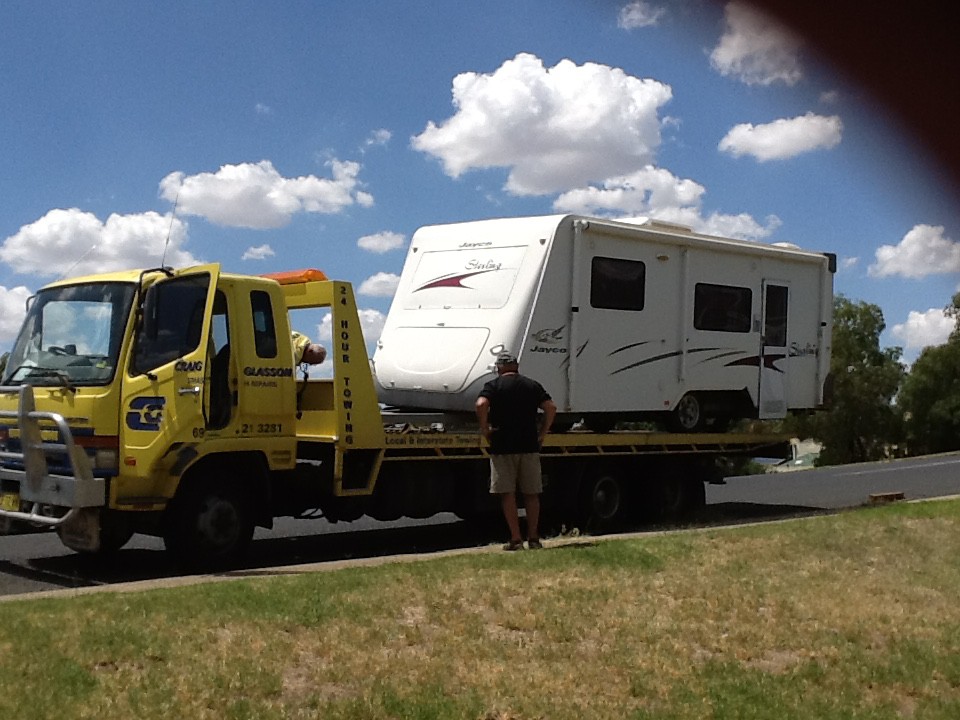

I was wondering why my brother Ray, who hails from Renmark..... had not arrived here in Bendigo...he just sent photos of the reason....apparently he had his bearings "done" in Berri S.A. before leaving for Canberra..on return he lost his wheel on his Jayco Sterling..every caravanners' concern lurking in our minds, every time we feel our wheels for heat/abnormality at stops..
Now been towed to Wagga and waiting for repairs...repairers believe they were overtightened when they were 'done' and wheel sheared off.....
My brother has 'Premium Cover with RAA many years, which has reciprocal rights with NRMA... He told me it took 4 hours of requesting/ arguing yesterday to get NRMA then RAA to assist/organise tow...they were referring him to his Insurers.....wife sitting in car dehydrating in the heat, while the request then arguments continued...my brother is livid with their buck passing when all he wanted was assistance to organise, being stranded in an unfamiliar Town, Junee... and there will be more to this story when he now gets it repaired in Wagga....including the 'Establishment' in Berri who recently carried out the work on the bearings...Hoo Roo

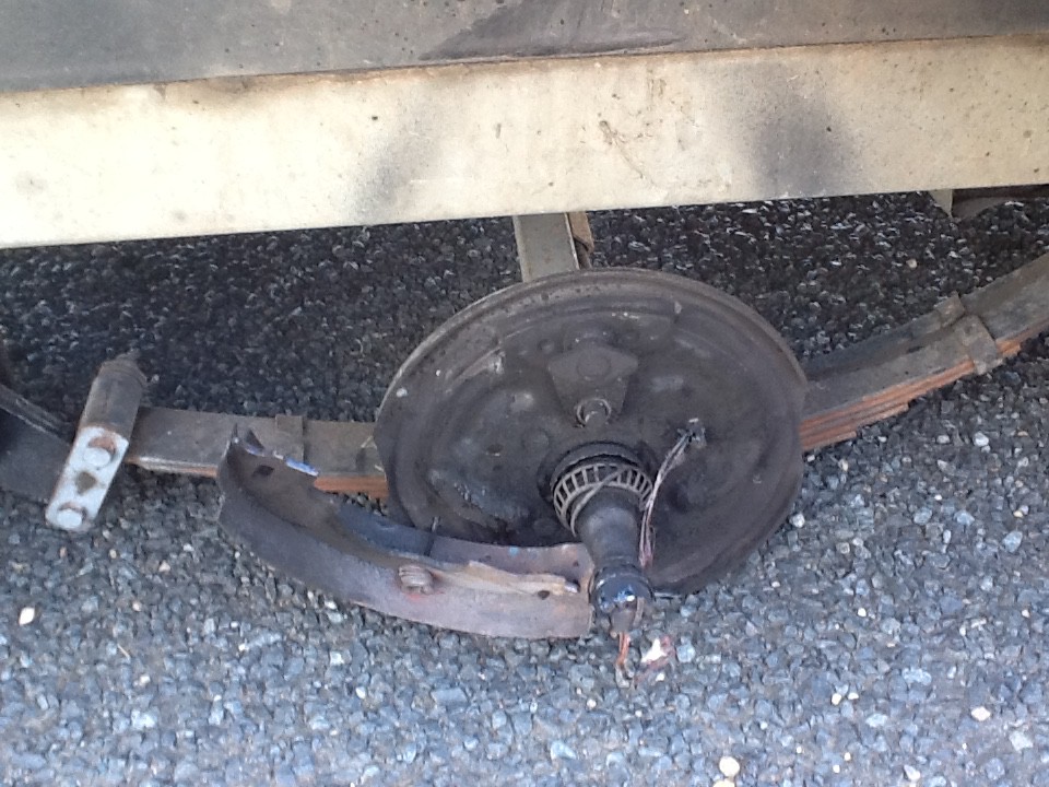

Bugger me, I have told Ray to do the bearings himself.
Yep. They would have over tightened it. How many time I have seen the same outcome.
I call it the Quickie Service.
I have just taken Stew from Marion, SA through the same procedure doing it himself, after another lot left the callus nut washer out.
Ray will need a new axle and new hub assembly for starters. When the rear bearing melts itself to the axle, you need a sizable lath to turn it.
We helped a couple a long while back 50km west of Broken Hill. It took 4hours using fine points files to seat spare Holden bearings I carry on board with our boat.
Now I carry my Ryobi 18V cordless angle grinder with both cutting and gringing disk's as part of my tool kit.

Thanks Jim and Bushpie.....I have just spoken to my brother again and he would like me to issue a warning to all Caravaners/RV's...
The head mechanic at the Wagga repair centre picked the problem in one, when my brother had his van delivered to them.....he said it was a possible death trap waiting to happen as all 4 wheels were leaking grease and the van had only travelled 900 kms since the new bearings had been fitted..
CHEAP AND NASTY CHINESE MADE BEARINGS.....DON'T FIT THEM UNDER ANY CIRCUMSTANCES....
The firm at Berri who will be named later after my brother returns to the Riverland...fitted the new bearings and charged $325 to fit etc..
The Wagga head mechanic found that inferior Chinese made bearings had been fitted at Berri....to accommodate, they had crimped around the grease cap to make them fit and then applied solastic around the caps to ""seal"" the grease....after 900 kms the solastic had melted and all grease had been extruded..no grease= no bearing.=.no wheel... upon further inspection the other 3 wheels were about to suffer the same fate..all were excruding the last of their grease...i.e. wheels likely to also shear off creating a possible death trap/roll over...
They have now carried out necessary hub repairs & fitting new quality bearings etc etc all round 4 wheels....the broken wheel arch etc can be repaired when he returns to Riverland.. All up the repairs cost $960....my brother will now get his Insurances to claim on Berri repairer for original cost...bearings/workmanship not fit for purpose intended, after only 900 kms..plus cost of flat top tow..plus cost of all repairs..plus accommodation in Wagga......might make them give greater consideration to the next bearings they fit to a trusting Caravan owner..
I believe my brother said 'Triton' or 'Titan' ? bearings were fitted/recommended by their mechanic..I may have the name incorrect as it was not a good mobile line.... Others may know of the correct name?
He's back on the road this afternoon because of a grand effort by the Wagga repairer starting early this morning....I will give them their rightful accolade when my brother gives me the go ahead..

IMHO it will not be the bearings that failed but the installation of them.

I find it amazing that anyone would mangle the grease cap & apply solastic ... unbelievable. Makes you wonder what other time bombs have left this shop if that is the standard of mechanical expertise.
I only ever use bearings stamped 'Jap'. Just over $20/wheel from memory. Every vanner aught to learn how to service wheel bearings .. such a simple job.
Lucky that it didn't cause a major crash.
edit ..
Of course as others have pointed out, over tightening can cause bearings of any make to overheat.
Is that the correct washer under the castle nut? It looks a bit narrow to me but perhaps it's my eyes or it has been bent over in the failure.
X2 for incorrectly installed. It is better to have your bearings a little loose than overtight, if they are overtight they will overheat very quickly. I have seen many times that bearings fail straight after wheel bearings have been changed. people blame the new bearings when the problem is a heavy hand tightening the nut when adjusting the bearing.

Despite what may have been inferior wheel bearings being used ... this seems to be the major cause of the failure -
".......to accommodate, they had crimped around the grease cap to make them fit and then applied solastic (silastic?) around the caps to ""seal"" the grease....after 900 kms the solastic (silastic?) had melted and all grease had been extruded..no grease= no bearing.=.no wheel... upon further inspection the other 3 wheels were about to suffer the same fate..all were excruding (extruding?) the last of their grease......"
It therefore appears it was an extraordinarily hopeless installation ... sure hope the Wagga mechanic is providing photographic and documented evidence of the workmanship (or lack or it) of the original installation to your brother so he can pursue it quickly and successfully.

Almost all bearings are, and have been for many years, made in China so that is not the problem. Neither is not fitting or incorrectly fitting a dust cap, if he stayed on the blacktop, as modern bearings are NOT meant to be flooded in grease. The rear seals and outer dust cap are only to keep muck out of the bearings.
The mistake as I see it is that the bearings were replaced. Bearings only should never be replaced as stand-alone parts (read below).
Also, I see that the inner bearing is the one showing and it has no washer protecting the missing outer bearing. I would surmise that one of three things have happened: 1. Either a washer was not fitted allowing the castle nut to abrade the bearing outer, or, 2. The castle nut was over-tightened (should only be finger tight), or, 3 The wrong bearing was used (see below).
A common mistake is to assume that looking at either the stud pattern or reading the engraving on one bearing tells you whether the axel is either Ford or Holden.
Whilst Jayco use Ford 5 stud wheels, Jayco do not use either Holden OR Ford on their overlay axels, they use what is called a composite axel. Composite axels use a Holden LM67048 bearing on the inner bearing and a Fold LM12749 bearing on the outer. (read BOTH your bearings when ordering).
An overlay axel is where the axel stub is directly welded onto a single central axel shaft. Overlay axels can also be fitted as an underlay axel by rotating the axel to gain a lift (rather than the undesirable of mounting under the leaf springs).
It is recommended (and a reputable workshop should know this) that the entire drum brake assembly be replaced when the bearings are replaced.
The reason for this is that the bearing system has three parts. 1. The axel stub, 2. The bearings, 3. The cups that are press fit into the drum.
Whilst axels are hard and unlikely to wear much, the bearing cups do wear just as much as the bearings and should always be replaced when the bearings are. As the cups are press fit into the drum, removing and replacing them successfully is beyond the scope of almost all workshops. The cost of individual parts far exceeds the cost of an entire replacement assembly.
The entire brake assembly of the backing plate, magnets, shoes, drums, bearings, cups, rear seals and outer dust caps, come as a kit for less than $200 a pair (for tandem axels of four wheels two pair are required = $400). There are only five nuts to undo to replace the entire system, the outer bearing castle nut on the axel stub and the four nuts securing the backing plate to the axel. Allowing for time to hand squeeze the grease into a bearing and the cutting and re-joining of the electric brake wires it would take no more than 5 minutes per wheel, so at the most there would be no more than 1 hours labour for a tandem overlay axel caravan.

Indeed I am. If you go just changing wheel bearings alone on a drum braked trailer or caravan you can only expect troubles.
That you and it appears many others don't know this is understandable. Most folks, even if they have a mechanical background, will have little to no experience working with trailers or caravans, but knowing what should NOT be done should be commonplace for a reputable caravan or trailer workshop that does work on drum brakes.
I would not recommend a general automotive mechanic for caravan or trailer mechanical work.
Give my regards to Ray and keep safe.
Jim
Caravans are like a harmonious orchestra until something goes wrong which can quickly/easily accelerate to further problems...have you noticed that as well?
1. The axel stub,
2. The bearings,

In 900k the hub heat should be checked a few times after service.
The bearings caused heat, the heat failed the grease, expanded the trapped air, expelled the failed grease
Then the dry outer bearing appears to have failed and the wheel walked off.
More likely the races were simply over=tightened than poor quality IMHO
(edit) or Hylife is correct, wrong bits
