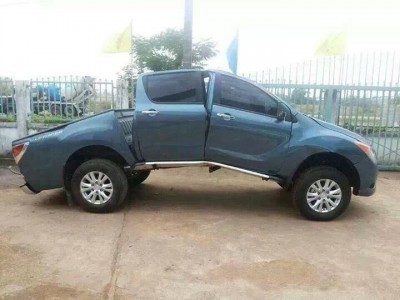

This Mazda BT50 isn't looking too good. Overloaded & too much tension on the WDH.
Whilst it is quite possible that THIS instance was caused by overloading or indiscriminate use of airbags, I very much doubt that a WDH would have caused this - or even contributed to it. Although with the 'weak/fault' point of this vehicle seemingly in the middle, airbags and overloading per se may not have caused it either.
The WDH, when fully connected up, causes the rear of the vehicle to RAISE - rather than go lower and cause the middle of the vehicle to arch upward.
A picture may be worth a thousand words ............... BUT lots left unsaid about this example. Just observing

Threw the WDH in as a joke Joyce. Just to see how many bites we got. Have no idea how this ute ended up like this.
You claim that last statement was a joke. If it was genuinely joke then it was in extremely poor taste. Newer members are likely to take things like that as fact, unless we severely admonish people like you.
Bent chassis are the result of overloading and bad driving. People quote air bags as the greatest cause of chassis bending. People firstly overload their vehicles. Then they don't like them looking down at the heel so they add air bags to pick the rear end up. They then drive over jump-ups and cattle grids without slowing and end up with a broken chassis. It was actually the overloading that started the chain of events. They should have considered reducing their loading to be within specified limits rather than modifying the suspension.
See this page -- Bent Utes - it explains things better than I can.
As far as WDH goes, it transfers weight from the rear suspension reducing the downward force that is likely to bend a chassis. It will possibly do the same ore nearly the same lift as air bags will do. There is no reason to remove it on the average gravel or natural formed roads. Just remove it when you are in severe conditions with sharp curves and dips.

Mention a WDH & all s**t breaks loose! Loosen up a little. Haven't you got a sense of humour?

Someone, somewhere said "Nah, your ute can't do that". And the answer was "You reckon? Hold my beer and watch this..."

That Mazda looks like it was dropped
and impact point being just no or behind back of drivers door?
Either that or somebody been playing with one of those "rubber" programs
the kids have. For fun.
Either way. it's a leetle seek hey.

That Mazda looks like it was dropped and impact point being just no or behind back of drivers door?
Either that or somebody been playing with one of those "rubber" programs the kids have. For fun.

Your right Macka, not a towing incedent.
Found this with the picture .... "He says that he was told by an asian friend that he had read that the vehicle had been delivered to some holding yard chained down front and rear to a flat rack.. Along came someone with a large container forklift and commenced to unload it before checking on how it was attached to the flat rack.. I guess a twenty odd tonne forklift is not going to load up before things get bent out of shape". (Not even in Australia,Thailand flag in the background)
