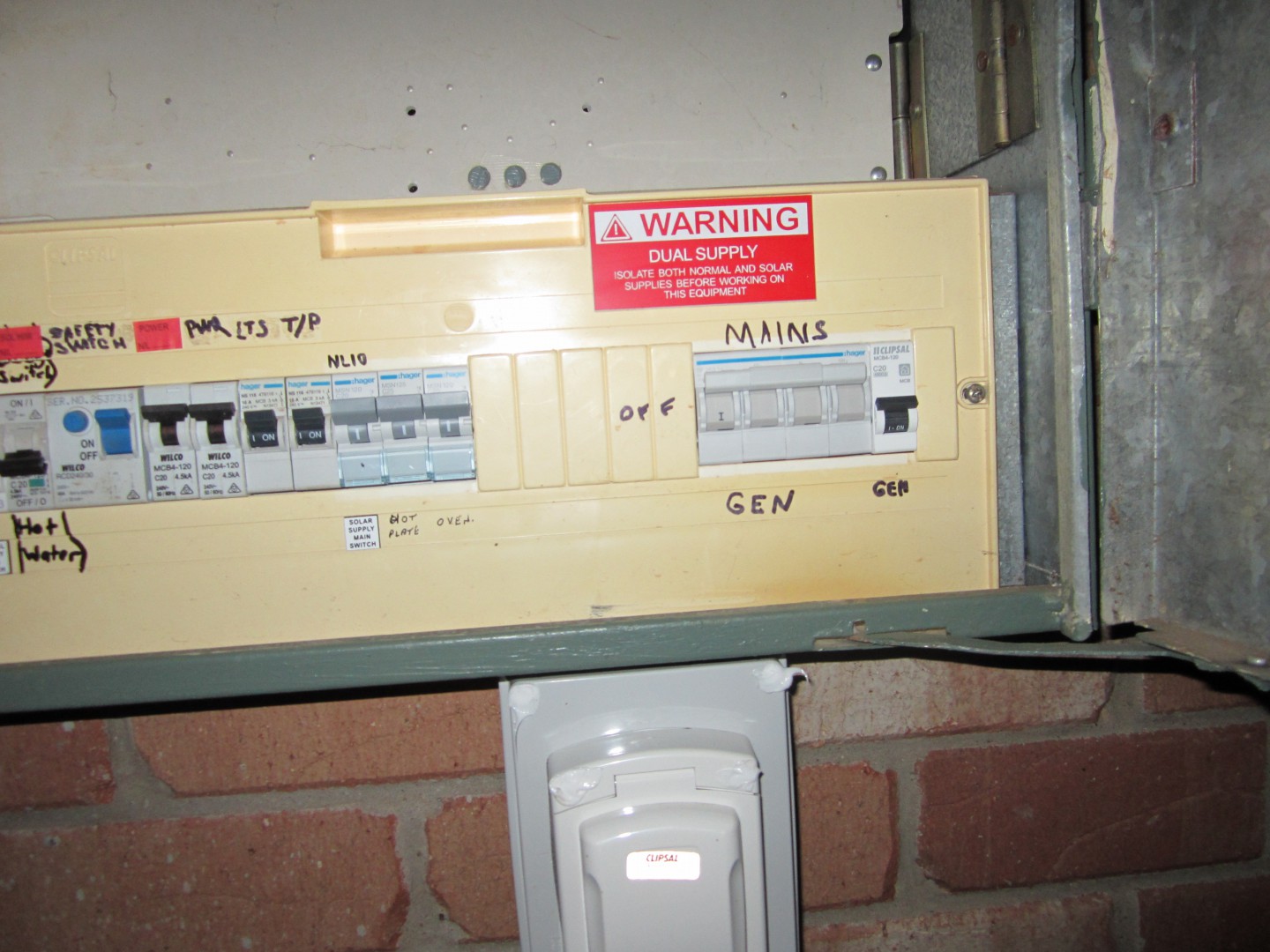

Phillipn said
10:00 PM Dec 31, 2016
We had this fitted to our house for supply to the house from the generator when their is a black out.
Power lead connected to the fitting [ like on a caravan] only operates lights and power points. Hot water, stove and oven and septic treatment plant are not connected.
Hi Phillipn, I intend to do the same to our house, as here in Victoria we will have blackouts like SA when Hazelwood is closed.

Phillipn said
04:47 PM Jan 1, 2017
aussie_paul wrote:
marto1944 wrote:
Hylife, where did you get that you cannot connect a genny to fixed wiring well how do they get emergency supply in supermarkets banks etc when they have a power failure the emergency generator starts up when the power fails and supply certain equipment but this requires special control gear and interlocking mechanisms so both supplies cannot be connected at the same time ,so phillipn with your arrangement it has no interlocking mechanism just relies on the person switching off the main switch to me its an accident waiting to happen both supplies can be on at the same time
peter
I think he means that you have to have the appropriate switches and wiring as per Phillipn.
The system we have installed was done by a licenced electrician, their is no way power from the genie can be sent to the grid. the system is totally manual, their is no power to the power points and lights when the power supply comes on until the switch is changed by me.
Operate one light, fridge and TV.

I had a sparky set up our place with a connector so I can use the genset in power outages. Its a 3 way switch that when the power is out my whole runs on it. It shuts of the solar and mains so need to check with neighbours to see if power is back. A small inconvenience to pay for full power.Once Vic closes down Hazelwood it will be crazy in these states

I had that connector installed in by house box. $100 done and dusted.
BY QUALIFIED SPARKY. with label in box to suit. (In QLD)
He's installed hundreds up here in Cyclone country.
Also have two solar systems with Inverters. Solar water heater tubes on roof.
plus pool pumps. swim jets. heaters.
That little box is bulging.Not one hole left.
