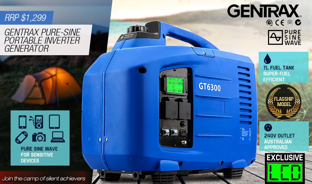

Dick0 said
08:38 PM Sep 14, 2016
You can get a GENTRAX inverter generator GT6300 on Ebay local seller, 3.7kva peak / 3.0kva rated (continuous), only $599.00.
That should take care of all your needs at a low cost.
Several things with generators:
1 Capacity: As stated above, check the ratings of your appliances and work out which ones you want toru at the same time. Then you have to start them. When you turn on an appliance, you get what is called an Inrush current. Depending on what you tuen on, eg if it is a motor say on an airconditioner, the current could be up to 5 times the draw at rated operating conditions. This could mean that you won't be able to start it. I am not saying that it won't go, but you may have trouble getting it going.
2 Wave Factor: Most generators use an inverter these days instead of a hard wired generator. Some electronic equipment is sensitive to the wave form and they need a pure sine wave to reliably operate. Some generators offer modified sine wave or even a square wave form. Check with the manuals for your equipment before you buy a generator. Try if possible to get a pure Sine Wave generator and you should have no problems.
BigDee said
07:46 AM Sep 15, 2016
Yes, have been looking at that, seems best price around.....4x4 Supa centre has a 2kva for $399 as well

I bought a 4.4 kva gentrax for same price
30 bucks for delivery anywhere in Australia

Hi can anyone with a gentrax say how noisy or quiet they would be against the honda, I have a Honda 2kva and is reasonably quiet but I want to run the a/c and be able run other things at the same time,and looking to upgrade to the honda 3kva, can the gentrax be turned on remotely?, Whenever we have camped with our generator we only used it during daylight and don't want to go into CV parks if we don't have to thanks
