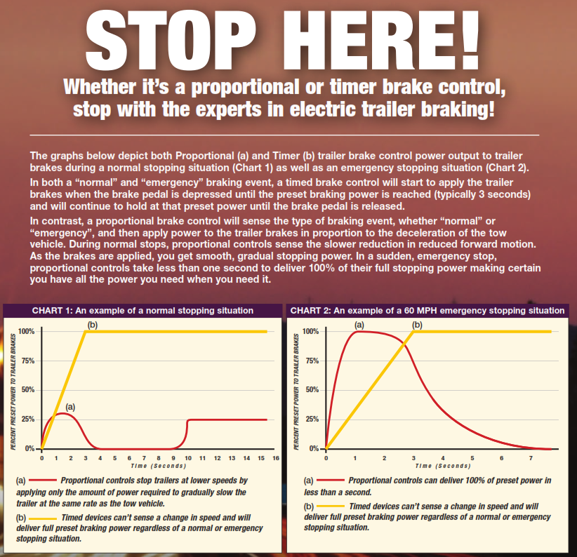

Let's get things straight about Redarc brake controllers. There is a bit of misinformation above.
There are two ranges of controller. There is a basic timer/synchroniser type that Redarc call the "User-Controlled" controllers. I would suggest steering clear of these controllers and use a proportional type.
The second range is the "Tow-Pro Range." There are two models, the Classic and the Elite. They are very similar models. They both are capable of being used in the proportional mode. There is an optional synchroniser (user controlled) mode intended for off-road use. The difference is "The Tow-Pro Elite electric brake controller features Active Calibration which constantly monitors the direction of travel removing the need for an initial calibration process, the unit will even calibrate with no trailer attached whilst maintaining the ability to mount in any orientation." The Classic model requires you to set it up instead of the active calibration.

Izabarack wrote: The Redarc User Controlled controllers are not of the misnamed, inaccurately described, Timer/Synchroniser type that were available in the USA about 30 years ago. The basic Redarc controllers are proportional controllers where the proportion of braking effort is manually set. The best clue to this process is the dial on the remote head or control box you install in a convenient place on the dash, for example. In use, the proportion of battery rail voltage to be applied to the brakes is set by the driver to suit the current circumstances and personal preferences. At low speeds, minimal braking effort is set for gentle braking and at highway speeds, a higher proportion should be set to balance the braking effort so the van does not take over the tow vehicle in an emergency stop situation. At low speeds, the tub brakes have a lot of input to the braking and slowing of the rig. At highway speeds, I don't want the weight of the van pushing the tug into a jacknife.
Iza
I don't think you know what you are talking about. What is referred to as proportional controllers are those models that have some form of deceleration detector that is used to vary the amount of power sent to operate the brakes. What you are describing as being a proportional controller is exactly how the synchroniser controllers work. They all have a control that is operated as described further down in your explanation. That control is there on all controllers whether they are synchroniser or proportional controllers. You have to reset the synchroniser controllers just like you are describing for the Redarc "user controlled" brake controllers.
You need to grasp the fact that there are two types of controller. There is the older type of controller where the braking power is set bu the "user controlled" adjuster either on the main body of the controller or a remote potentiometer. The newer style of controller has the braking power proportionally controlled automatically by some form of "deceleration detector." The only difference in the now discontinued synchroniser/timer controllers and the Redarc "user controlled" controllers is that the others had an adjustment for the ramp up time. That additional ramp up control adjusted the time it took for the time taken for the application of full brake power from nearly instantaneously to a few seconds.
A well adjusted proportional controller does not have to be reset for different road speeds and traffic conditions. You have just been describing how the "user controlled" types do. When you have a proportional controller you can not get caught out with the wrong braking power level set like you can with a "user controlled" model.
I chose to install one of the manual set proportional controllers because I can easily apply trailer brakes only, by just touching the brake pedal, sufficient to bring on the Tug brake lights as the trigger to instantly apply trailer brakes at the proportion set earlier.
The same thing happens with a proportional controller. There is always a minimum amount of brake power applied when you touch the brake pedal. You don't have to wait for the accelerometer to react before some braking is applied. You don't need maximum braking effort to bring the trailer back into line, the two ESC controllers on the market work that way, they just apply a bit of braking, not full braking.
As for the hand control being within reach, the law requires brake controllers to be mounted where they are within easy reach of the driver. All brake controllers (both types) have manual brake operating controls.
The diagram below describes the operation bof both types of controller,
