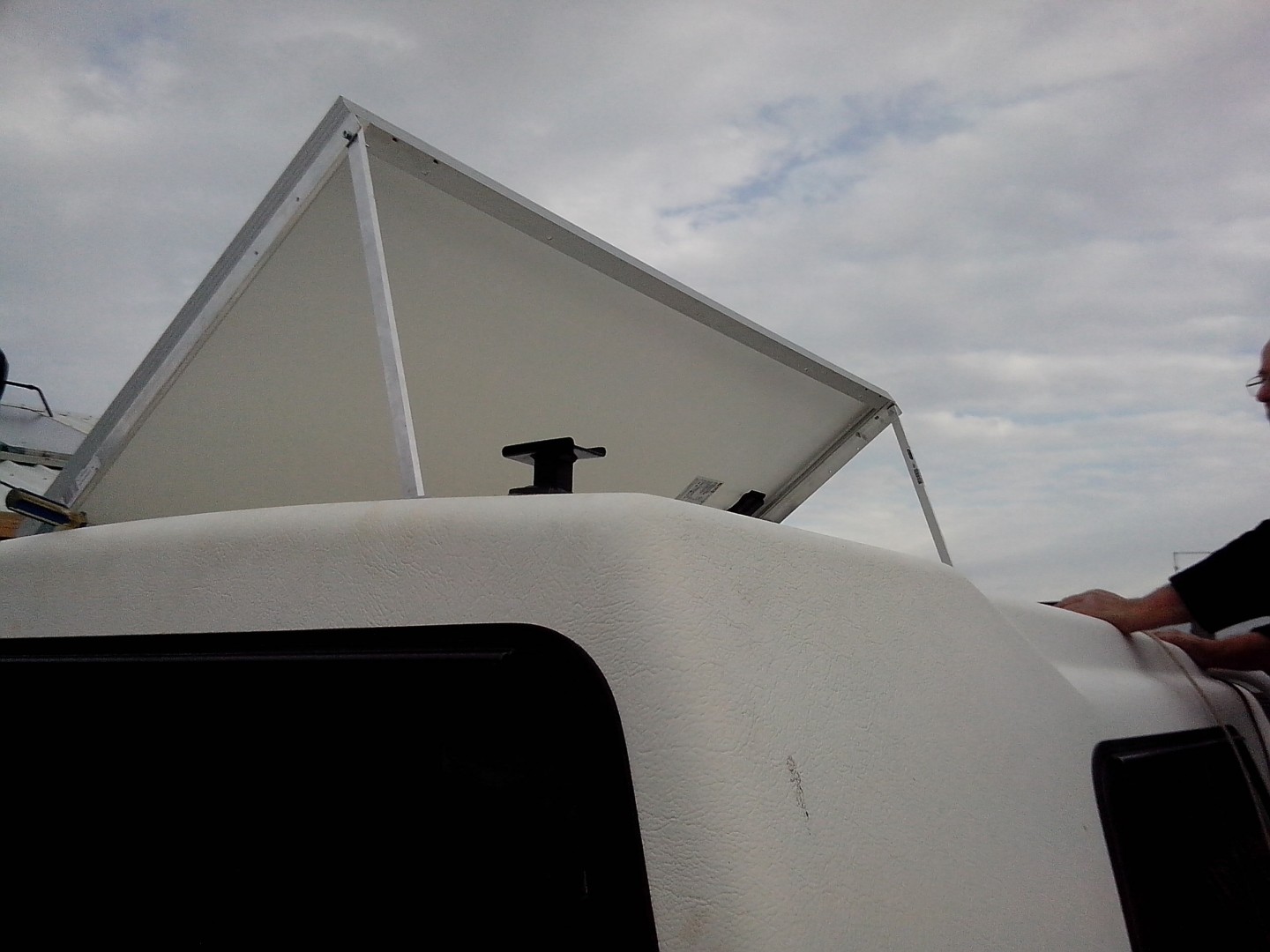

Hi. I have just returned from two weeks free camping. I have a 200w solid panel Sikaflexed to the roof using the 6 plastic mounts. I have a 105amp 12v battery that never got below 12v. Granted I did install a new diesel heater and use gas for fridge. Perfect set up for me plus no one can steal my solar panel and I don't have to stow it when leaving camp.
09:07 PM Aug 23, 2016
Although permanent panels may not be 100 % directed at sun ? They are working while sun is out and while driving . Portable solar needs to be moved every hour or so .. Often end up shaded by trees, campers etc also .. Oh yes the sun moves too ! Lol

You can always make it that way that you can stand the panels up on either side like what I did on my ute

Got a couple of these fixed permanently to the roof of a pop-top, by using angle aluminium and sikaflex from Bunnings. Adds about 30kg to van weight. Solar power through mppt controller feeding 2 x 110ah batteries. Batteries also charged from tug via Dual VSR and Anderson plugs. Batteries always fully charged by end of day journey. When camped I couldn't care less which way panels face...batteries still get charged if sunny & close to charged on duller days. Never run out of 12v supply yet.

Hi Rob, true, my panels shade the roof quite well in the heat and when free camping I can run 2 large 12v fans to move a lot of air in the cabin (pop top).
@ Mixedup
