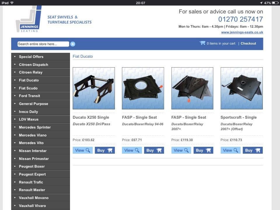

dorian said
07:58 AM Mar 5, 2016
If FIAT doesn't do the right thing by you, then there may be a solution in the aftermarket:
That was a very good find, and I am sure that it will be of interest to all future buyers of a 2015 Fiat Ducato, and I for one, thank you for taking the time to find this information
MDE I will point out that dorian has given you some ammunition
It confirms that there are two types of swivels for your model vehicle, which I have highlighted
Quote from dorian find
FASP Seat Swivel Base Plate Turntable - Fiat Ducato / Boxer / Relay 2007+ Driver Side
FASP seat swivels are designed and manufactured in two different ways in order to suit the various seats of new vehicles. The 1300 style is made with sections of welded steel which gives a very strong and heavy finish. The 1305 is a much lighter design as the thinner sheet of steel is pressed in order to give strength. The 1305 also uses ball bearings to aid a smooth swivel action. There are various level of approvals that can be gained for swivels. The swivel plate has original seat fixation points (for each model).
Unquote from durian find
I can confirm by looking at the pictures on that site that the swivel in my shed, will not fit your seat.
My swivel, (which is not on that site), has a fulcrum point central to the base, while yours is offset to the rear and drivers side. Unfortunately this means that you cannot borrow my base, while you get your own sorted.

i have attached the video (mechanical inspection) and snapshot of the different types of swivel available for pre 2007 & +2007 Which we sent to Fiat yesterday.
Our looks like the pre 2007 model though we have not had the seats off to look properly though you can clearly see the big centre hole.
Really appreciate you assistance and will pass on the info you have provided in our application to FIAT to replace these swivel fittings.

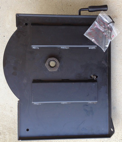

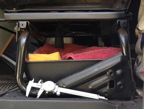

I stand corrected and thought, (if i had half a brain, I would be dangerous), when I first glanced at my swivel in the shed, at night time, I thought that the fulcrum point was in the centre.
My swivel looks similar to the one in your last picture, except that mine has reinforcement plates welded into it.
My seat base looks more robust than the one in your first picture. It is made from bent 28 mm pipe, with a reinforcement gusset, in the lower, rear corner.
To help you out, as you have a bad back, if the problem is the swivel, and not the base (the video did not turn up) you can borrow my swivel, (if it fits), until you get your own sorted
I hope that my two pictures get through

www.rainbow-conversions.co.uk/swivels.htm
Hello Dorian
Thanks Dorian and Tony
Delphine and Markus
