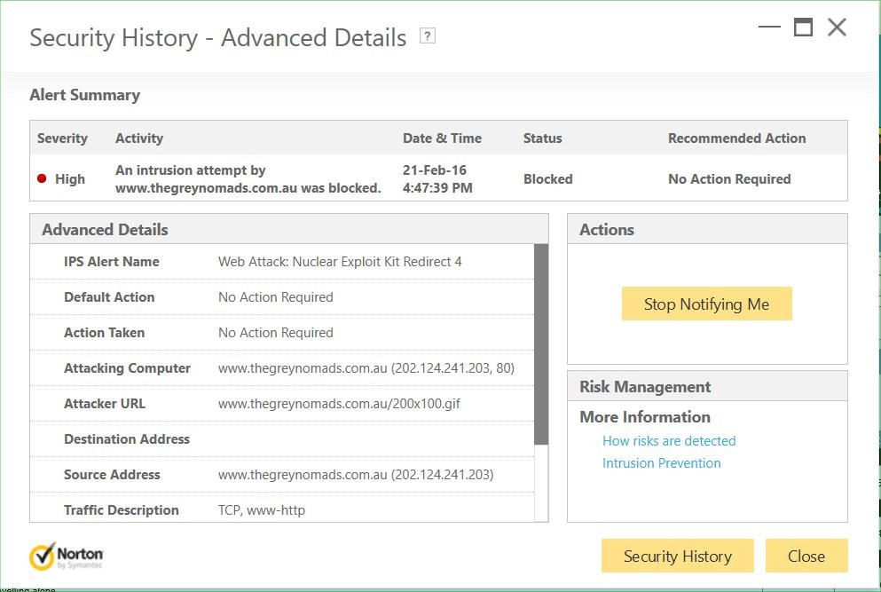

Am getting this message " Nuclear Exploit Kit Re-direct 4" from my virus checker each time I log into this site. Anyone know what it is? Apparently it is serious, but why is this site giving it to me?
Desert Dweller said
07:26 PM Feb 21, 2016
We got the same message from Norton. It seems to have gone now thank goodness.
07:35 PM Feb 21, 2016
I experienced this twice earlier this arvo whenever I returned to 'main page' after viewing a sub -forum.
Not the same as you had Ian ... and it hasn't appeared since I have been back on.
Judging that the 'source/target' of the 'virus' was the "*gif" file, I assume it was within one of the ads on the top of the forum.
[edit: had to stop the server converting the 'virus' path (of that *gif file) to an active website - which had the HTML/Framer virus still active]
-- Edited by rockylizard on Sunday 21st of February 2016 07:40:09 PM
I PM'd Cindy (Webmaster) with advice of my encounter with that 'virus'.
Unfortunately I could not insert a photo/pic into a PM so I just had to explain it.
Perhaps you should PM Cindy and explain what you have been encountering.

Unfortunately, kandagal, if you click on, or enter it into a browser, that WWW site ending in 200x100.gif you will find the 'virus' is still active.
My Virus Scanner identified it again when I accidently clicked on that WWW site before.
I have PM'd Cindy and included the link to this thread so she can see the photos/pics of Ian's and mine.

If we examine the source for the page we are looking at now, we find that the GIF file's URL is located within a DIV block whose attribute is "display:none;". I'm not a HTML programmer, but presumably this means that the problematic content is not displayed. (In Firefox select View -> Page Source.)
When we examine the "GIF" file in a text editor, we see typical HTML header information followed by a data block disguised as hexadecimal ASCII. This data block is really a block of HTML code.
This is how it appears in its encoded form (only a small excerpt at the beginning is shown):
ISTM that this block of code is a devious, convoluted mechanism for evading ad blockers in one's browser. It appears that its function is to serve up an ad, whether we like it or not.
The server's domain name resolves to an IP address of 188.166.149.17 which is owned by Digital Ocean, Inc.
Interestingly, in several Slavic languages "ogromnuezadnicu" translates as "enormous backside". Where else would ads come from?
After we get past the initial ad, the GIF/HTML file just serves up regular Grey Nomad content.
If you are one of the growing army of grey nomads discovering, or hoping to discover, the joys of the open road in this wonderful country, then this site is for you.

Thanks for your patience everyone. A specialist company has now given the site a full check over, and put in place systems to make sure we don't get this sort of incident again. Everything should now be back to working as it should be. Please drop me a line if any of you are still having any sort of issues. Thanks again for your patience.

www.virustotal.com/en/file/df0e8f049f064f614d17ae646963ac40fccd23079700c05eb99bcc71cf1d236c/analysis/1456096642/
TrendMicro and TrendMicro-HouseCall found "Mal_Hifrm-2" but all other AV software reported that the file was clean. Previously TrendMicro's online URL scanner reported that the URL was not infected.
Interesting results Dorian
Thanks.
I notice AVG scan "timed out" according to the report - wonder what that means?
However, at least AVG on my computer picked it up, cleaned it and removed it.
This is what the encoded part (7769...) looks like when it is decoded:
If we look further into this encoded block we find the URL of an ad server:
https://apps.db.ripe.net/search/query.html?form_type=simple&full_query_string=&searchtext=188.166.149.17&do_search=Search
