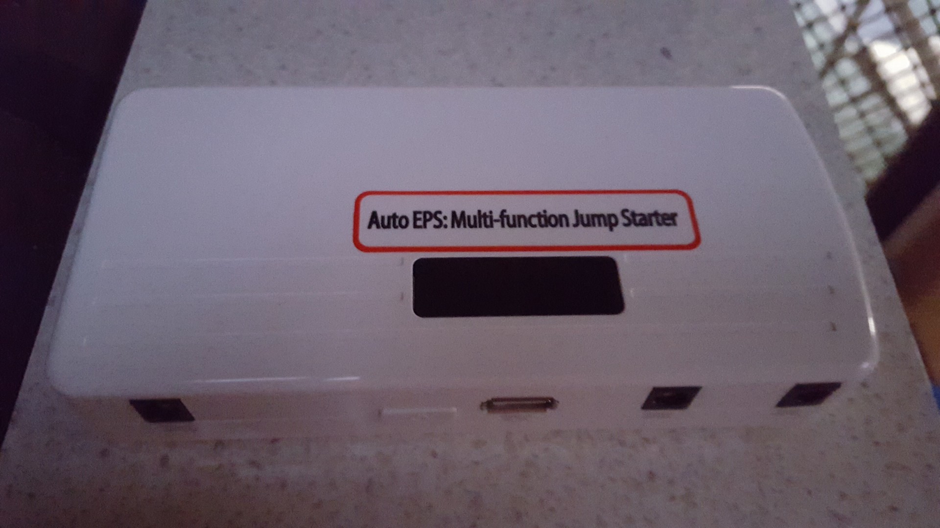

I had an occassion to try and get someone started due to a flat battery, so thought I could finally get to try a little device I got hold off last year sometime but never had the need to try it out, see pic attached.
No go, it didn't jump start the Triton Wagon, not sure of name sorry. I then tried a set if Jumper Leads but again, no go. Now those surprised me as they have always started cars when needed, they are many moons old though. The thing that surprised me again was, the leads and clips got very warm.
Two questions arise,
1. Has anyone out there got one of the jumper packs shown in pic and if so, your thoughts please. Mine are...I think I need one for a larger vehicle. Mine has Starting current..200A and Peak current 400A marked. I have heard if others with 600A. My thought is the bigger the better. I saw one on "evilbay" and said 58,000mAH, not sure what mAH means, I know AH.
I also saw on TV the other night while surfing a "minimax" jump starter. Now we all should believe what we see on TV and if so they are the bees knees in jump starters.
2. The Jumper Leads I have, as said, are many years old and I would say I need newer bigger ones, like for a truck or large 4x4.
Your thoughts on both questions will be, as usual, greatly appreciated. I have my thoughts but would like others first.

11:19 AM Feb 14, 2016
Interesting, thankyou all so far.
A little more info.
"Glenelg" Dave and myself just performed a little experiment after hearing about it. First, Dave has a little battery pack like the one on my attached pic but bigger, his starting is 300A and peak is 600A. Second, the experiment, we disconnected both the + & - cables from tug battery then connected the little battery pack to the cables, Bingo, tug started second time.
So maybe these little battery pack boosters do work but need the bigger ones.
I am now aslo looking into wiring up a regulator so I can utilise my 120w portable Solar Panel incase of being stranded in the middle of no where with a flat battery in the tug and no one to help out. Even though it will take a little while to get enough starting power, I can at least be on my way outa there and not sleeping with wild animals etc. I heard that KFC. Yes wild women might be acceptable.
This is a little project that might help others out so will keep all this together here in good old "Techies" I tried to title it so it could be found later when in the dungeon.
Keep your comments flowing.

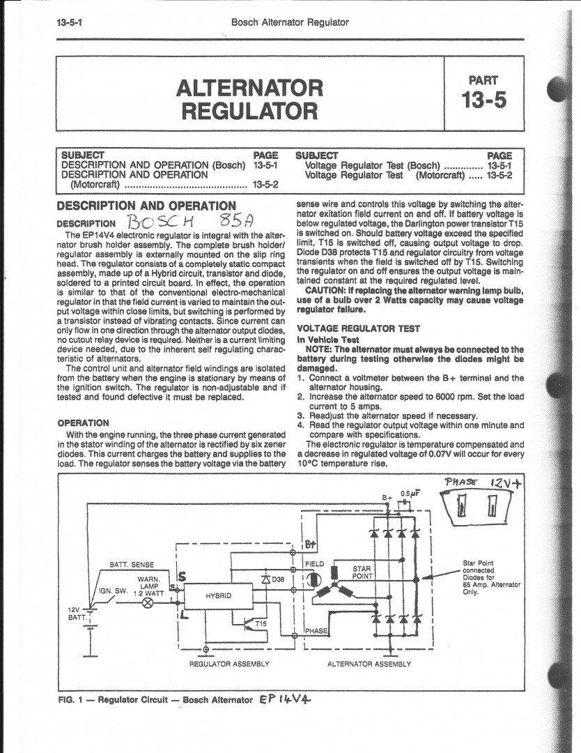

Jaahn said
06:07 PM Feb 14, 2016
Hi Alan and others,
Some years ago I was told by a "usually reliable source" who worked for Bosch that some new cars were driven out of the factory to storage fields without a battery A battery was not fitted to the cars until they were ready to be transported. This prevented battery problems from long storage etc. Cars may sit in storage for considerable times.
The technical facts. The alternators now have zenner diodes fitted instead of ordinary diodes so these dissapate any voltage spikes and transitional surges that may be caused. The regulator does control to a normal voltage anyway not excessively high as indicated. These zenners have been commonly around for 15+ years now. I do not recommend doing this just pointing out some past development in auto electrics. Also if the alternator is still connected to the cars electrical system correctly it should protect the electronics against surges and spikes.
Jaahn
PS do not test these diodes for conducting in each direction with voltages more tha
dorian said
09:16 AM Feb 15, 2016
These Chinese jump starters contain 3 (or 4?) lithium battery packs such as those used by RC car enthusiasts. The ratings are usually fictitious. However, under favourabale circumstances they do work.
Most cheapie jump starters used a small sealed Lead Acid battery - probably about 17 amp-hours capacity. You have to keep them charged or they will die on you. You find this out when you need them most. So, periodically charge up your jump starter and you may have some juice when you need it. WHich reiminds me - I should charge up mine now...
03_Troopy said
09:14 PM Feb 15, 2016
Jaahn wrote:
Hi Alan and others,
Jaahn
Zener Diodes have been around as long as diodes have. They may use a zener as a voltage clipper, on the output, to shed a higher voltage than is desirable, I've never really noticed in any schematics I've seen, but alternators still have standard rectifier diodes to rectify the 3 phase AC produced.
Jaahn said
09:22 PM Feb 15, 2016
03_Troopy wrote:
Jaahn wrote:
Hi Alan and others,
Jaahn
Hi,
You missed the point here. The main rectifier diodes are zenners.
Look at this Bosch sheet. http://apps.bosch.com.au/AAExtranet_TechSearch/docs/repairinstruction/altR11-0.pdf
Jaahn
PS the point is the protection they offer against overvoltage surges.
-- Edited by Jaahn on Monday 15th of February 2016 09:40:17 PM
-- Edited by Jaahn on Monday 15th of February 2016 09:46:04 PM
03_Troopy said
09:23 PM Feb 15, 2016
I don't see the point
The voltages would still be conducted in the forward biased opposing diodes.
-- Edited by 03_Troopy on Monday 15th of February 2016 09:24:09 PM

DeBe said
02:29 PM Feb 16, 2016
I wouldn't be keen to start a car with that Bosch altenator then disconnect the battery & drive out of a factory. Or any vehicle, heres 2 pages from a Ford workshop manual. It is the same altenator in the PDF file posted. Specificly says do not disconnect the battery with engine running. (this has the Zenner diodes in it)
Thanks for that Darryl. So the way it works is exessive voltage (above 14.4V) is clipped off the top of the waveform via the opposing reverse biased zener. That makes sense. My apologies Jaahn, I have learnt something new today.
Jaahn said
05:29 PM Feb 16, 2016
Hi Troopy, DeBe, Dougwe, and all
It was not my intention to take over the thread Dougwe, sorry 'bout that. You may use diodes or zenners or even your you-but'e mini jumpstarter however you see fit !
I also say to DeBe that I do not recommend that either. Do what the manual says. Perhaps there are some other wrinkles unknown to us mere mortals.
Troopy I say it's a bad day when you don't learn anything new !
I guess I heard that story at a trade night and learnt about the new alternator zenner diodes quite a while back and have never spoken to anyone who had heard of them. In fact some people have flatly called me a li*r on the subject. I just thought it was worth throwing it in there to counter an incorrect statement made earlier and spread the knowledge to anyone who cares to listen.
jaahn
dorian said
05:38 PM Feb 16, 2016
I confess that I've never seen zeners being used as rectifiers in alternators, or anywhere else for that matter. I learnt something in this thread. Thanks.
DeBe said
07:10 PM Feb 16, 2016
These altenators were in Falcons & Commodores back in the late 80s. But I never took mutch notice of the circuit diagram until you mentioned it Jaahn. So ive learnt something today.
DeBe said
07:14 PM Feb 16, 2016
-- Edited by DeBe on Tuesday 16th of February 2016 07:16:33 PM

mickm said
07:47 PM Feb 19, 2016
The m stands for milli or a thousand therefore 58000mAH is 58Ah. These will start a petrol car but not a 3.0 L diesel. I wanted to get one as a backup for my motorhome but was told by the seller to forget it.
Jaahn said
07:56 AM Feb 20, 2016
Hi
Correct almost. Actually a thousandth= 1/1000 However as Dorian has pointed out in that other thread the actual capacity of these devices, eg 58 Ahrs is completely ficticious. They just make the figures up. Perhaps 5.8 Ahrs would be too much even ! Who knows without testing.
The point for jump starting is that these style of lithium batteries can give out a short strong burst of current without much drop in the voltage so they do work. Perhaps some way to compare them will come along as there are lots of them now and who knows which are good and which are crap. Usual problem
The old lead acid battery types do not work as well but are much heavier and bulkier and need to be topped up more often, and a good one cost more.
Jaahn
mickm said
08:18 AM Feb 20, 2016
The topic has sparked my interest again. I see that they are now advertising 68800mAh units but the fine print, and this is a cut and paste,
2015 new upgraded high power Car Jump Starter.
It can start car with gasoline displacement up to 4.0L and diesel engine up to 2.5L. Your great assistant and it's a needments in summer holidays!
Diesels up to 2.5 L so no good for most.

Hi Alan and others,
Jaahn

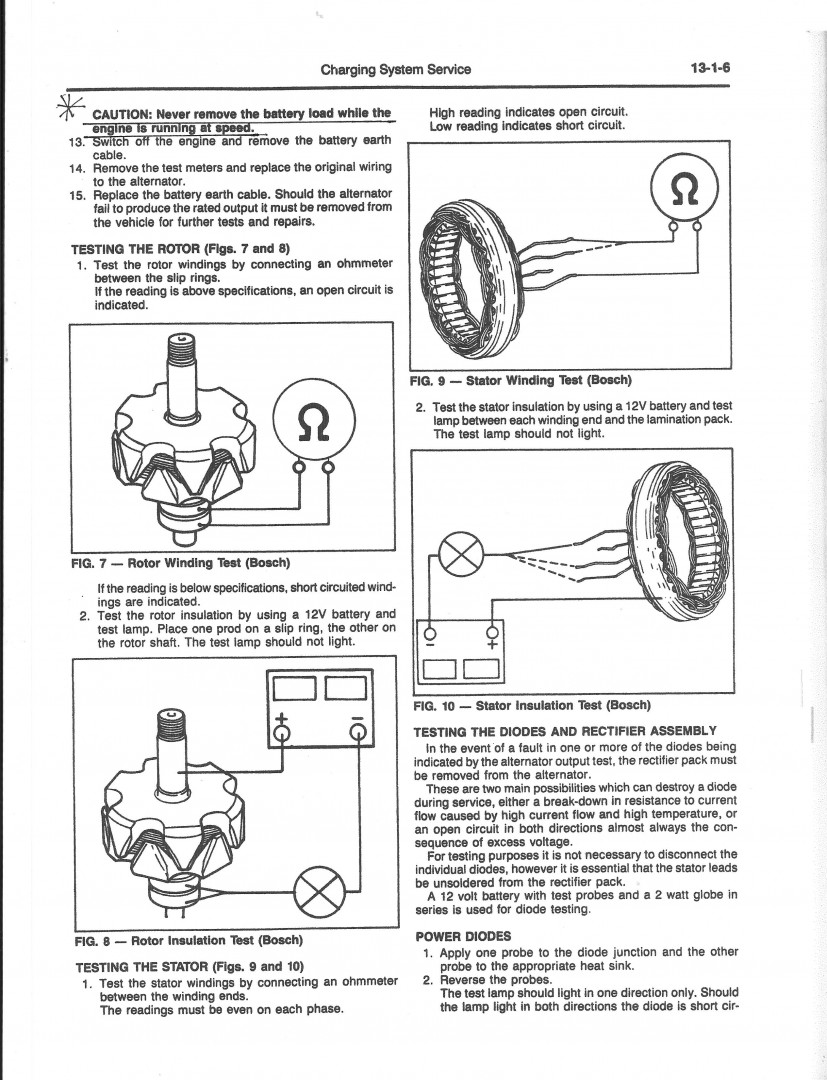

See thegreynomads.activeboard.com/t61144684/portable-power-jump-starters/
Hi,
Jaahn
Hi
Jaahn
Picky picky picky.
Yes you are correct the milli does mean 1/1000 but in common language it also references 1000 eg millipede, the famous Mille Miglia is a 1000 miles race, we make reference to us being in the third millennium etc, etc
Picky, picky, picky
Dougwe asked the question about mAh in this context.
Have a nice day.
Quickly, as I said above, a little experiment took place and worked. Not saying it will work on every vehicle but worked on a Izuzu Dmax.
