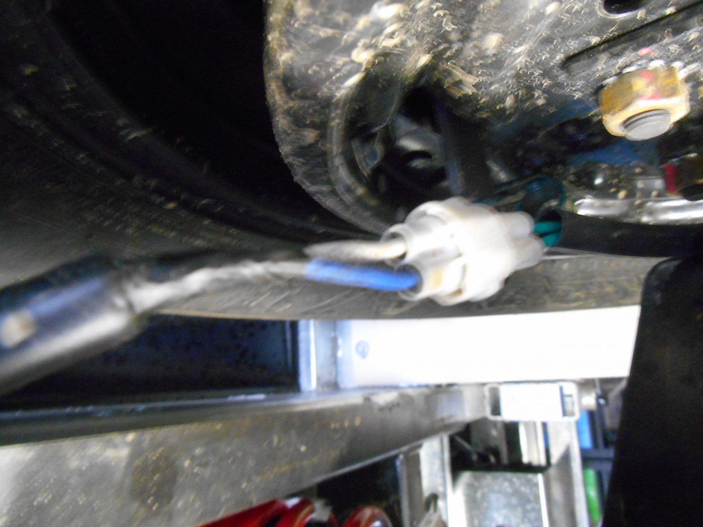

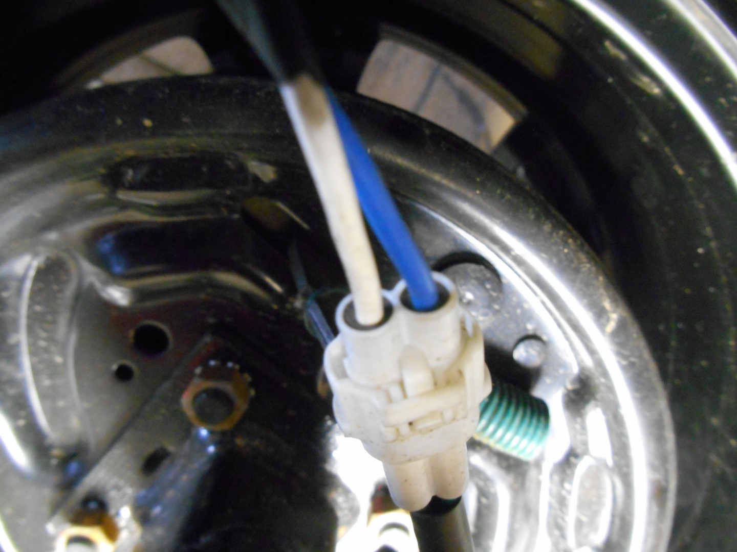

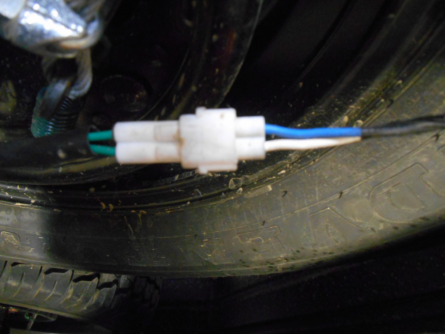

To be honest Jim I don't see the problem - just about every van I've seen has a similar arrangement. How do you think the wiring should be arranged?
Dave
09:33 PM Dec 29, 2015
I guess aesthetically it could be in conduit sheathing and supported a little better ? The white wire could be supported by the blue and both supported by yellow ? The connectors could be better quality ? cant see if there's any resin or seal in wire connection ..
Hey Jim said
09:50 PM Dec 29, 2015
Hi Dave,
With respect. Sealed much the same as any motor vehicle on our roads.
As for vans the wiring should be in flex condute and taped and fixed with a margin for wheel travel where possible, (The Photo's don't do it justice) to protect all from flying stones as much as possible for one thing.
Get a small branch between one tyre and the frame and its all over red rover on your electric brakes. We had Hydrulic override brakes on the camper. Traveling at 60-70kmph it soon rips the hell out of unprotected wiring. You can't see dust covered sticks on these roads that we have been on. You will only find out when it to late.
I don't know if you do much, or any driving up in the North west, or any of our unsealed outback roads. We do offen.
The first trip we did in 2008 stripped out and then shorted out both our camper and car twice, till I fixed it myself.@ $500 per fix back then through an auto electrician, it soon adds up.
Happy travels Jim

Hey Jim said
10:06 PM Dec 29, 2015
This Van will be getting a Stone stomper fitted before we go on and ungradered roads for a start. to protect our investment.
Jim

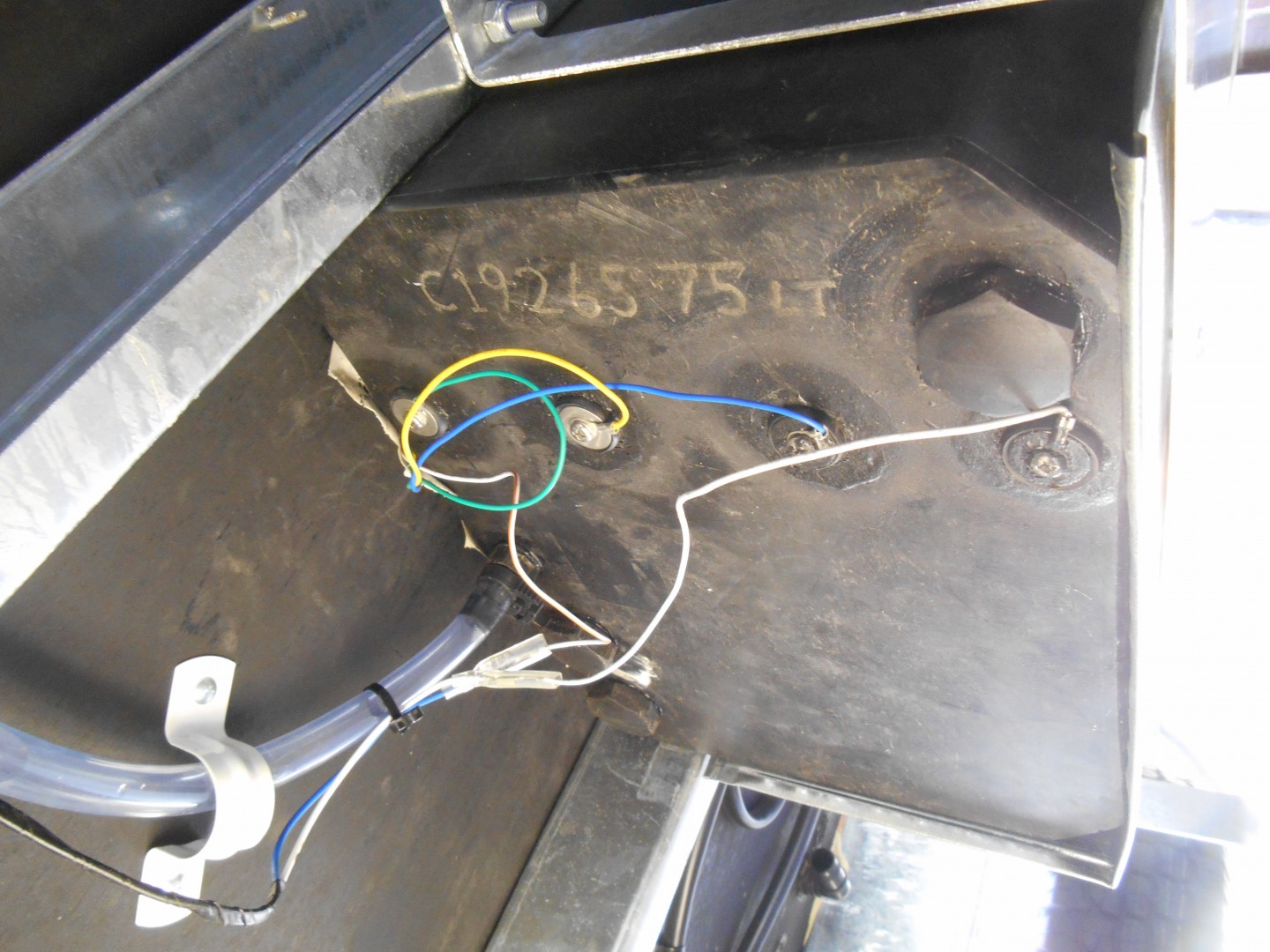

Hello Jim My 2010 Jayco Sterling looks similar underneath the water tank sensor wires and joins on the tank after 5 years are rusty but besides that they still work. Although when the tanks are empty they still show 1 or 2 leds. The brakes still work I haven't done much off road.

Jim, I was a little worried that my post would appear as criticism when that wasn't intended. I am genuinely interested in how things should be. We don't do a lot of off road travel but protecting the wiring is as important to me as anything else (I don't want to be under the van at some place in the middle of wup-wup trying to get the brakes to work). The wiring you have is far better than mine which is basically 2 wires twisted and soldered together and protected by some heat shrink and this is similar to a number of other vans I have seen. So if anyone has pics of a better arrangement I'd be interested in seeing them.

I have to agree with everyone, our van and a lot of others that I have looked at are just like the photos. Saying that I do agree that the wiring should be done a lot better but what do expect from a mass produced van. I added extra flexible conduit to mine but I still have some wires hanging in the breeze. The actual brake manufactures should add protected access to the electric brakes, eg. flexible piping like a metal braided hose. Or a shield over the backing plate where your wires attach with flexible conduit from there so no wire are hanging in the breeze.

Hi Jim. Ive never crawled under our van to check the whole thing (cause I don't have a creeper like you do lol). My water tanks have bash plates on them, but they didn't have one that covered the drain taps which obviously protrude. On our first trip east, in SA, a stone few up off the main road and when we reached the CP at Ceduna, all the water was gone as the stone had snapped off the tap. It took me the best part of a day to find a bung that would fit (after paying a mechanic $50 to come to the CP and remove what was left of the tap - it had snapped off almost cleanly on the exterior side). Havent replaced the bung - I can take it out with a spanner when I drain that tank.
I agree with you though about the exposed wiring on a safety item like brakes. Maybe you could fit a light weight aluminum bash plate over it, just held in with short self tappers to stop stone/stick damage????

The brake wiring on my 1999 Jayco is not much different to yours, if anything a bit worse (just taped over screwed electrical joiners) & I have had no trouble with it after all this time & some 200,000 km. But I don't do dirt.
I do have thin metal stone guards over the water tanks with clear water pipes. I painted the water pipes black & fitted my own water level gauge.

As an ex electrician I would say they have done the minimal support for your brake setup, however I would put some neutral cure silastic over the exposed water tank level sensors, this will create both mechanical as well as electrical protection. The clear pipes pinched off by the sub-frame need re routing for sure, if you are handy with a screwdriver its probably a 10 minute job. Perhaps a visit to Bunnings and a few cable ties will strengthen the support for the brake cables if you are concerned. The connectors look OK and should serve the purpose.

Looks like a standard connection to me, pretty much like ours & all other vans that I've looked under.

IT still amazes me how so many people seem to think it's ok for theses manufactures to put out the crap they do.
How many on this post alone seem to think this rubbish is ok. Mine looks like that so its ok.
No wonder they won't change while people hand over their money no ???? asked.
Any way you look at these photos the work man ship is garbage. Would you except are new car with wires hanging down
or brake lines hanging waiting to get caught by the first bit of stuff sticking out of ground ??? No you would not. So why
accept this crap from caravan manufacturers. your paying more for a van than some cars.
Just my two cents worth.

A strip of two pice electrical conduit sikoflexed to floor or tank will hold wires much better .

The Grey water tank plumbing has an issue, and as mine was probably one of the first off the production line, the issues are yet to be ironed out, but a position change of the dump valve will fix the kink in the drain hose.
The brake wiring is OK as far as integrity is concerned, but secured on the chassis and then just dropping down to the brake unit is not something I would do. When the suspension extends to maximum, i.e. a tyre change, the wiring will take a beating. I would prefer it to be attached to and follow the "Wishbone" so there is less movement and the wires will not be strained. A mod for me to do later.
