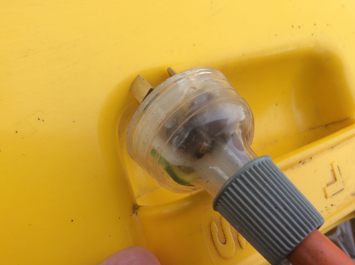

greyhoundtom said
09:17 AM Nov 15, 2015

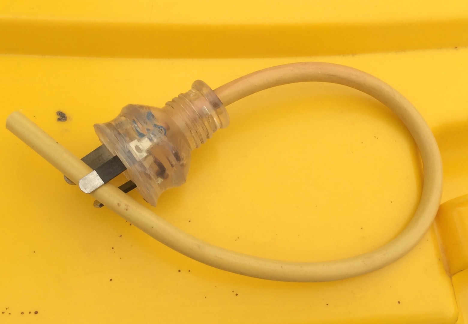

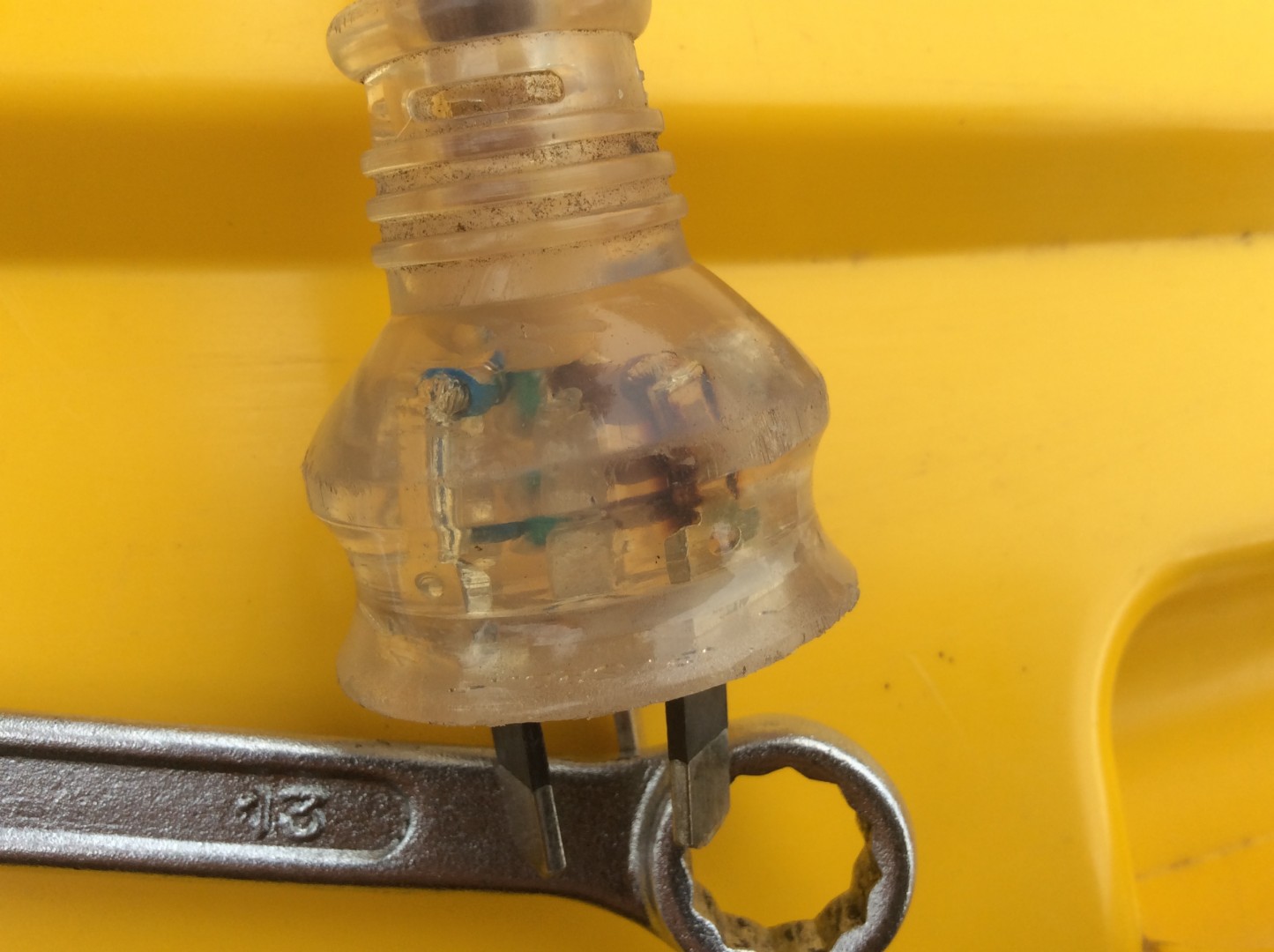

Some photos of the result with the orange cable the one being I foolishly fitted 15 amp plugs to. The yellow cable is from a dedicated 15 amp lead and on the cut bit of cable it an be seen that the insulation started to deteriorate as it is much thinner on one side, and where the cable started to go brown.
The MCB (Miniature Circuit Breaker) provides 16A overload protection.
The RCD (Residual Current Device) provides 30mA earth leakage protection.

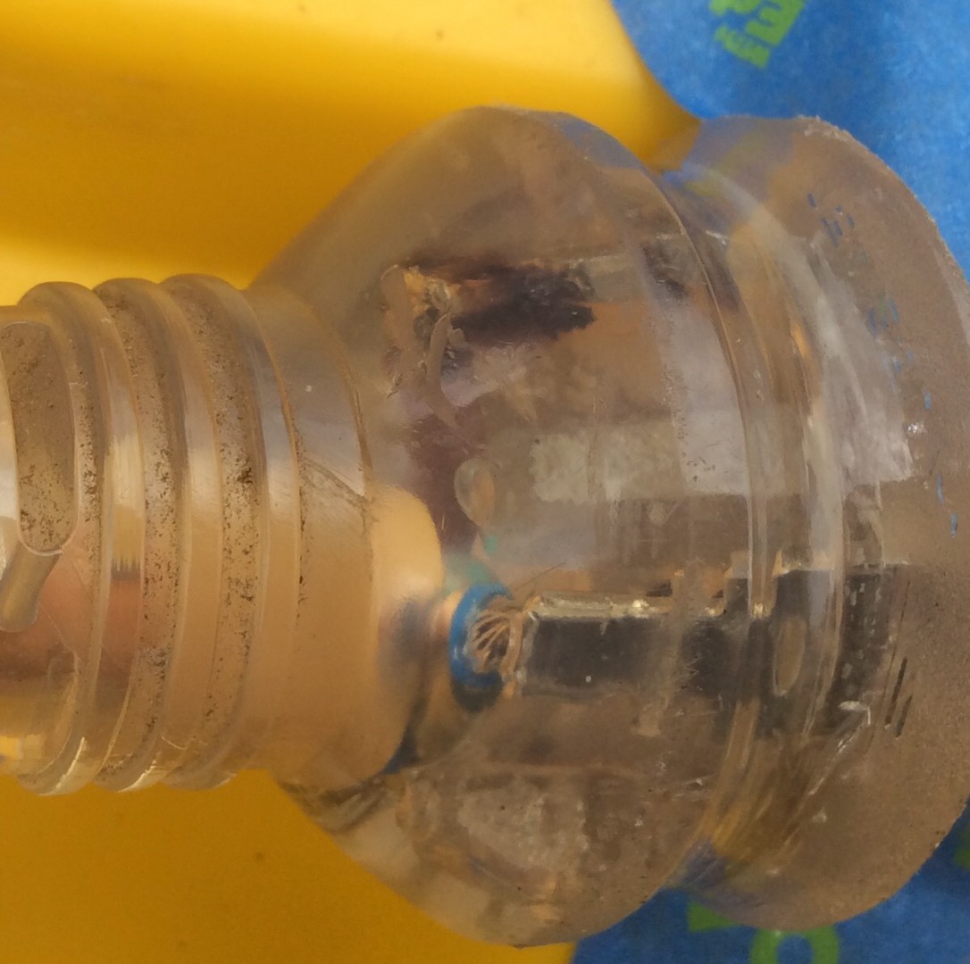

The pics of the plug on the orange lead look like high resistance joint heating at the the point where the wire connects to the plug pin, or possibly through contact resistance of the pin in a socket with loose contacts.
Roving-Dutchy said
12:33 PM Nov 15, 2015
I agree with Troopy the most likely cause is a loose connection in the plug or poor tension in the contacts in the socket in the power pole in the park. Will probably be a loose wire in the plug rather than a the socket. Then again if this happened to two different plugs at the same van park the problem is very likely in the socket in the power pole.
I know for certain that the wire was firmly and correctly fitted into the plug, however there have been a couple of situations where I have stayed at showgrounds and the plugs have been a looser fit in the power board than I would have liked.
Its highly likely that the active pin would have heated up in that situation, something else for me to keep an eye on.

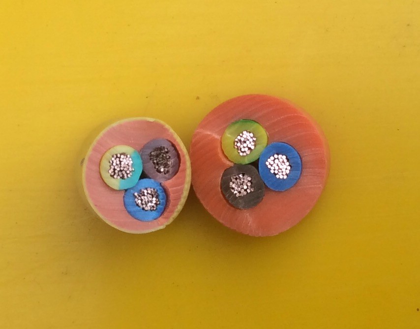

Hylife said
12:56 PM Nov 15, 2015
Visually "Greyhoundtom", based on the apparent cross-section size of the conductors I would not rate either of those two cords in your photos as safe 15 amp cords.
Whilst traditionally heavier duty cords may have an outer sheath of yellow or orange, there is no requirement as to colour. That is, a yellow or orange power cord does NOT indicate a heavy duty cord or specify a minimum safe current rating.
Worksafe Australia specifies that:-
a 10amp cord should have a minimum of 1 sq mm conductors up to 25 meters and 1.5 sq mm conductors up to 32 meters
a 15 amp cord should have a minimum of 1.5 sq mm conductors up to 25 meters and 2.5 sq mm conductors up to 42 meters
a 20 amp cord should have a minimum of 2.5 sq mm conductors up to 32 meters and 4 sq mm conductors up to 40 meters
Lots of thin strands versus a lesser amount to thick strands may make for a more flexible cord but reduces the maximum current capacities by approximately half.
Additionally, insulation colour or thickness is irrelevant. Insulation standards require 230V cords to have insulation that withstands the maximum wire current (based on cross-section size) up to 500 volts.
Increased abrasion resistance would dictate a thicker outer sheath but unless you know the properties of the material used it is unlikely to provide you with any meaningful insight as to its wear and tear capabilities.

Without knowing what the total current draw was, I would go with the reasoning of contact resistance heating causing the damage. Where the wire is discoloured in one of the pics, how far from the pin was that cross section, and how far down the cable did it extend? if it was caused by excessive current draw, I would expect it to be the same for the full length of cable.
Also, without a gauge/ruler beside the cable in the picture, it is very difficult for any of us to guess at wire sizes by looking at the pics.

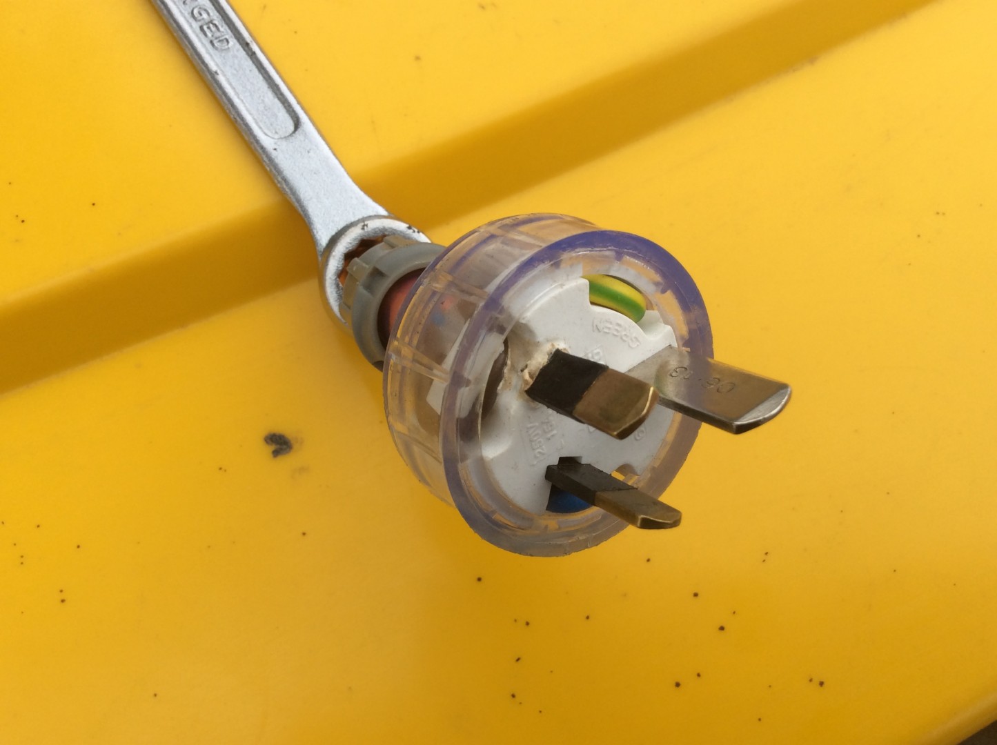

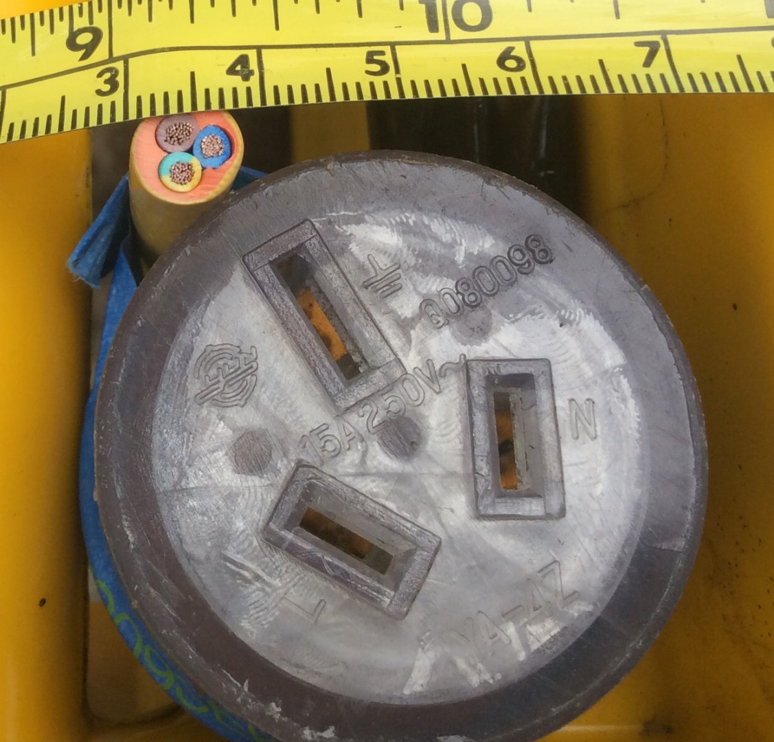

greyhoundtom said
01:56 PM Nov 15, 2015
Just another couple of photos the 15 amp cable that was also found wanting in regard to standing up to the current draw whatever it was that the MCB allowed through without triggering.
photo 2 shows the socket and a section of the wire as close to a tape measure as I could get.
photo 1 is a close up of the plug of the 15 amp cable showing the burn mark where the brown ire connects to the active pin.
While I now believe that the 15 amp power cord purchased as such from a caravan specialist is not up to the standard required, I also have no doubt that there must be other people out there unknowingly large currents through an inferior power supply cable.
-- Edited by greyhoundtom on Sunday 15th of November 2015 01:58:09 PM
To an experienced eye, each of those pics indicate a loose/ bad connection between cable & the plug pin, At the SCREW joint
THAT is obviously the origin of the heat
or just one other possibility,
WHICH pin is that worst on? , I hope not the earth pin!!
Was the cable showing any indication of overheating along it's full length"
If no sign, then IT is not a cable problem
Re cable size, 15A carrying capacity extension cable must be able carry that current, or it would be against the law to sell it!
Such cable can be as small as 1.5mm Sq & be fully approved for RV/van use up to a max length off 25M
Heavy cables are simply used to minimise voltage drop over longer lengths
Of course ,you are no doubt aware that virtually all the states ban non licensed persons from making up /modifying extension leads etc ,FOR GOOD REASONS!!
-- Edited by oldtrack123 on Sunday 15th of November 2015 02:30:11 PM
-- Edited by oldtrack123 on Sunday 15th of November 2015 02:52:11 PM
oldtrack123 said
02:48 PM Nov 15, 2015
greyhoundtom wrote:
Hi
If it was overload both or either pin would over heat, as both should be passing exactly the same current.

Hi Tom

Hi
As previous post ,the origin of the heat appears to be at the cable to pin screwed joint

IF every connection is OK there is absolutely no reason why:
[a] just one connection would heat up .[since both active & neutral carry the same current]
[ b] why the "active??? "would be the only one that heats up excessively.
[c]Is this only occurring at the park supply socket??
Does the plug /socket connection into the van show any signs of overheating??
I just noted ,in your last post that you refer to it as a "moulded" plug, yet previously you said you fitted the plug!
Which exactly is it!!
If a "moulded" plug[ factory wired], it most likely was a faulty lead , with a bad connection, broken strands of cables, at THAT point
Often due to pulling the plug out by the cable, instead of pulling the actual PLUG
The cross sections of cable do not indicate excessive overheating of the core conductors!!
You are playing with fire, & worse
I SUGGEST YOU GET AN LECTRICIAN to check out the whole set including the operation of RCD/mcbo for trip time & current.
Also, if you still have them, show him the cables & plugs.
