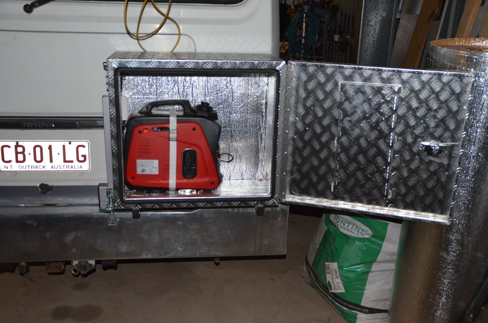

Run ours in a box on the rear bumper, two fans underneath blow air into the genset & a big fan on the LH top sucks the hot air out, has been run at full load on a 37 degree day with any issues.
Since the photo was taken foam has been added to the door, the rest of the box is lined with "Aircell" insulation.
