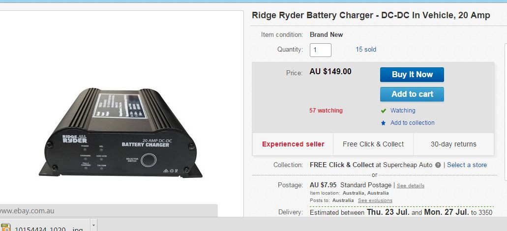

aussie_paul said
09:31 PM Jul 20, 2015
Ooooops.....
Would this be suitable to use from the tug to house batteries? I would situate it asclose to the house batteries as possible, and supply it with 6 B&S cable.
-- Edited by aussie_paul on Monday 20th of July 2015 09:45:59 PM

03_Troopy said
09:40 PM Jul 20, 2015
Having one controller for the solar and the dc to dc charging from tug should be the go. This would mean that while driving both the solar AND tug would be feeding the batteries.
-- Edited by aussie_paul on Tuesday 21st of July 2015 12:31:49 AM
03_Troopy said
07:38 AM Jul 21, 2015
Can't find any specs on that charger paul, but it is fairly cheaply priced. I used one of the redarc dc-dc chargers on my camper trailer, that also had a solar input, and that worked very well. was about $300 dearer than that one though.

Would this be suitable to use from the tug to house batteries? I would situate it as close to the house batteries as possible, and supply it with 6 B&S cable.

Then I will be waiting for a 200 watt solar panel and the DC to DC charger to arrive.
