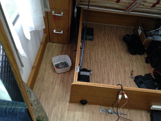

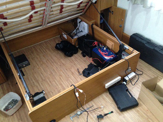

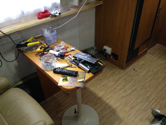

Yesterday and today I have fitted the diesel heater AND it fired up right away.. Now I just have to tidy up all the wiring, plumbing etc!!!! If I had fitted it neatly then it would not have fired up and I would have to undo my neat wiring etc. I think it is a Murphy thing with me!!
In the morning a mate is dropping me a 60mm hole saw to fit the outlet at the end of the bed.

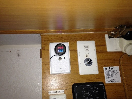

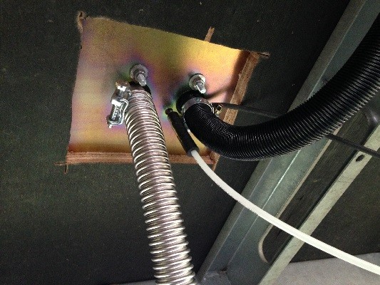

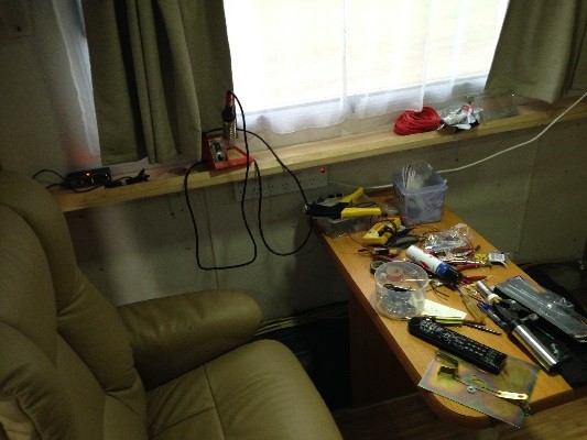

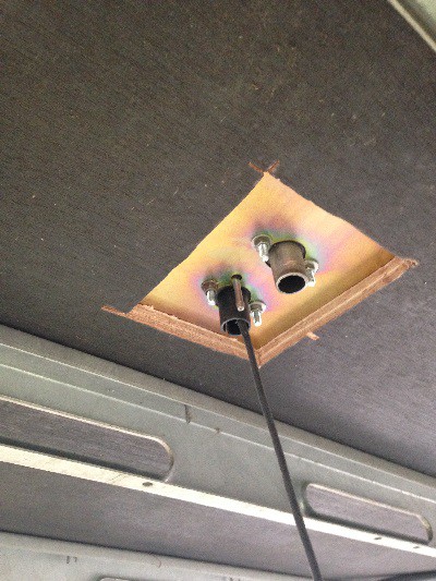

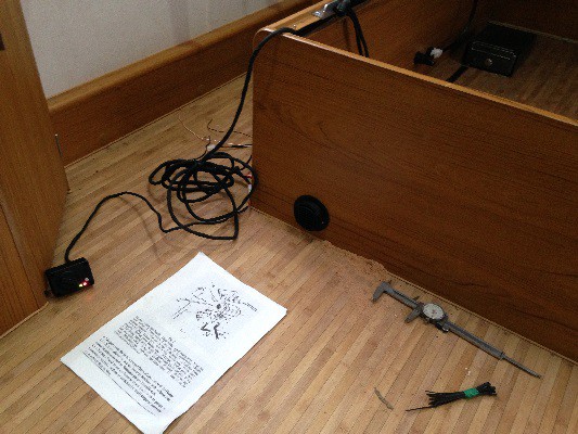

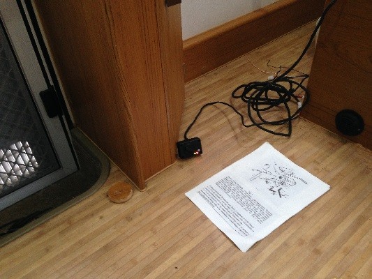

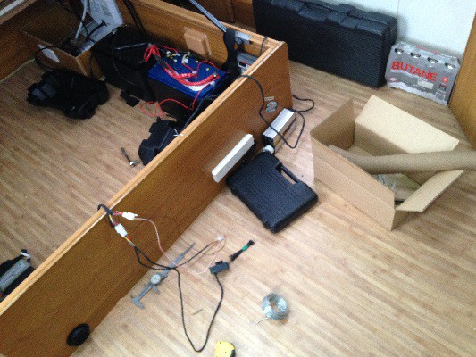

Thanks for the advice people, easier than having to find out myself. I will get some pics sorted soon.
Ok, didn't get as much done today as I hoped. Some tidying up to be done by next Wednesday when Eril and I are heading Adelaide for some business and possibly a look at some of the southern part of the Flinders Ranges. Last pic is of my voltage and temperature guage.
-- Edited by aussie_paul on Thursday 25th of June 2015 11:03:55 PM

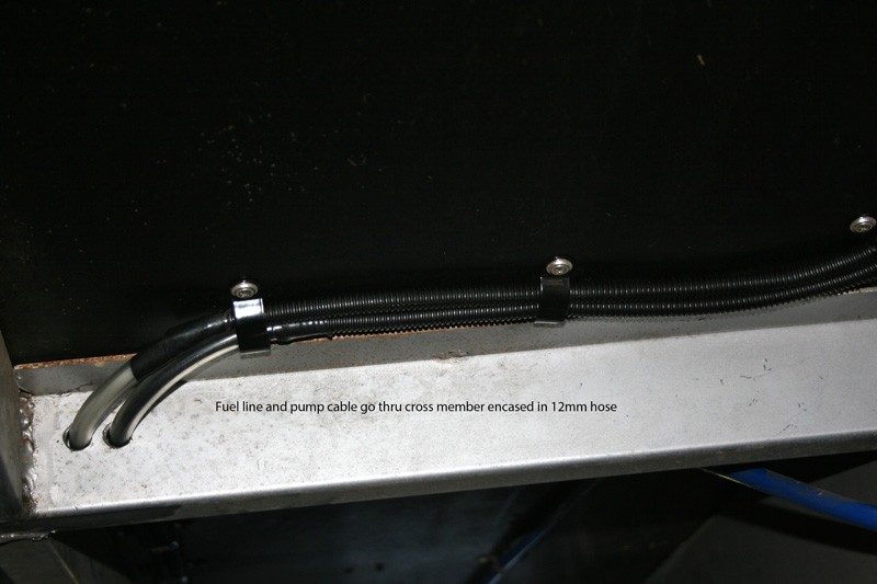

I do need a little advice. There is a wire (fuel pump wire) that exits from the inlet side of the burner, there is a slit so that the wire becomes external to the inlet hose. Do you run that wire along with the diesel fuel line, or could it be run inside the van and only have the fuel line external? The supply tank is in the front boot.
that is the wires that connect to the fuel pump try and keep the the pump somewhere where you won't here the ticking noise the pump makes eg under the floor I ran the wires clipped to the fuel line

Paul, as Dragonfly said,put the fuel pump where can't hear it ticking,in the front boot where the fuel tank is would be good.
I ran the fuel line and the wire for the pump next to each other,and put convoluted tubing around each for protection

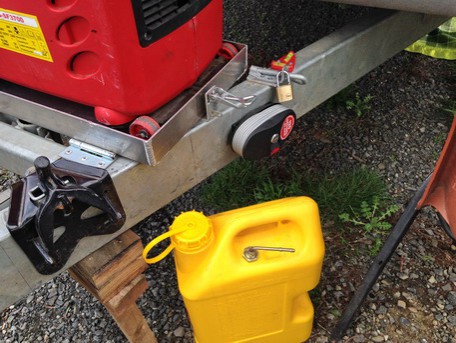

10 litres of diesel would probably last a couple of months or more and I don't reckon you need to carry any spare diesel in your boot
Dragonfly1
Dragonfly1
I was thinking that Cyril, probably use the same jerry for both jobs.

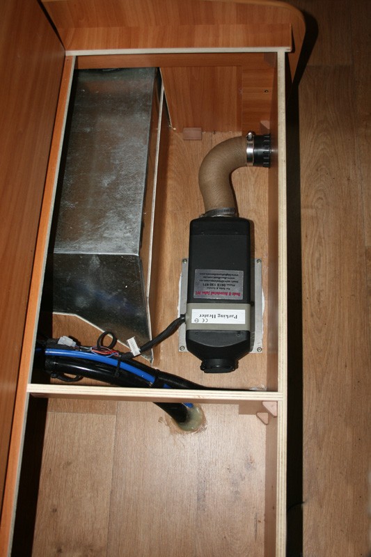

Hi Hey Jim, Regards to installation of diesel heater in a Jayco Journey if you would like to check out our installation, type in the search section (A Must Have) by Bessie. PS best addition to our van wouldn't be with out it. Regards Bessie.

Hey Jim said
11:03 PM Jun 28, 2015
Hi Bessie,
Thanks for the photo's (Must Have) Was under the bed the best option. I'm thinking of two vents for our new rig. Can't wait to add a few bits here and there. Five and a half months to go till pickup.

Hi Bessie,
How do you like your rig. Have you had any issues to date that we need to note.
Regards Jim & Lambie
Hi Hey Jim, The only problem we had with the van was the 5 months wait as well LOL as you will find out. Yes to the heater it seems to be the most practical place to install, the one vent for us is perfect, we have placed the on/off switch next to the bed light. In this position the whole unit is very easy to install. As for the van, we have so far clocked up 8000 km without any problems at all, and it tows like a dream. Very happy with our Journey Outback as i am sure you will be to. Regards Graham & Bessie.
When considering the installation position don't overlook the fact that there is a 150(??)mm dia hole to be bored through the floor of the caravan. Make sure there is no framework or piping under the floor in that chosen spot.
Cheers Neil
