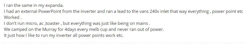

I have done this with my van in the past with a 800watt inverter
Voltage drop from inverter through the van is the biggest problem
Don't know of any reason why you cannot do it htis way

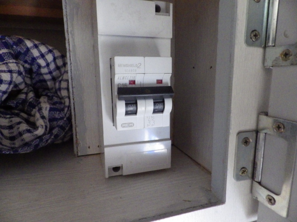

The VAN RCD /safety switch [IF one is fitted is not functional & offers no protection against shocks to earth should faults develop in the wiring or appliances/ devices
DO not think that the RCD is functional because it trips when you use the "TEST button .
That only checks the RCD itself
It does not test that the whole system is wired for correct RCD operationm

we have a rvd fitted to our motorhome which is different to a RCD and will trip if there is a problem when using a generator or a inverter

My van is a 1999 vintage & does not have an RCD. It only has a circuit breaker. I am getting an RCD fitted this week.
It would be interesting to know when fitting RCDs to vans became mandatory.
Attached photo is circuit breaker only.
Cheers Pete
Jay&Dee
