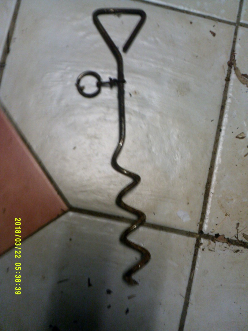

I still think the Pet Tethers already mentioned would be a much better option. They can't be just pulled straight out. You have to literally unscrew them from the ground.

They are 12x200mm grade 4.6 Galvanised ... 4 for $20 which was about the price that I expected.
The plus is that the hex head is 3/4" which is the same as my caravan corner steadies. So all I need to do is reinforce the power tool winder extension socket that I have for doing that job & I'm in business.
I am currently experimenting with a few ideas for attaching the guy rope.
I will take a photo later & attach to this or a subsequent posting.
I'll use the useless ALDI (edit) ones for holding down the annex walls .. perhaps.
After sleeping on the problem I think that I'll just revert to the large washer with a retaining blob of weld to attach the guy rope springs.
