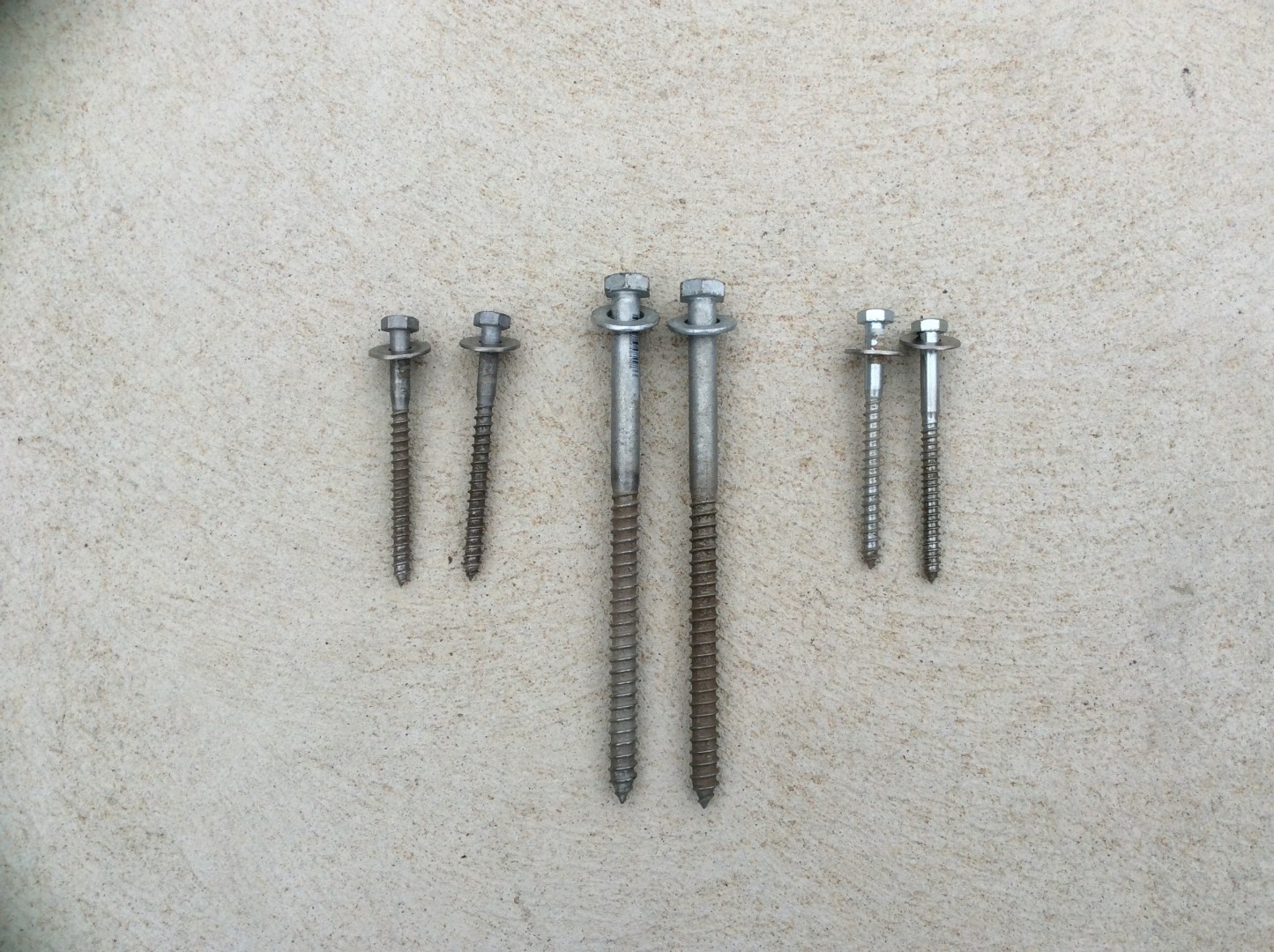

I made some up from 200mm coach screws and fitted plates and links for the Guy.
I will test them this week at Ledge Point.

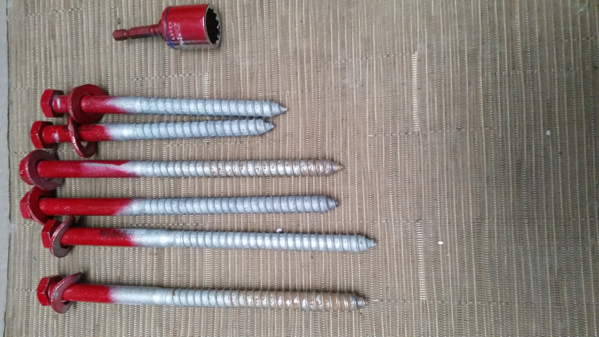

moamajohn said
02:46 PM Mar 15, 2015
Gday I have been using the 200ml jobs for 2yrs.I fitted washers on to them and then squashed the washers in the vice so as to jam them on to the shaft so they don,t fall off.Also since I,m bloody old I sprayed them red so I can see them easier.I also purchased a socket to suit and sprayed that too .They all live in harmony in an old footy sock so as not to rattle around .I also purchased an Aldi $ 79 drill and its torque has been more than adequate for the work.Plus its great for lowering and raising the 4 van stays. Cheers Westy
1. You could have at least cleaned them before you took the pic and posted it here mate This is a top rated forum you
Know.
2. Next time you paint them could you mask them so the paint is down the same length on all please
Look good though HOWEVER safety yellow next time as well mate
moamajohn said
03:30 PM Mar 15, 2015
Yeh Sorry Doug I promise to lift me game !!

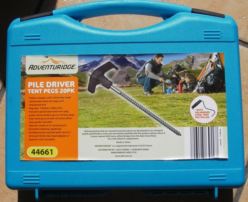

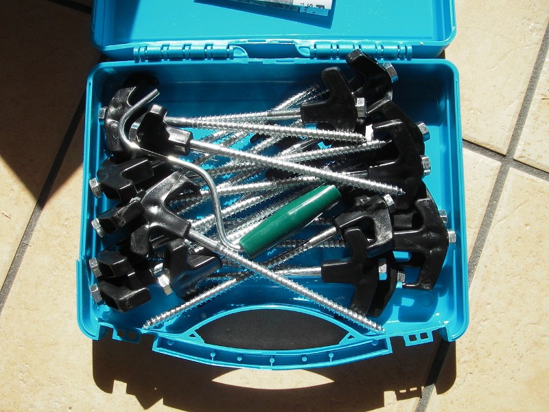

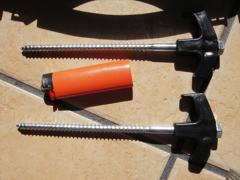

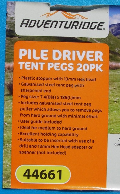

03_Troopy said
10:39 AM Mar 16, 2015
Bought these at Aldi a while back for around $10.00. There are 20 in a pack. Only 185mm long, but look OK for firm ground. Note the peg puller is useless and unnecessary for them though.
You can see how I put this together. Mudguard Washer with a hole drilled at the edge for a split link of chain to pass through. Blob of weld on the screw shank to retain the washer in place. The washer is free on the shank not welded. This is a 150mm Coach Screw.

Hi Ellie & Mike/Mike & Ellie,
I also use mudguard washers but have them loose with a loop of the trace spring threaded through the holes. (See the photo in 'easy in,easy out'). So far I haven't seen any reason to have the washers welded on as the screws go into the ground through the hole without any problems.
How do you keep the chain links from spinning when you are driving the screws into the ground with the washer welded on? Or connect up the trace spring?

The washer is free on the shank. The button/dab of weld stops it falling off the screw and being lost.
