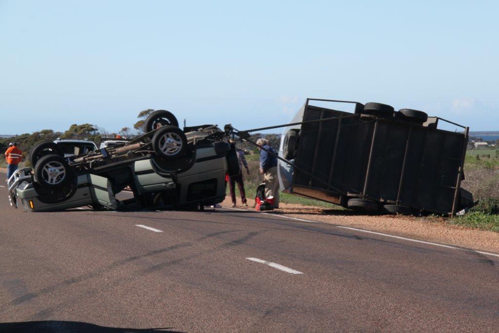

Well there you go, a different devotee here. After my trailer went into hopeless weave in July 2013, on Eyre Peninsula and flipped my Land Rover Discovery 2 so it landed on its roof, the mechanic at the scene after my car was righted, asked me if I always greased my towball and if so why?........said I had for years....he shook his head and said there is not only no need to grease it, it can create problems rather than leaving the ball completely dry.....they had to undo the ball because it was still attached to the upturned trailer and I had no idea where my locking hitch key had finished up as my stuff was strewn all over the road....I asked if the greased towball had contributed without really wanting to know if it did..insurance wise and I was about to make a claim...he said you would have been better off by not greasing it...<we left it at that but I was still not satisfied>.

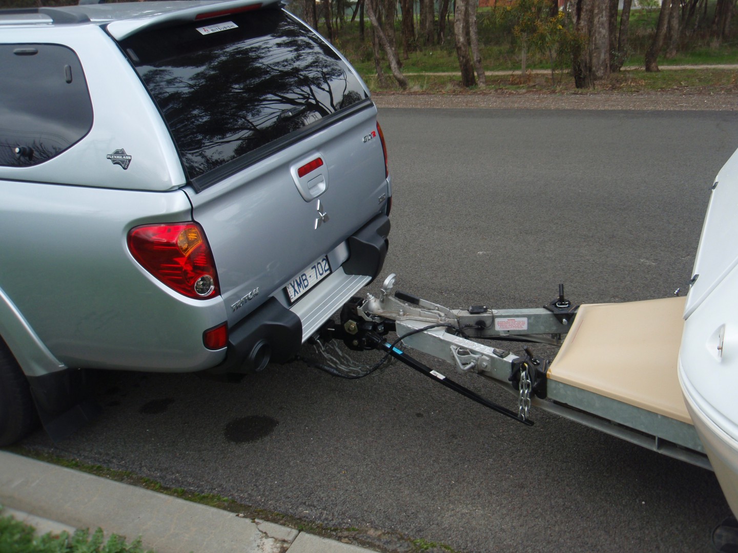

When I was having my new Hayman Reece Stabiliser, hitch and tow ball etc etc fitted to my new/replacement Mitsubishi Triton by the Manager at TJM Bendigo I asked him if I had been given 'bum' advice by that mechanic....re never greasing the towball.....he said it was absolutely correct..there was no need whatsoever to grease the towball and it was an urban myth built up by the tennis ball protector crowd through the years......I asked what he based his opinion on, and he said he had owned the business for many years and he was originally a major towbar/hitch etc manufacturer and fitter in Bendigo for many many years before taking on the TJM franchise as well.......he had never greased a towball not even his own and he was an active Caravan man and said he never will.......appears there are two sides to this argument besides perhaps the practice done simply because Dad./Friends did it.... I must say its as clean as a whistle when I remove the caravan,.... and..more importantly I no longer suffer the frustration of the car rising with my Van Jockey wheel as I wind it up to make the '/separationbreak'....it now comes straight off almost immediately.......until I hear a conclusive reason why I should grease it, I no longer do/will......Hoo Roo

You're not telling us that a little bit of grease caused your Land Rover to turn it toes to the sky. Nothing to do with the trailer you were towing which looks to have a fair bit of over hang

No Snail I'm not suggesting the grease flipped my Land Rover...re-read my post if you missed my point....they suggested I should not grease my tow ball.....
