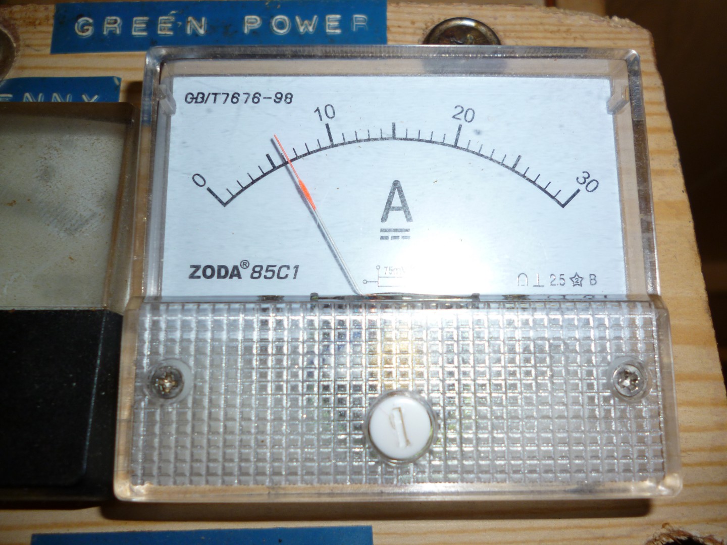

Pic taken at 10.20 am of my amps off my 200 watter panel Sa time. Will take another pic at midday, and another pic at 2 pm. Pic was taken sunday 13 th april 2014 :)
-- Edited by graham (chickenman) on Sunday 13th of April 2014 11:10:00 AM
-- Edited by graham (chickenman) on Sunday 13th of April 2014 11:23:21 AM
What was the sunshine situation at the time there Graham? overcast or clear skies?
graham (chickenman) said
08:07 AM Apr 14, 2014
Troppey, clear sky here but I think coming into winter we don't get the full rays off the sun? Last week I had just over 10 amps at midday.

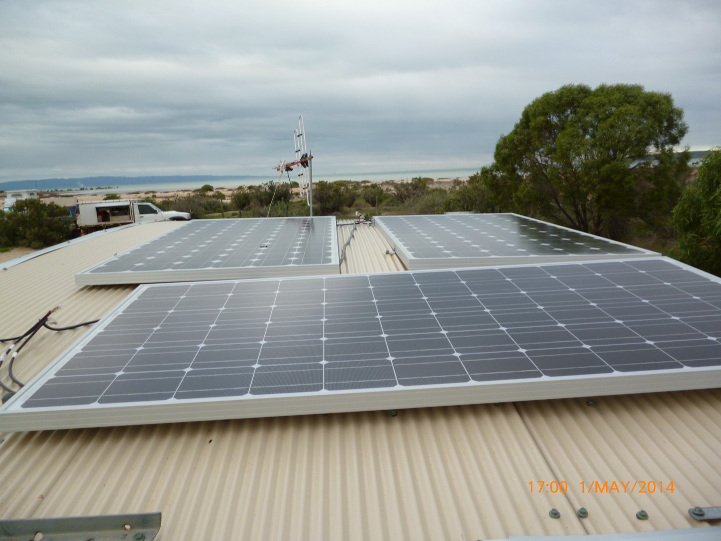

Puff puff just put my 3 rd 200 watter panel up -600 watts in all, time now for a scotch n cola with ice
When it clears up here in about 5 days I be pumping in app 22 to 28 amps a a hour I guess, maybe more when its towards summer.
Will put a pic up tomorrow after bracing them all down to be secure.

My 3 rd 200 watter panel be arriving by Toll in Whyalla tomorrow Thursday, hasn't been much sun here for app 4 days now, do need my 2 kva inverter genny to put some charge in my bank of batteries
Looking at forecast in my area looks overcast for maybe the next 5 days or so, so it be another 20 litres of fuel for the genny tomorrow:(
Nice Bright skies with high light streamers of cloud make for some of the best conditions, the high clouds help to reflect the sun back down from bounce..
Juergen
yes snow can bounce that amp meter around a extra 4 to 6 amps, oh overcast again to day
Pic taken 4pm cst 1/05/2014 n/e of Whyalla.
