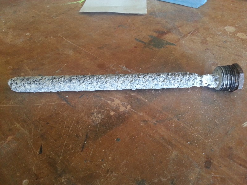

Delta18 said
01:42 PM Mar 24, 2014
Thanks for putting this post up, I had thought of looking at my Anode but as the van is only almost 4 months old I have been putting it off.
Reading this I got thinking that although I bought the van from yard stock in late November2013, the HWS was probably commissioned in perhaps June last year.
Anyway, got the breaker bar & 1 1/16 socket and removed it without difficulty.
On inspection, the anode was still pretty close to full length but had eroded to become rather thin right at the nut end. Rather than risk it breaking off there & falling into the bottom of the tank I replaced it with the spare that I had bought with the van.
Was I too hasty do you think or should I have tried for another 4 - 6 months out of it.
You could have put it back as it still has a lot of life left in it, it has a stainless core that stops it from breaking off, I changed one a few weeks ago for a friend that only had the stainless core left..
Delta18 said
02:17 PM Mar 24, 2014
Thanks Bob, I wasn't aware of the reinforcing rod, figured the whole thing was zinc or whatever.
I won't ditch it then, in the spares bin it goes.
brian said
03:07 PM Mar 24, 2014
The core wire is generally not stainless, just plain steel.
The anode is normally Magnesium, sometimes Aluminium ones are used, but better to stick to Mg for maximum protection. Zinc is generally only for marine applications
Make sure that you thoroughly clean the majority of the oxidation off the rod (in the pits as well) if you are going to use it again. T

oldtrack123 said
04:20 PM Mar 24, 2014
HI Delta
THe Type to use can depend on the water quailty
Magnesium is the best, BUT
Magnesium will have a very short life if used with highly mineralised water
Aluminium is often used in that situation, BUT some find the water has an odour
Of course like ALL hot water systems it is inadvisable to drink the water
You will find they general loss material close to the thread first , this is to be expected as the small area of non lined steel of the tank & inlet socket are reacting
THAT area can become quite bare, but is ok, as long as solid Magnesium is left on the remainder
PeterQ

oldbobsbus said
04:23 PM Mar 24, 2014
brian wrote:
Whatever brian without a capital B, I'm not sure it really matters if it is stainless or just plain steel as you put it, it is there to stop the anode from breaking away from the nut..

oldtrack123 said

Hi Bob
I have seen BOTH, Stainless & plain carbon steel.
But you are correct THAT is a MINOR detail compared to some of the wrong statements often made!

brian said
06:16 PM Mar 24, 2014
oldtrack123 wrote:
Hi Bob
PeterQ
Come on Peter, have you really seen Suburban hot water service anodes with stainless steel cores?
We were discussing Suburban anodes here, but I seriously doubt that you would ever see a stainless cored one for any hot water tank.
Who makes them?
Who sells them?
We both know that manufacturers will not spend money that they don't need to.
What possible gain could be had by using a stainless inner core?
Firstly, the core is not in contact with the water other than at the very ends, so corrosion could only occur there.
Secondly, the core would be totally protected against corrosion by the anode anyway, so there is absolutely no reason to use stainless steel.
Thirdly, Stainless steel suffers from crevice and pitting corrosion which is not protected by the anode, so there is a distinct possibility of a stainless core failing where it meets the nut.
Fourthly, it costs more to produce.
